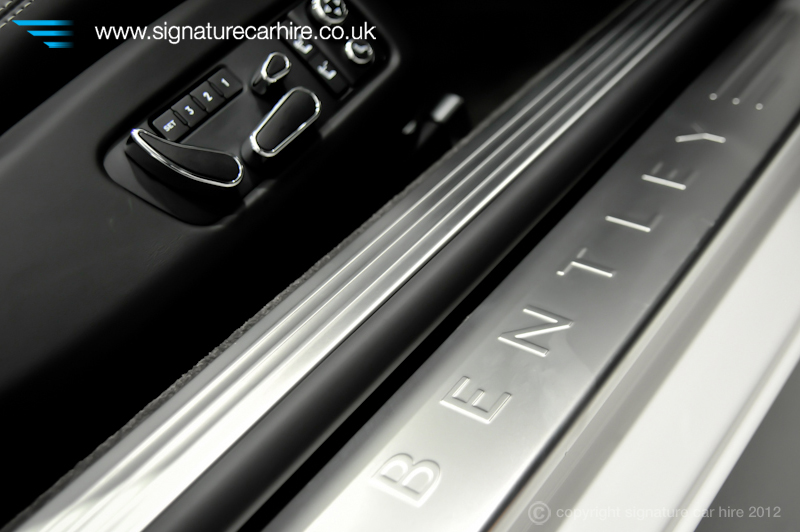

Hey guys,
I'm looking to remove the door sills from my GT so I can get them chrome plated, anyone done the task of removing them before?
Thanks,
G

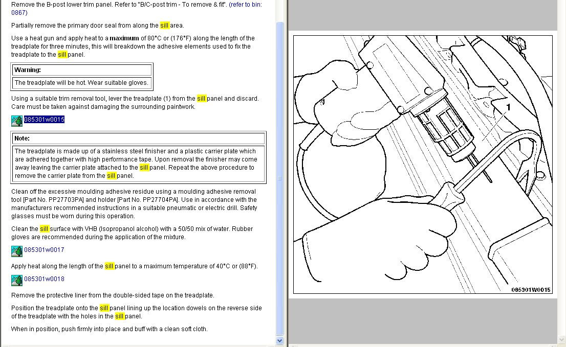

Here is the relevant information for the inner treadplate (from the IETIS service manual). The outer treadplates are glued down. The second diagram provides the instructions.
ID:	318046   Click image for larger version

Typically, whichever one(s) you remove you end up having to replace. I have yet to see one be removed & remain in reusable condition.

AE86, what do you mean by them become unusable, do they become deformed/elements snapped off?

Sorry, i should have clarified. Yes, by unusable I mean cosmetically they get dented / warped etc... Technically usable but not pretty to look at anymore.

I see, do you think it's possible that with a bit of care, that it can be removed without warping?
