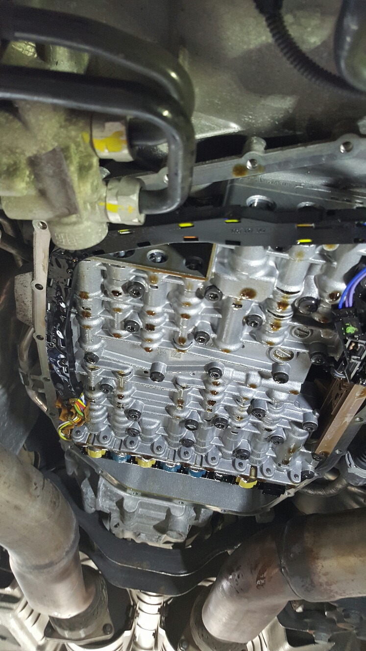

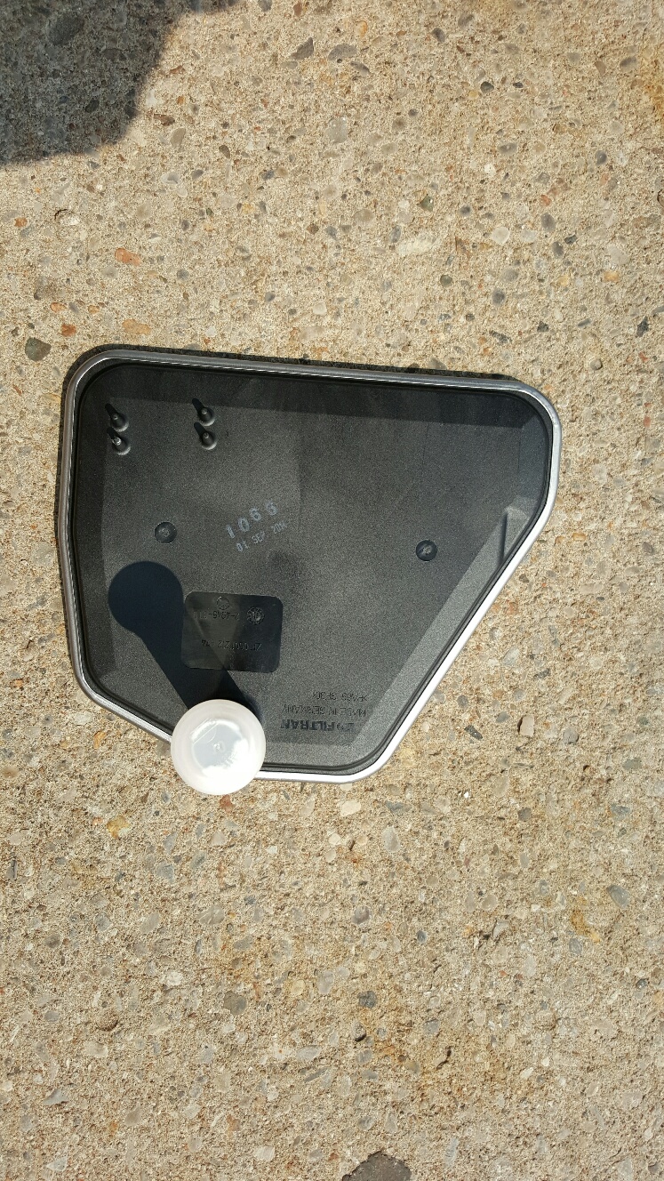

Here are some pics showing the filter, the fluid and the transmission without the pan.
