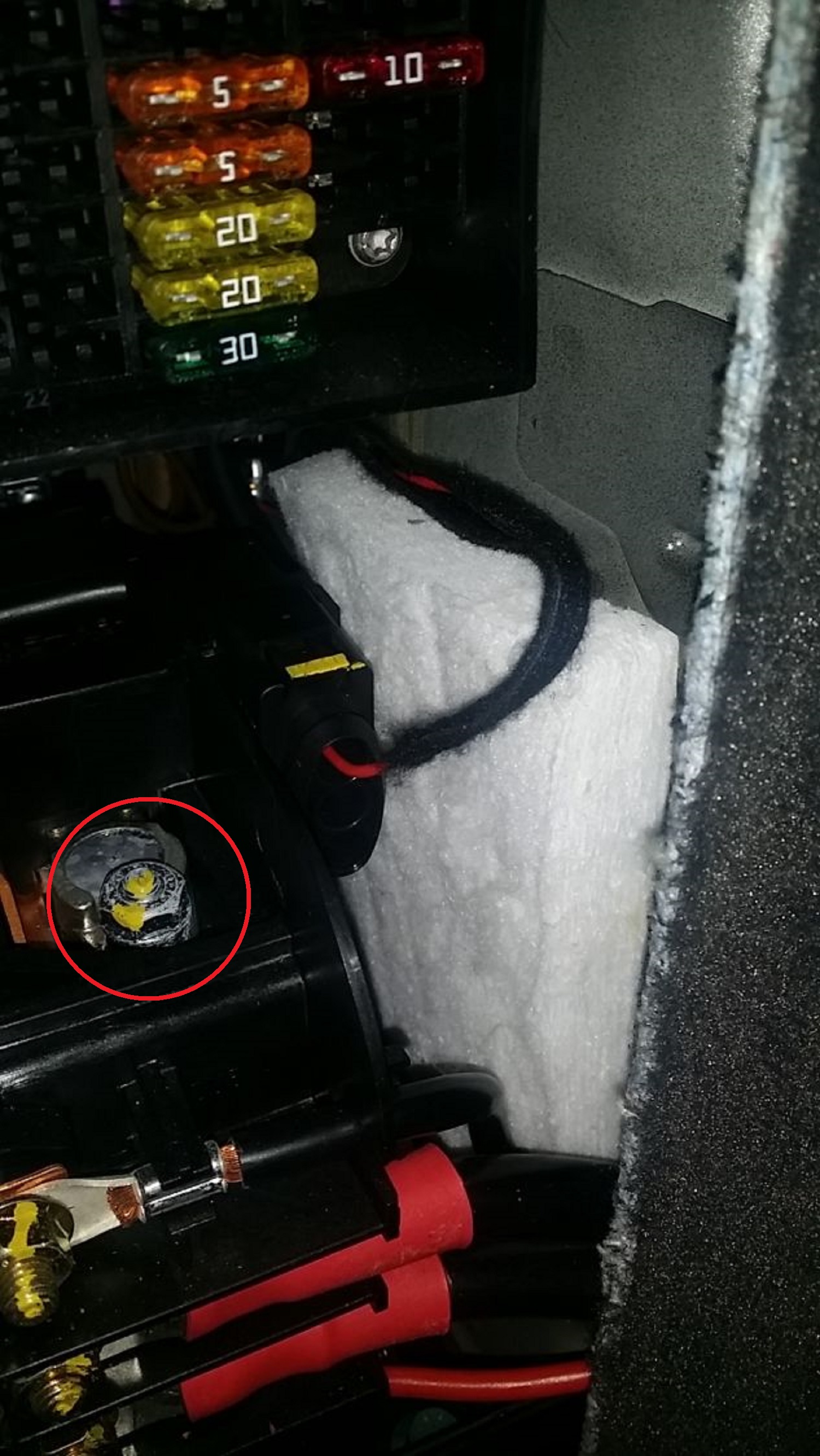

Hello Jim,
Did you loosen the positive terminal nut first, as the positive terminal comes off with that whole group of cables.

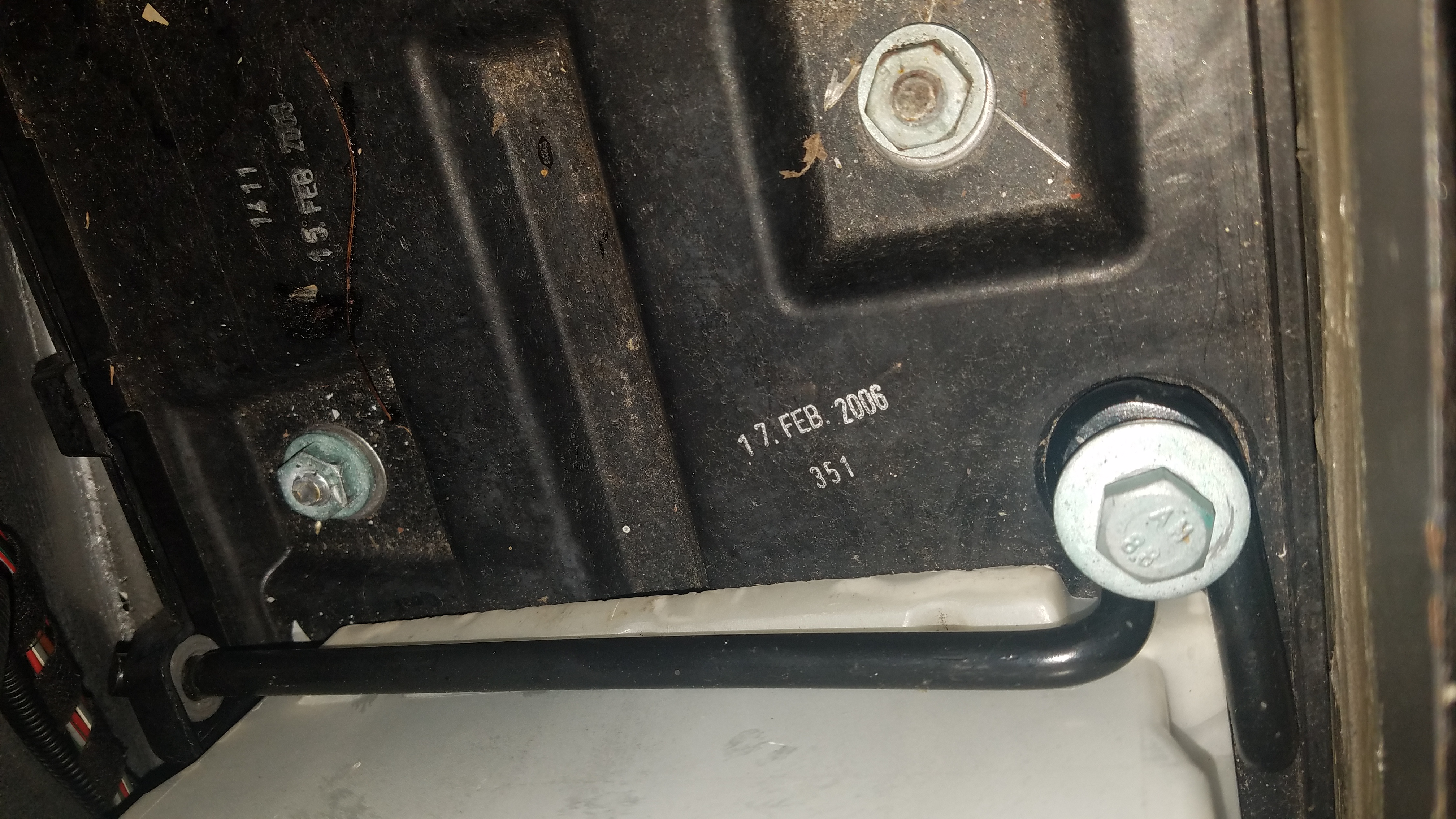

Hello Jim,
I saw your post in the other battery thread, although this is a picture of the starter battery on the right hand side, it is the same type of hold down for the main battery on the driver side.

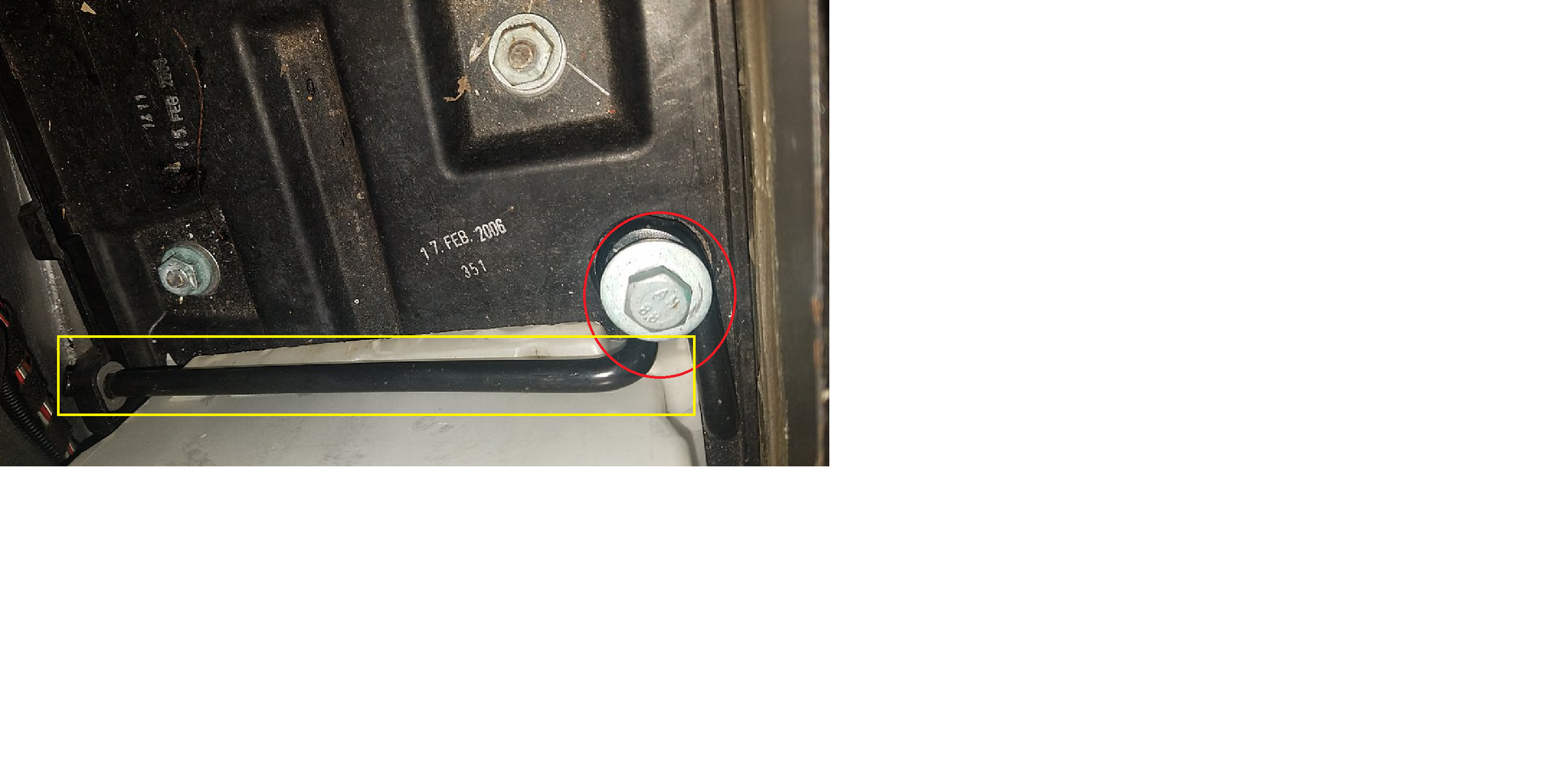

The battery hold down is as shown in my previous picture, I have taken that picture and circled the hold down bolt in red, and the hold down rod in yellow, being that you are working on the main left hand battery, the hold down rod will be toward the front of the vehicle, so on the backseat side of the battery, not the taillight side, as far as the unplugging of the red wire, you push in the plug, while pushing in, you push down the tab on the top of said plug and pull out toward yourself.

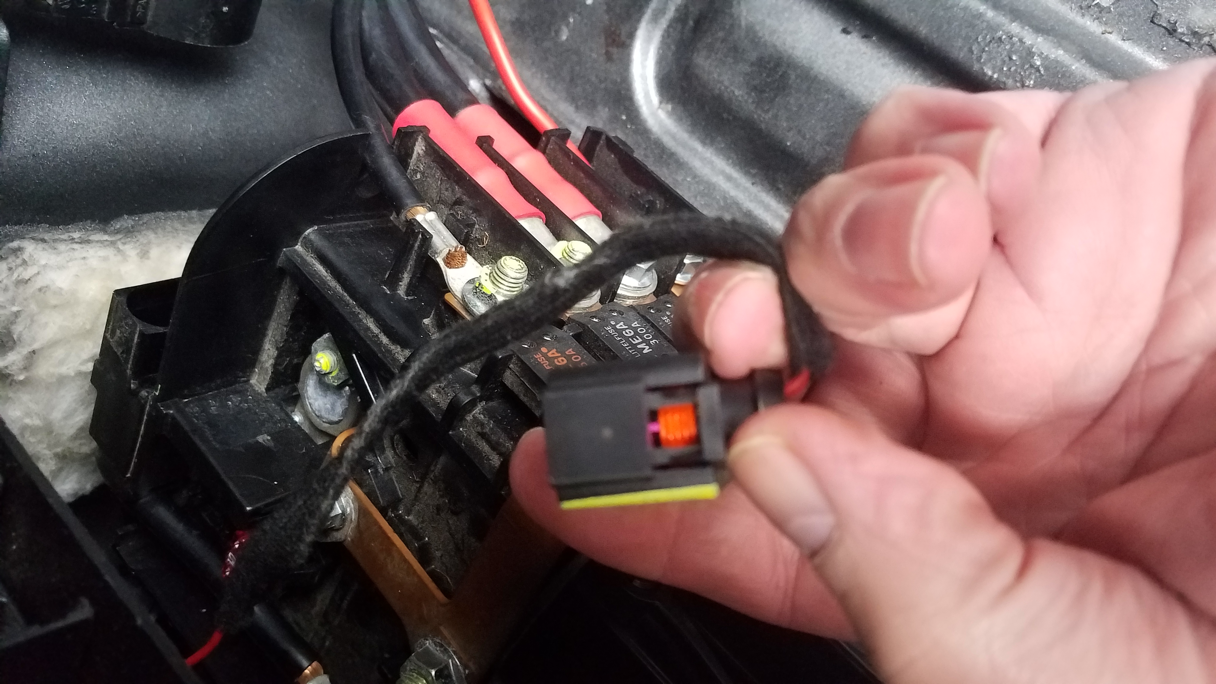

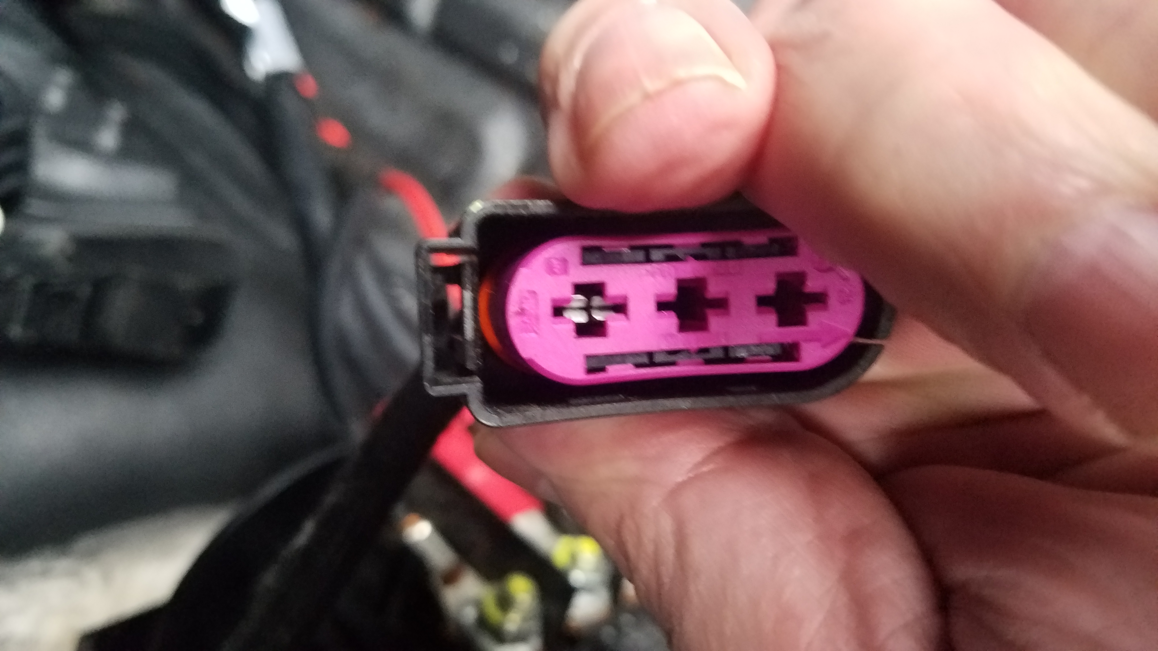

Pics of plug tab/clip.

to get it out of way you have to disconnect the "quick" release plug....Johnny has been so helpful with the exact picture...except mine does not seem to have any give at all...after working on it for 30 minutes, thought I would give it a rest before I cut the damn 2 wires....JimB
Hello Jim,
Be sure to push it in good before pressing down on the black tab and pull out, I myself forget to push it first sometimes, if you don't it will never let the clip off of its lock so to speak.
