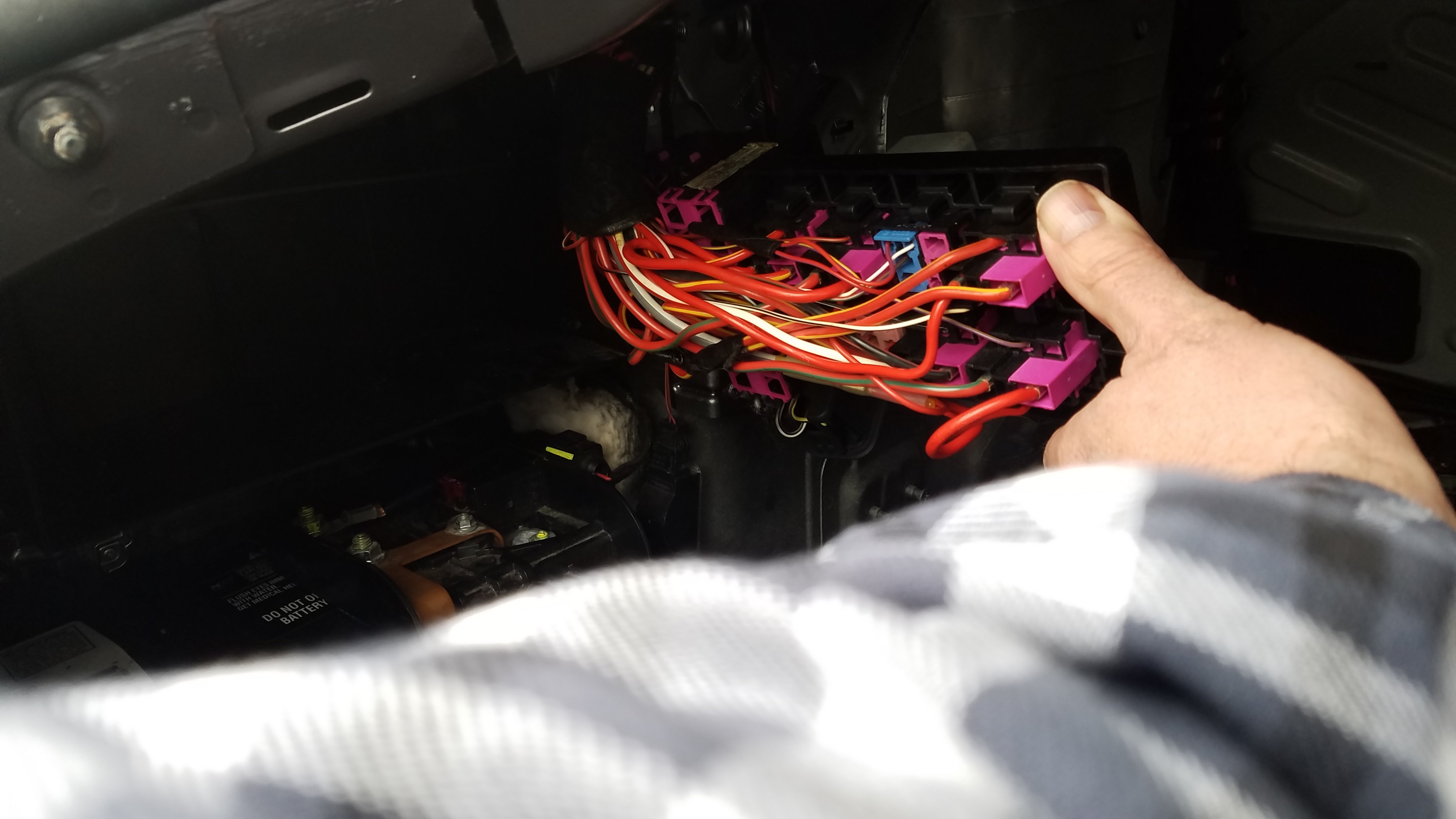

....damit Johnny, just when I think I'm out, you pull me back in...OK since our new President is making everything great again...I'll give it another try....Off with the fuse/relay panel...

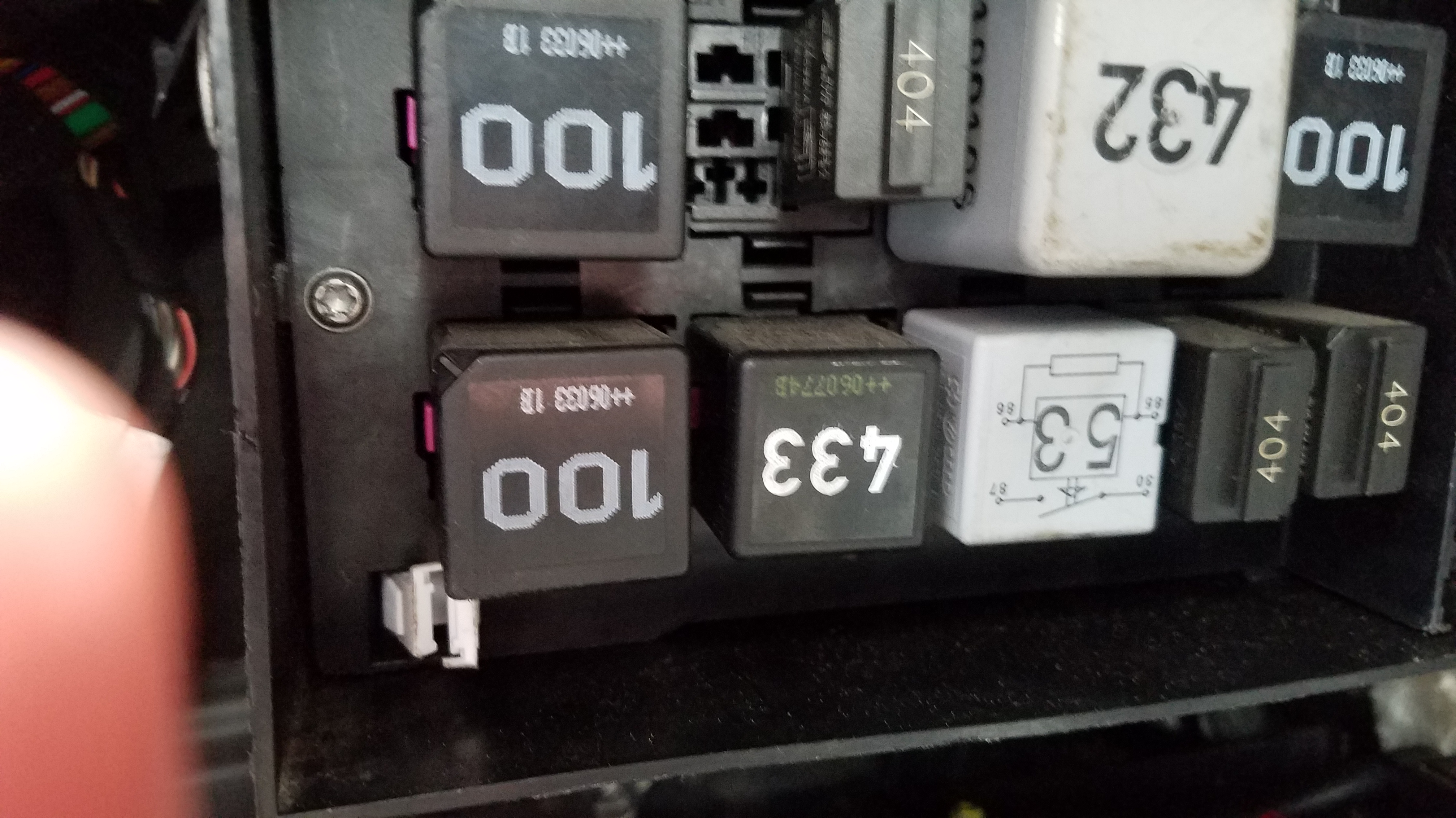

another question....do you know what the relay in picture #432 controls...the reason I ask is that mine show a little anomaly right in the center of the number 3...in your picture you have the same anomaly...just curious JimB Oh, how do I find your project on the Site...what is the title...

another question....do you know what the relay in picture #432 controls...the reason I ask is that mine show a little anomaly right in the center of the number 3...in your picture you have the same anomaly...just curious JimB . Relay with #432 on it is relay #49 and is the Battery management relay #2. see attachment below and see pages 1-21 and 1-23 for relay layout, it may differ for your year, but I don't think so.

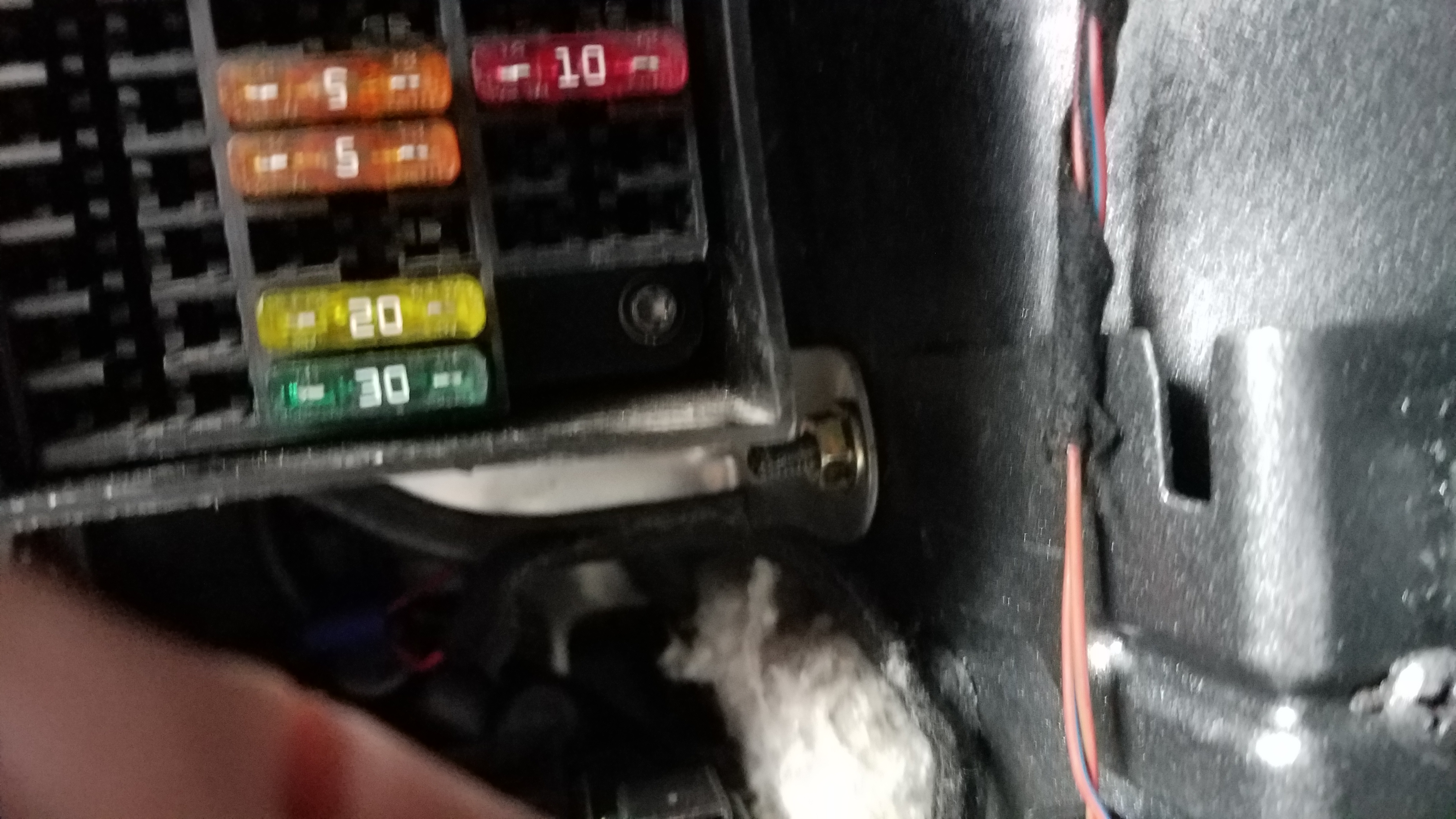

...time was I could work at these little projects all nite...that was then this is now...for those out there going to try to r/r the left Main battery...on my 2010 Speed, you must detach the fuse/relay panel and box mounted above battery...unless you can levitate the 60 pound battery...a little added challenge is trying to get this done working half in dark, with no electric in a 100 car garage, with half of your tools...all good...could not possible get done without Johnny's excellent assistance...OK back to finding last 2 bolts holding box...JimB

....Johnny...the last time I saw the 2 nuts you spoke of...I am working with a flashlight and a mirror....an hour ago I clearly saw them...now again having difficulty finding them...can you give me a frame of reference as to location...ie...relative to the black plastic box or the one nut on bracket that is easy...

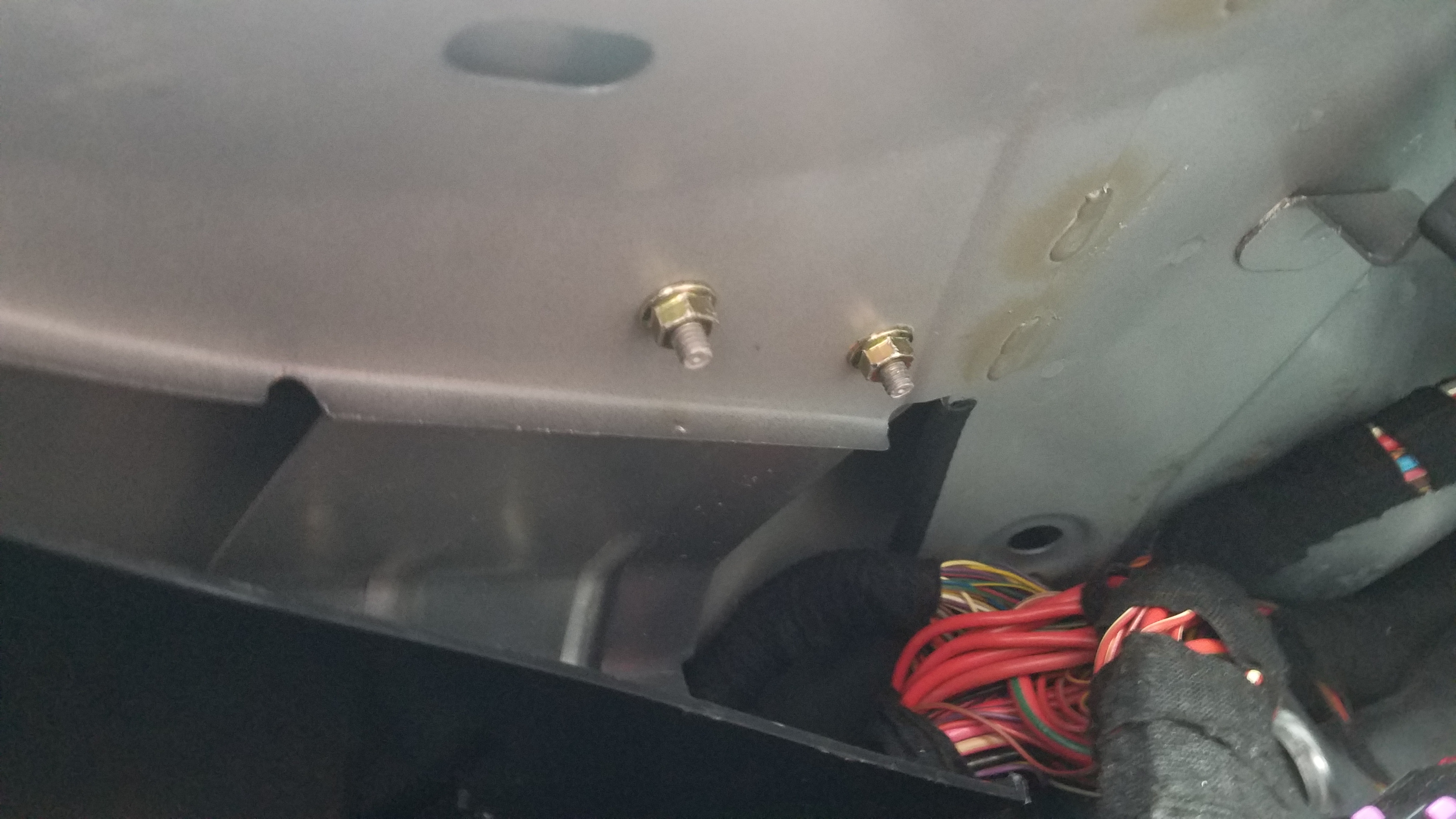

....this is definitely a learning process...I have spent at least 2 hours trying to find the 2 nuts that secure the black plastic box that holds the fuses/relays (there is total of 3 10mm nuts. The reason it took me so long is I was looking for the 2 in the wrong area. I was looking for the nuts behind the box, they are actually in front of box at top. All 3 are now out. Still the box will not come out. The box is held in by a plastic anchor that secures the wire loom going into taillight area...Johnny...what is best method of releasing the wire anchor...JimB

That box comes in two parts. The box and the aluminum mounting bracket. The two pieces snap together with 3 slide latches on the back and one on each side. There are two protruding bolts on rear of the aluminum bracket that are attach points for wire harness anchor points. I have tried remounting the assembly as one piece and the bracket first and then snapping in the box....both ways are fighting me....try again later...any suggestion are appreciated...JimB
....to share my experience in r/r the main (left) battery. As previously said, on my 2010 Speed you must remove the fuse/relay black box to get clearance to r/r battery. Getting it back on (box) is a challenge. Just got it done (after a few trys and losing one of the 3 ten mm nuts) I tried both ways. Mounting the bracket only then adding box was no go. What did work was mounting box on alum bracket and installing. Getting the 2 10mm threaded bolts to seat in their proper place a challenge but finally got done.

....made bush league mistake...so focused on getting the black plastic fuse/relay box reinstalled did not notice the fuse panel will not clear with box installed...so out with box again, install panel and reinstall box...live and learn...JimB
....Johnny....help needed....what is right sequence for removing fuse panel, black box and aluminum mount bracket for black box...
