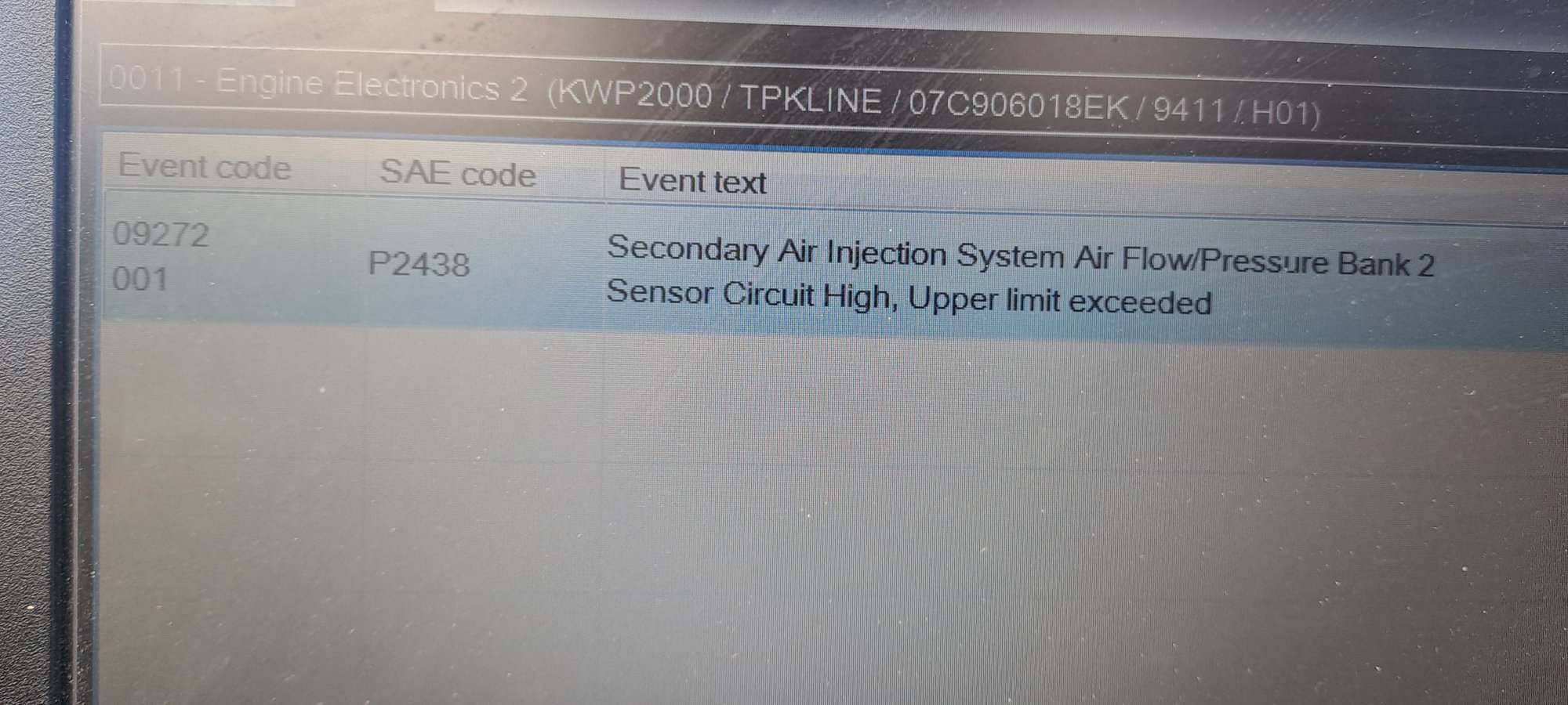

hi i am getting a check engine light
its a p2438 air injection system air flow pressure
what is the problem please someone help thanks

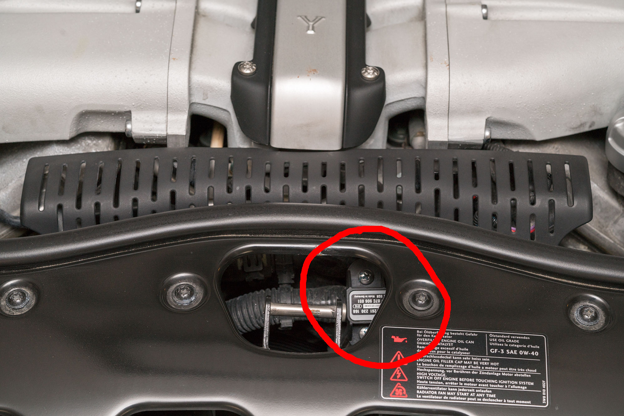

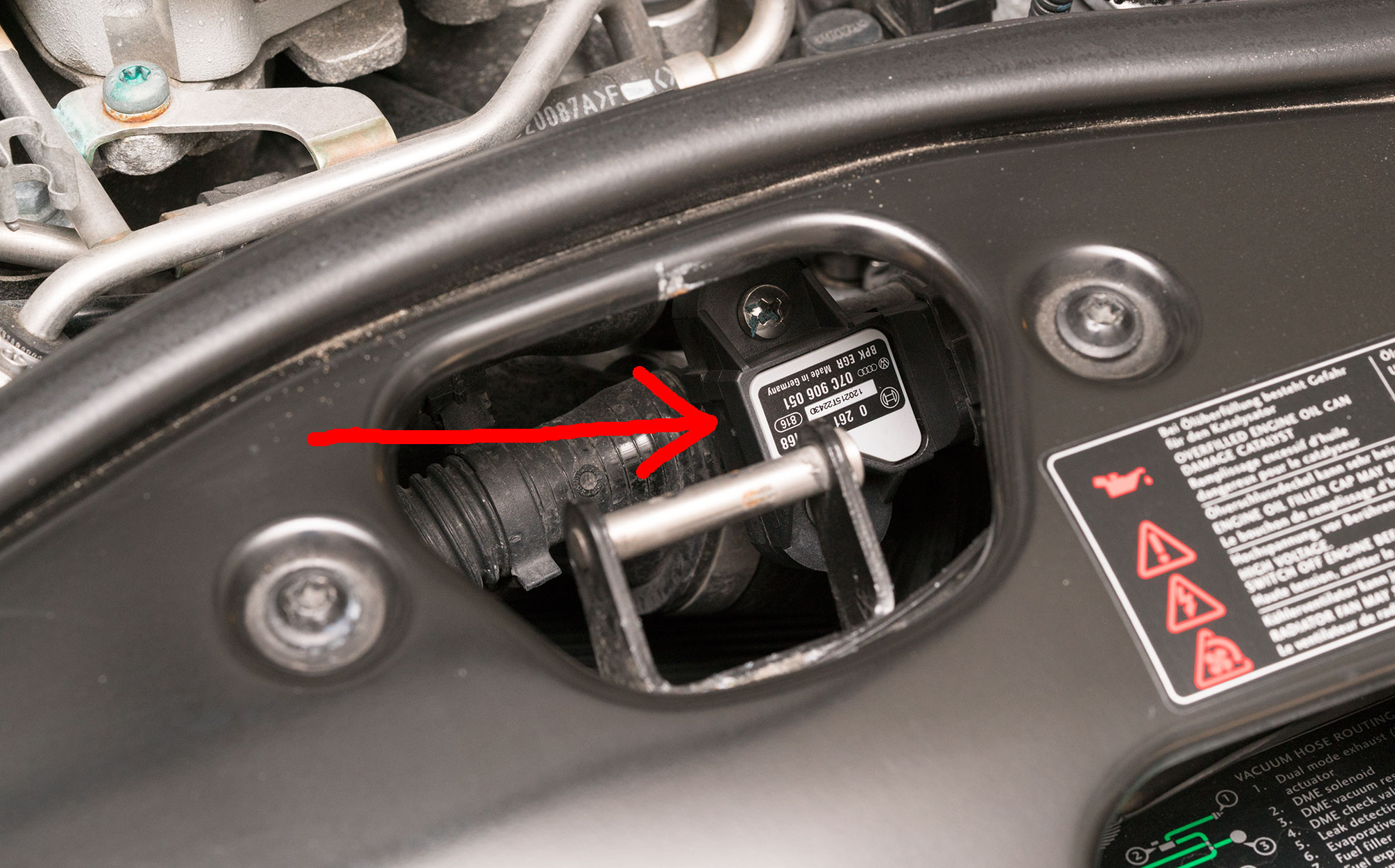

Hmmm, is this the cold engine startup error? You know, during the first 60 seconds. If so, that's an easy $60 DIY fix. Let me know guys and I can take pics. My error code log is incomplete as was moving, yet part # is 07C906051.
Old Mar 4, 2016 | 01:32 PM
stevenrmusic's Avatar
Joined: Apr 2010
Posts: 2,730
From: Worldwide
Rep Power: 147
stevenrmusic has a reputation beyond reputestevenrmusic has a reputation beyond reputestevenrmusic has a reputation beyond reputestevenrmusic has a reputation beyond reputestevenrmusic has a reputation beyond reputestevenrmusic has a reputation beyond reputestevenrmusic has a reputation beyond reputestevenrmusic has a reputation beyond reputestevenrmusic has a reputation beyond reputestevenrmusic has a reputation beyond reputestevenrmusic has a reputation beyond repute
Found my log, YES it is the part above. Lemme take some pics. BRB.
Ok, the procedure is as follows.
Open hood
Remove the plastic small black cover by pulling it towards the front of the car. This gives you working room.
Remove the two stock black ALLEN bolts (one top, one bottom). FYI: Stupid me dropped one during reinstallation so I used Phillips when reinstalling. It is a bit tight to get access to the lower bolt yet very doable and not really that hard.
Swap defective old for new part.
Reinstall screws HOPING to not have one drop onto the black hole of the car's lower aero (I used Blu-Tack as you can see on the bolt head).
Reinstall small black plastic grill bit
Clear error code.
You're done.
BTW this circuit is only used during startup so no damage or symptom during normal operation is what I've been told.

I just got the P2433 code and MIL on. My RossTech says Bank 1 sensor is bad. I see the picture of the bank 2 sensor here. Does anyone know the location of the bank 1 sensor.? Hopefully it’s easy to reach...
Old Nov 15, 2020 | 03:12 PM
gregwarner's Avatar
Joined: Jan 2019
Posts: 31
From: Dundee, IL
gregwarner is infamous around these parts
Remove the facia... lots of t25 torx bolts.
Then remove right air intake. Push in toward the engine, twist it up and out.
There is the bank 1 secondary air pressure sensor.

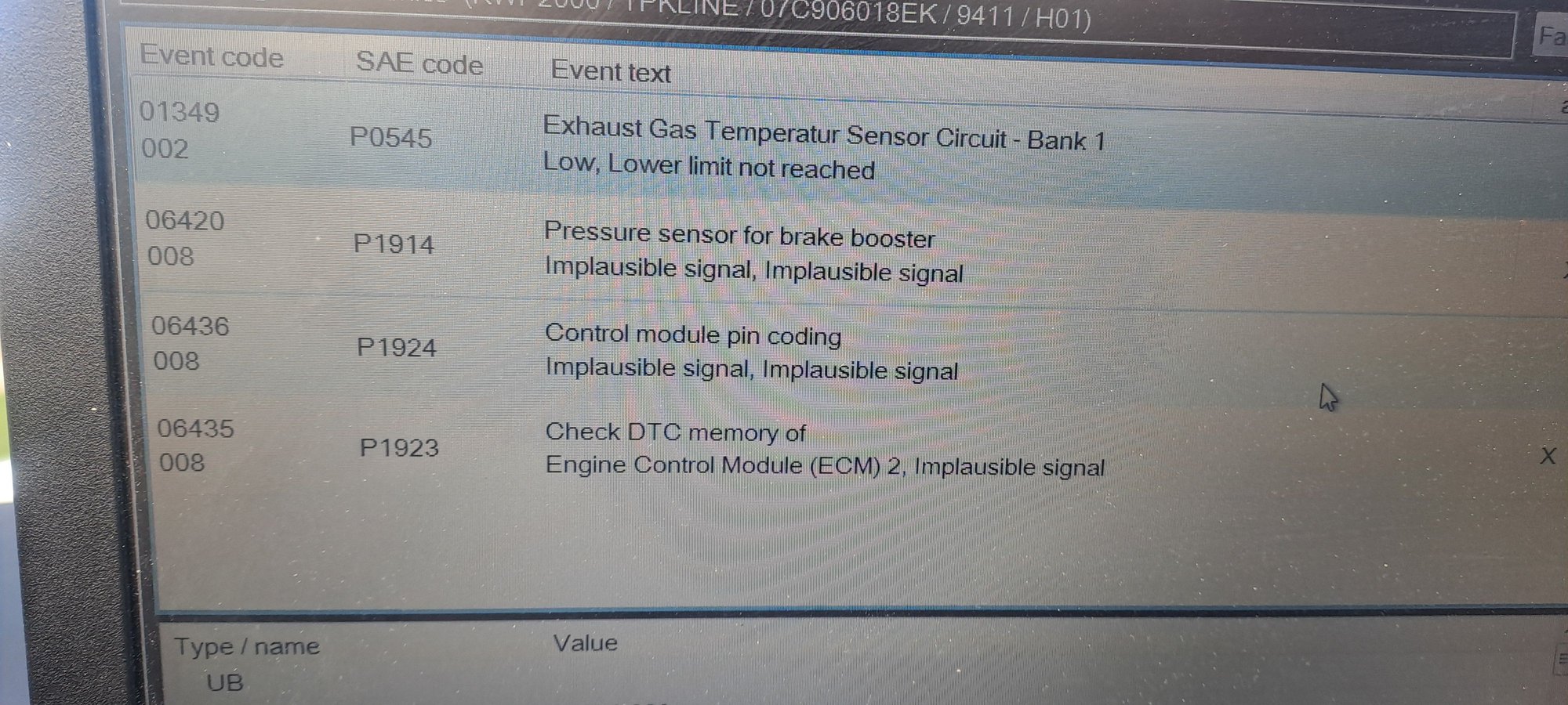

I have a leak as my brake booster motor in the left wheel arch runs but i dont know if its causing the secondary air injection fault

The secondary air pump is a 90 second positive air injection to expedite the heating of the catalysts. The system is activated when starting an ambiant temperature engine, [first start after not running for a while]. The vacuum booster is as the name states and is activated to assist various vacuum solenoids and the brake booster.

thank you for that but why is it got a fault. The car starts then idles at 500 rpm sounds horrible. The vacuum booster runs all the time when taking my foot off the pedal.

The vacuum pump running too often is diagnosed by preforming a smoke test. An online search "smoke test Bentley Continental" will reveal multiple YouTube videos. Probably a cracked line on the firewall behind the engine.
The secondary air pump issue is different and difficult to trouble solve from a far. This isn't related to the vacuum pump running alot...sorry to say.
I would concentrate on the vacuum pressure pressure issue first. This is a known prevailing issue. Eventually the vehicle will perform poorly if unchecked.
