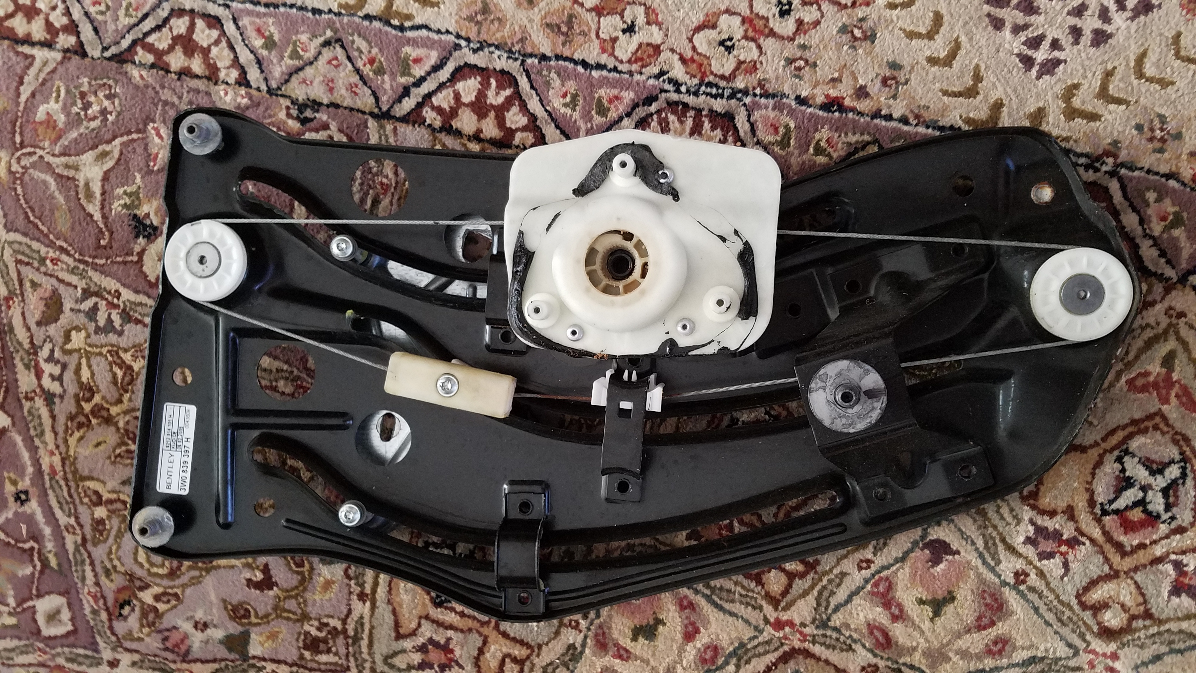

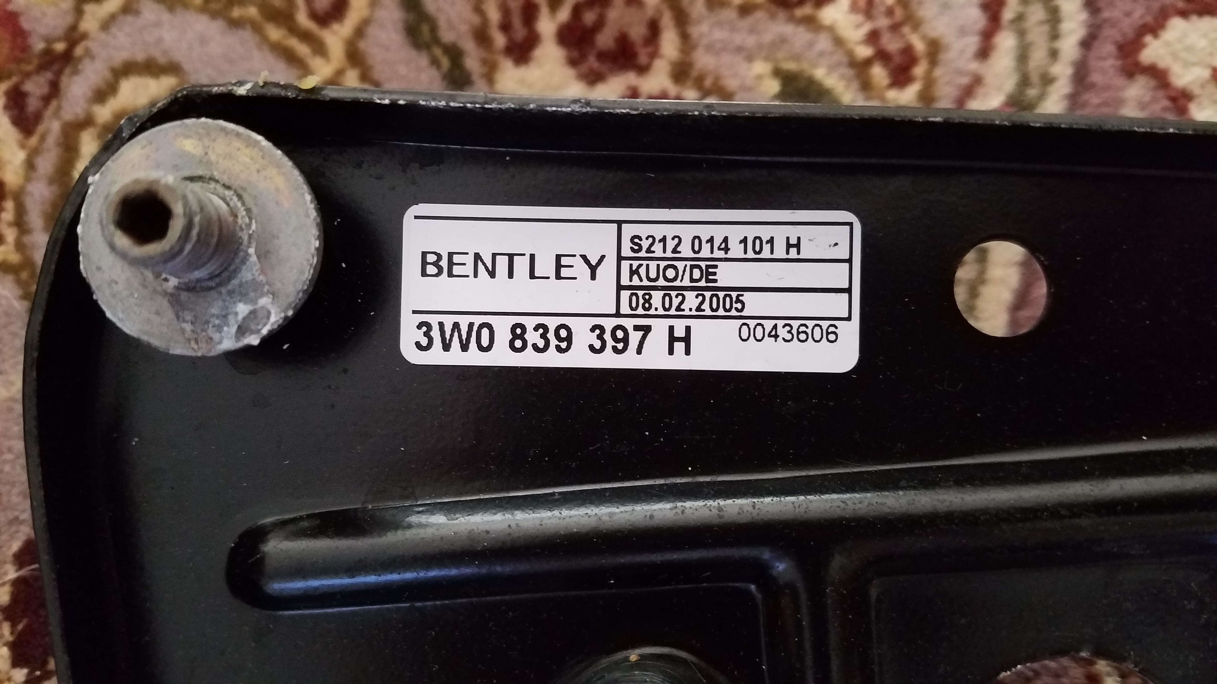

This is what you need, I have both left and right for the rear from an 05, Just an FYI, 04-05 share the same motor mounting, but in 06 the mount changed, so if you purchase a unit from an 06 or newer your window motor will not line up with the mounting holes, ask me how I know....
PM me if you want.
