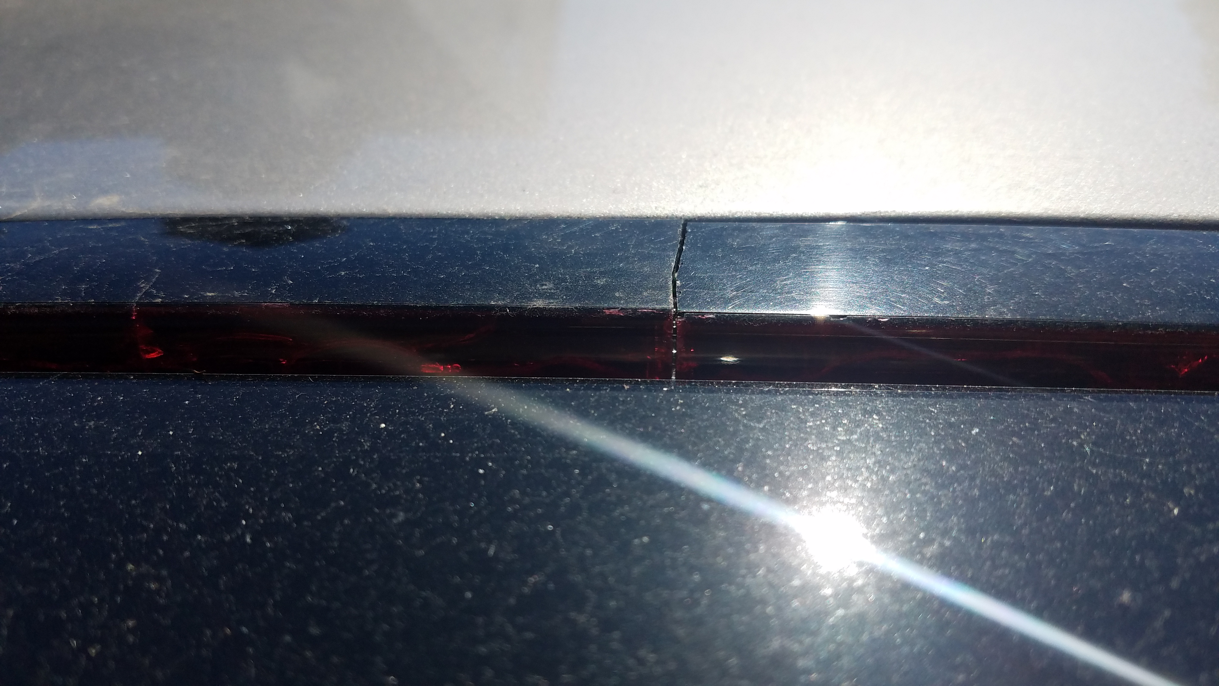

Let clear the air and get this one straight.
Lilo1980 has a GT, Cduluk1 has a Flying Spur, BentleyF has a Flying Spur, and I have a GT, SO as SWFLBT23 stated "The flying spur 3rd brake light is different. It is mounted in the car at the base of the rear windshield" SO the FS has the 3rd BL INSIDE the vehicle and therefore is NOT susceptible to rain unless the rear windshield is leaking, and even then I doubt that the rain would bother the light itself, but instead the connection, Cduluk1 stated for his FS "It got worse after we had several days of heavy rain." which is odd being as stated the light is inside the vehicle, I would check that you have no leakage cduluk1, otherwise it looks to be just coincidence with the rain, for the FS I would check the connection whether it be in the trunk or under the parcel shelf.
Now for the GT, this is what happens when it is subjected to the weather and cracks allowing water to infiltrate the light itself.
