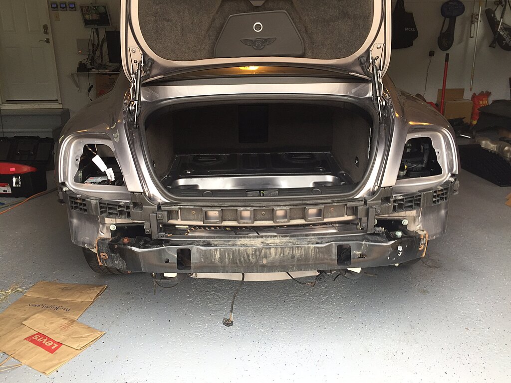

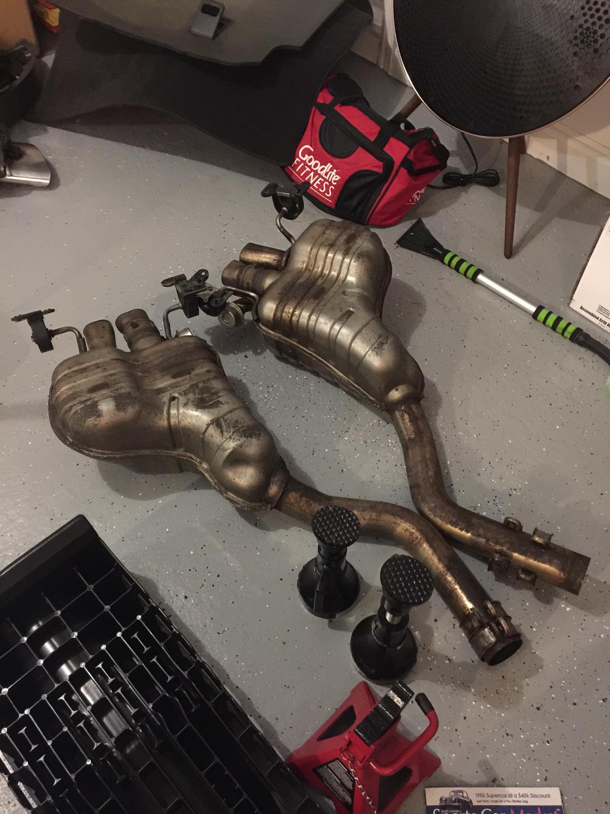

Both exhausts are off now. I'm going to hunt for some new nuts and bolts before I install my new exhausts. The old ones are somewhat rusty.
It was really easy to take off the exhaust once the rear bumper and exhaust tips are off.
The bumper retainer pin was also easy to take off once I figured out where it was. The diagram wasn't helpful at all. I'll try to make a detailed instruction with pictures when I'm about to put everything back.
