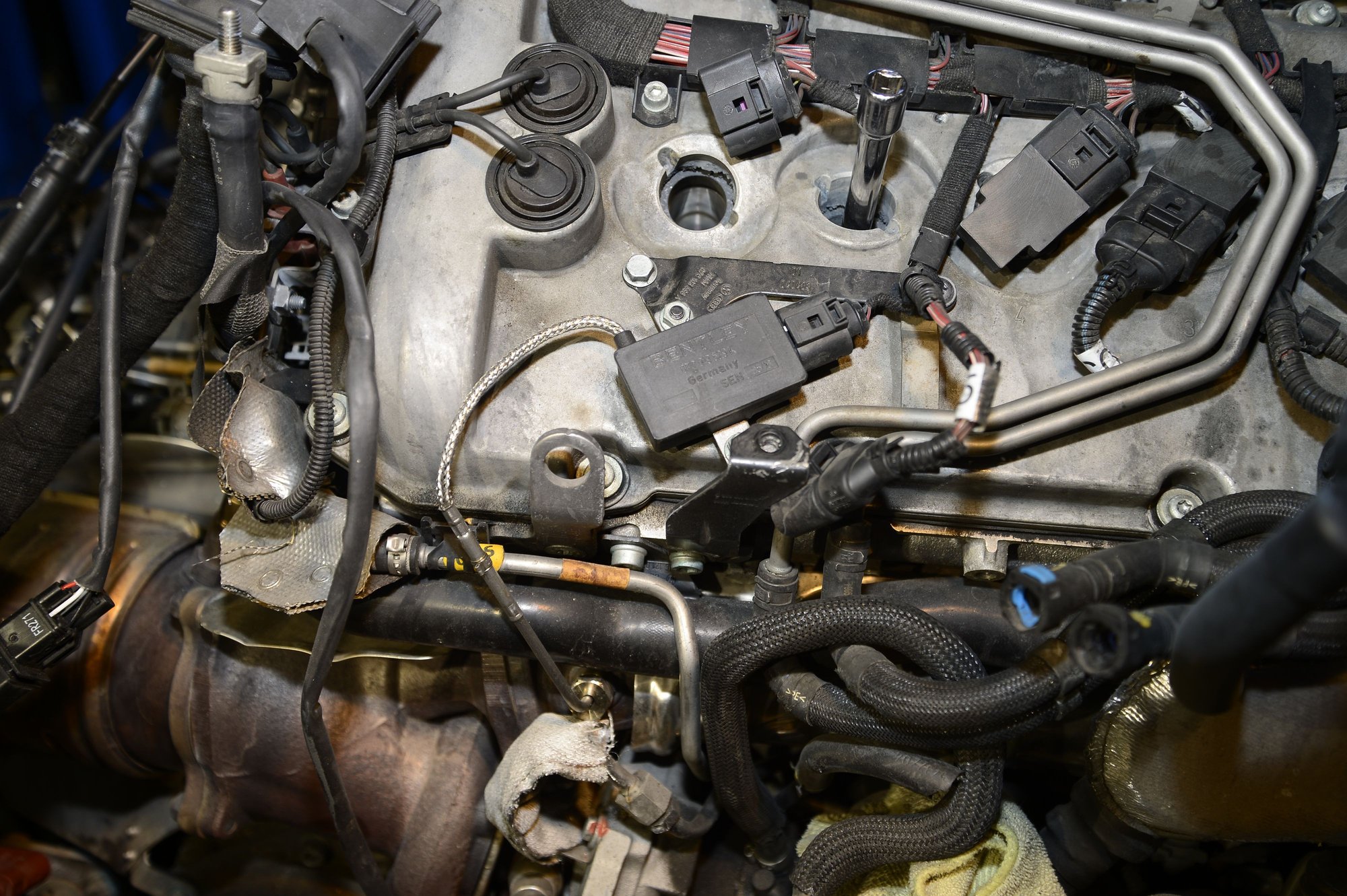

Here a picture of it. To remove the nut on the bottom, a special tool is needed. however, it can be done with standard tools. You just have to grind a slot is a wrench

Here is what the tool should look like to remove the sensor

....sorry to ask dumb question....is the EGT Sensor the brass looking nut below the orange tape...maybe it is angle of picture, but slot cut in tool doesn't look big enough to get around stem...I just want to be sure I am I.D. the correct nut...JimB
Hello Jim,
Yes that is the exhaust gas temperature sensor probe nut in red circle, you would slip the slot cut in the wrench over the wire section of the sensor in the green area.
