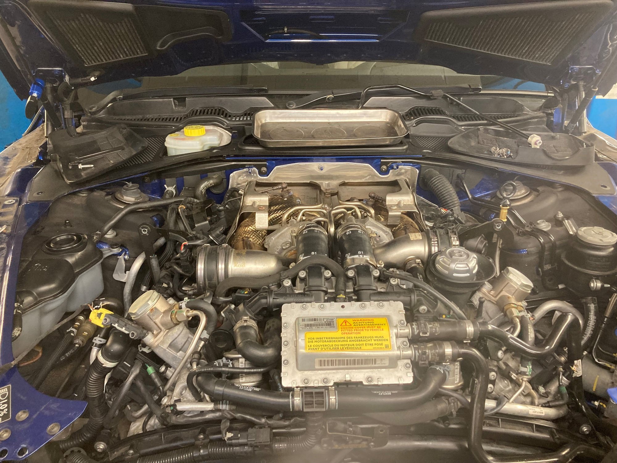

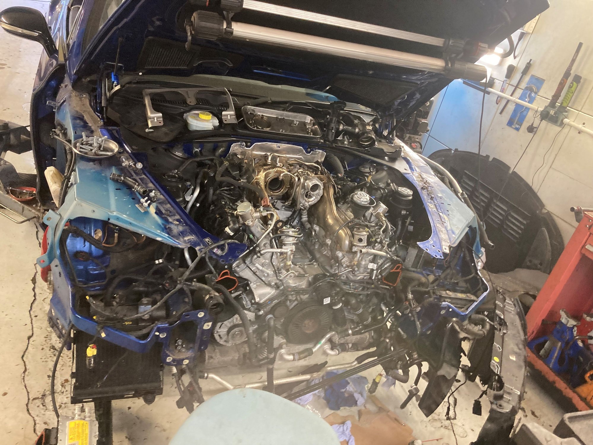

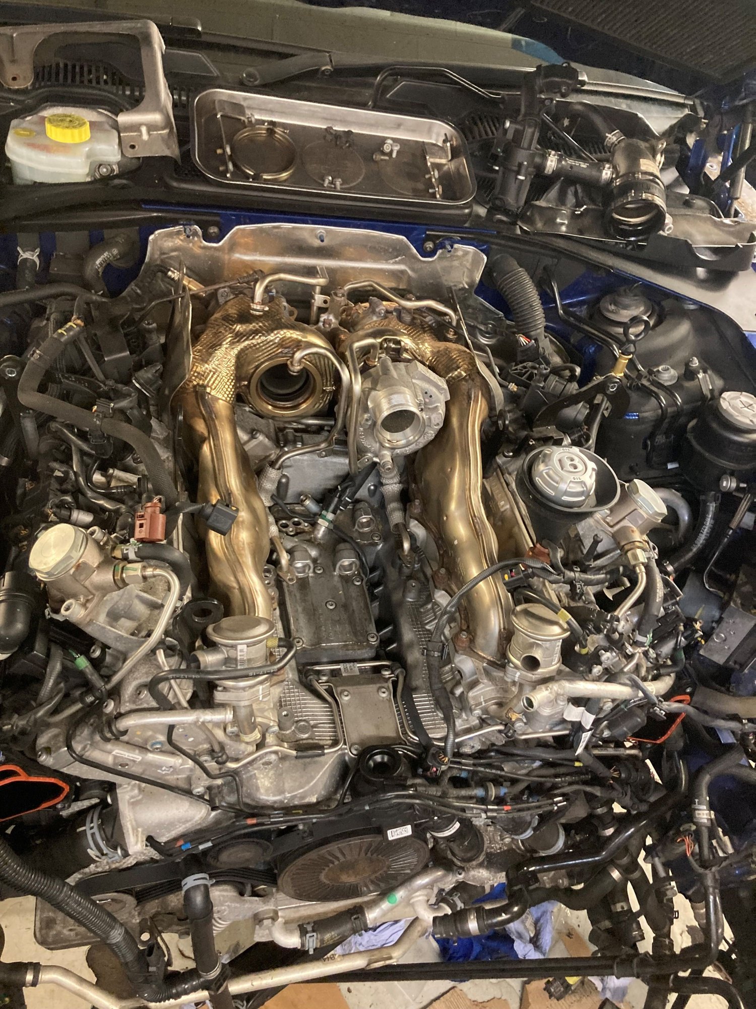

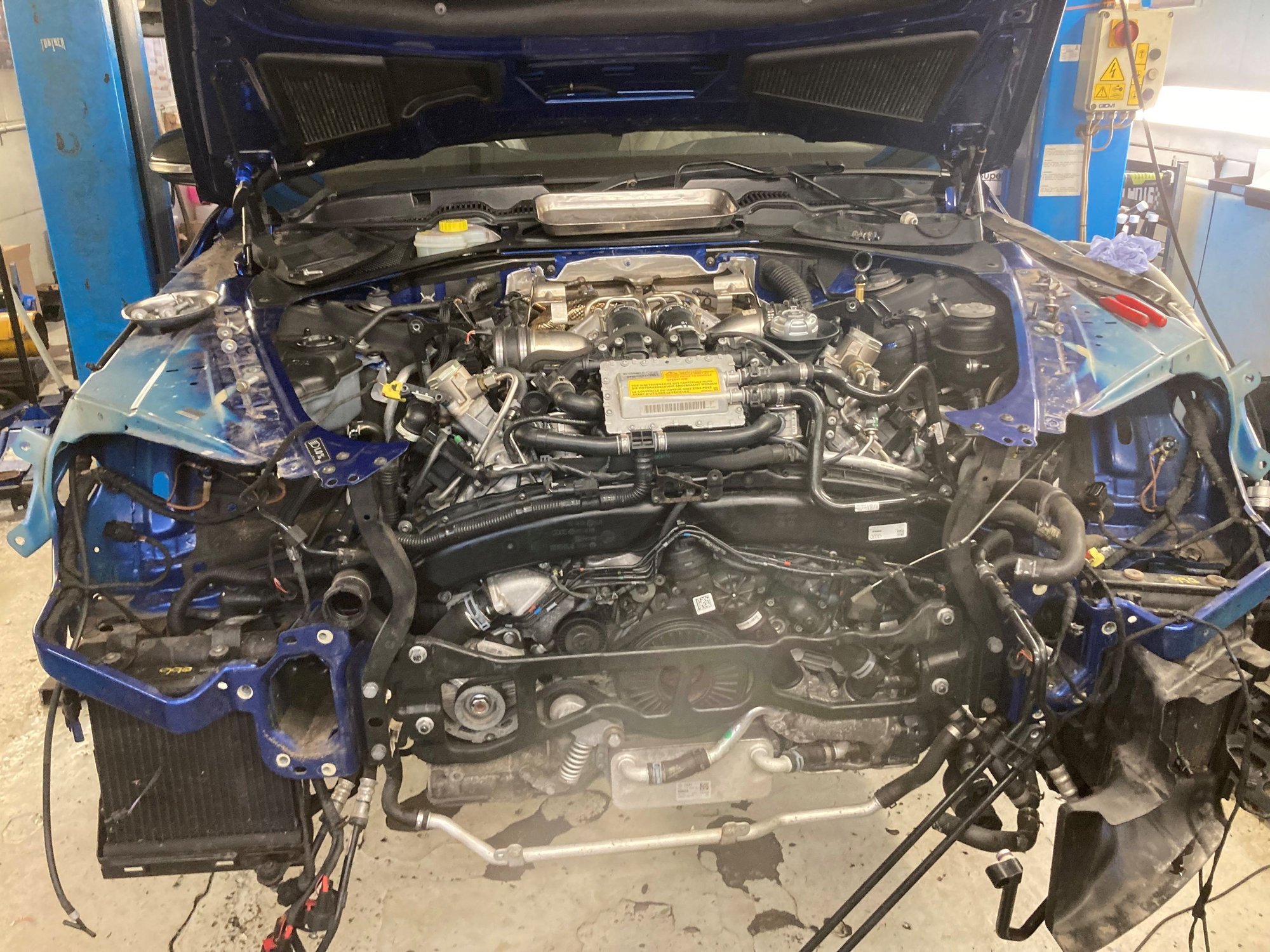

Hi All,
my Bentley V8S started to have a coolant leak only when fully cold after a drive. Read various FORUMS and found out that most probably was a seal just behind the radiators over the thermostat (part n. N90713203). Commos issue on AUDI S8s and S6s......Now, the seal costs 5 pounds but to get to it the car front had to be stripped. See photos........
While we were there we agreed with my mechanic that we should check turbos and change the oil strainer (AUDI had a recall on that part) change breather and PCV valve.....
Found oil in the filter but the turbo fins were ok. Just the breather had to be replaced, which btw was an AUDI recall.
The original oil strainer was in great conditions, I have always changed oil twice a year and driven as it should (i.e. not hard acceleration when cold...ecc) so probably that helped to not clog the filter.
Massive job as you can see from the photos. Couple of month ago had to change the power steering as it broker which required sub frame ot come off.....
This is just to say that these are great cars to drive but you really need to know what you are going into..........
