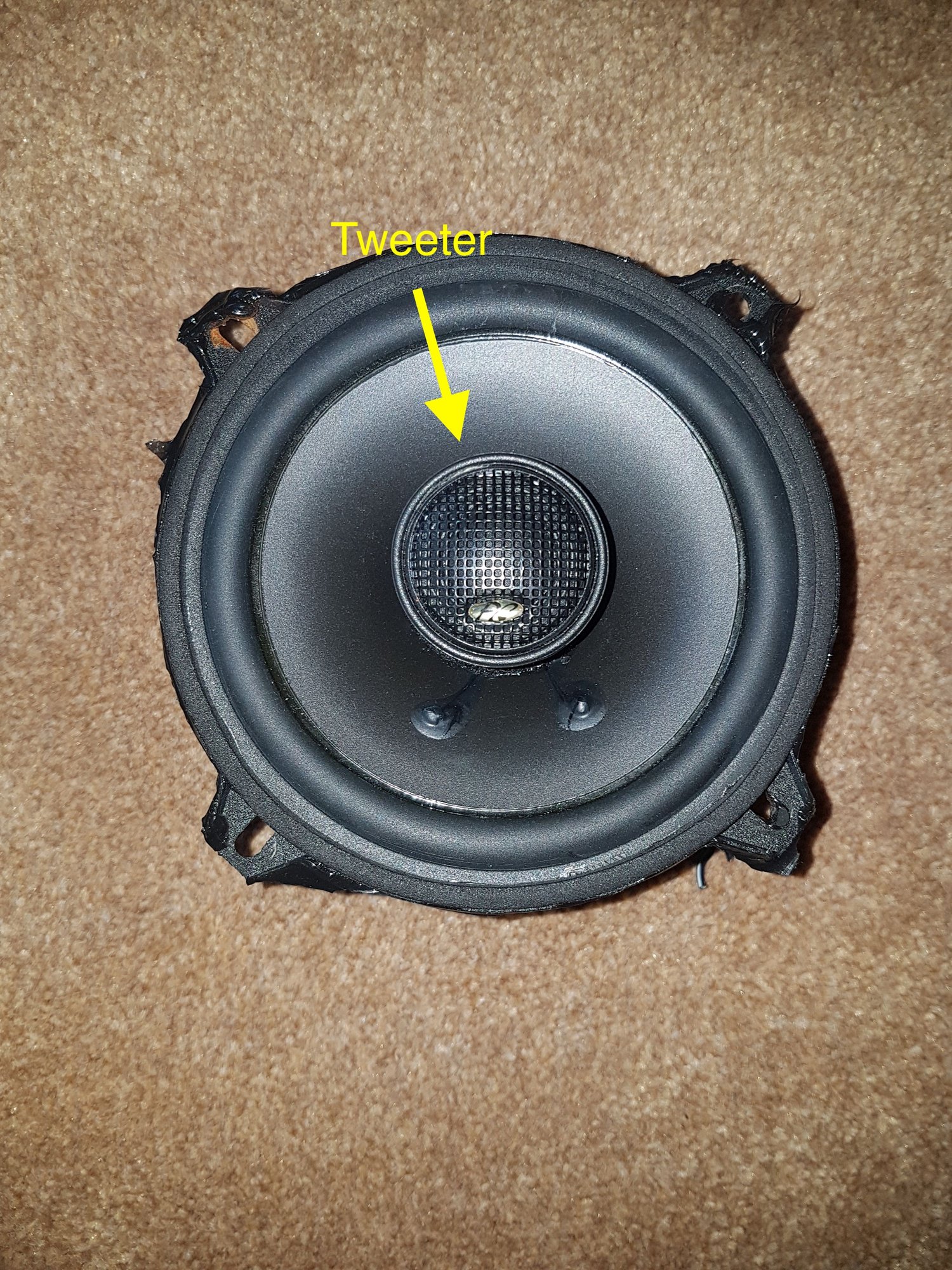

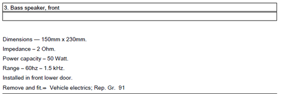

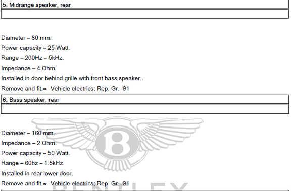

Do you know the depth for each speaker, I need to order a set, I have the tweeters & installed the fronts, I need the max depth ... Bass front, Bass Rear, Mid Front & Mid Rear ...
I have an idea for the PDC Beeps, for the rear Im going to install Coaxial speakers but not use the twitters as Im installing the rear tweeters at the points I mentioned in my earlier post. I can re wire the Coaxial so I only use the speaker and the crossover to drive the external tweeters & use the tweeter on the main speaker for the PDC beeps at the rear, then just wire up the tweeters from the 23 & 24 plugs, saves installing extra speakers. Still thinking re the fronts ...

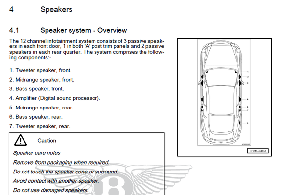

2 x Front Tweeters
2 x Front Mids
2 x Front Bass
2 x Rear Bass
2 x Rear Mids
2 x Rear Tweeters
These are your vehicle configuration

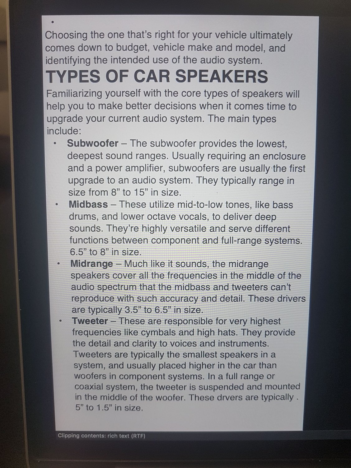

Different types of speakers :-

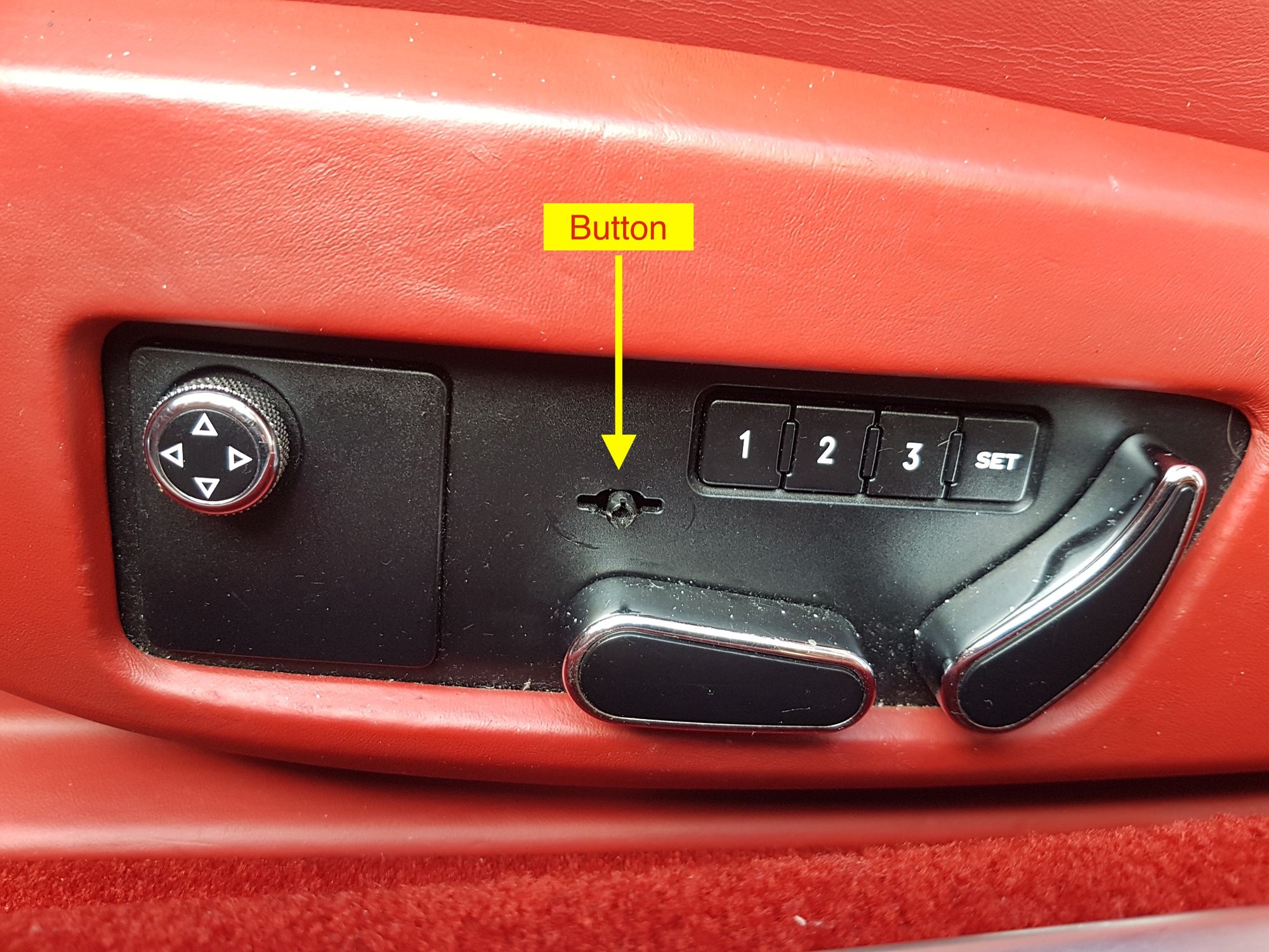

Ive tried looking for a side mirror control switch, need the **** from it. Anyone got an old switch that doesn't work need the **** from it.
Would be happy to pay for the **** & postage ...
And I need this button, its the N.S.F. seat control. this button has disappeared, don't really want to replace the hole unit if I can just get a button from a unit which isn't working. Again would be happy to pay for the button & postage ...

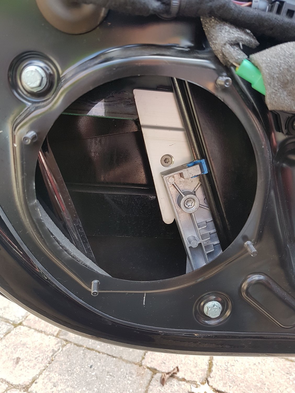

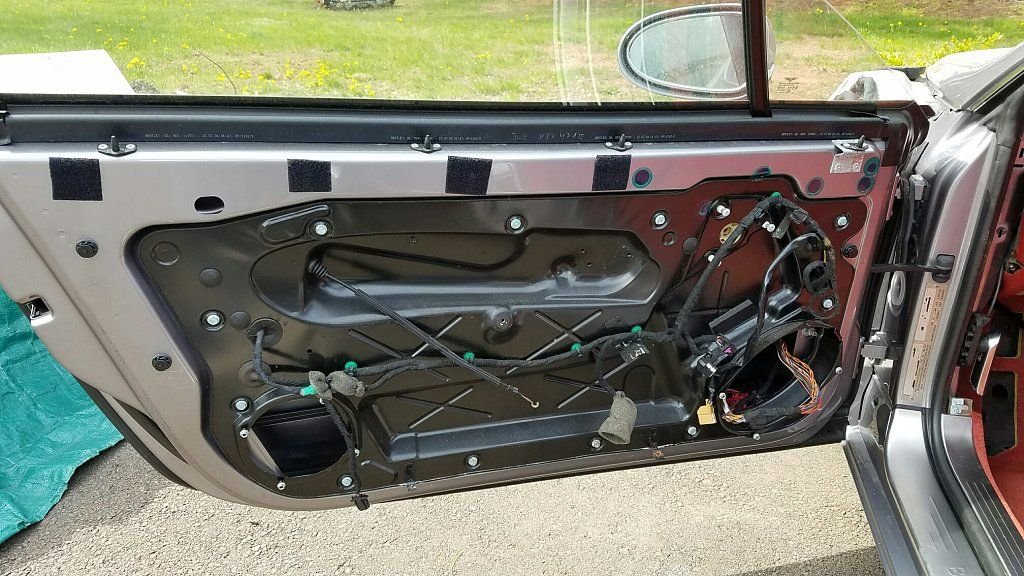

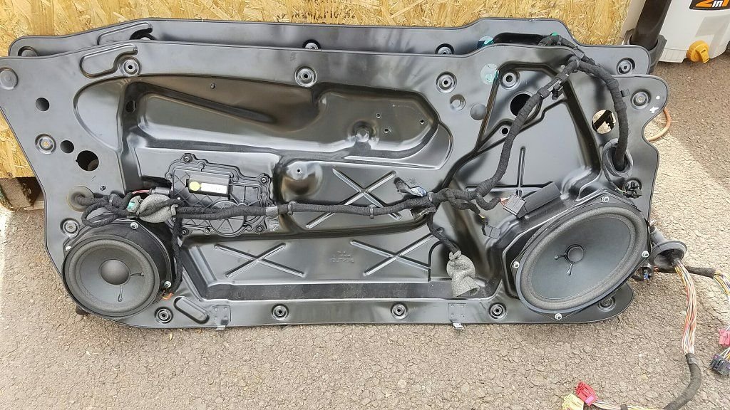

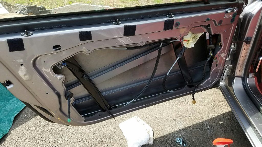

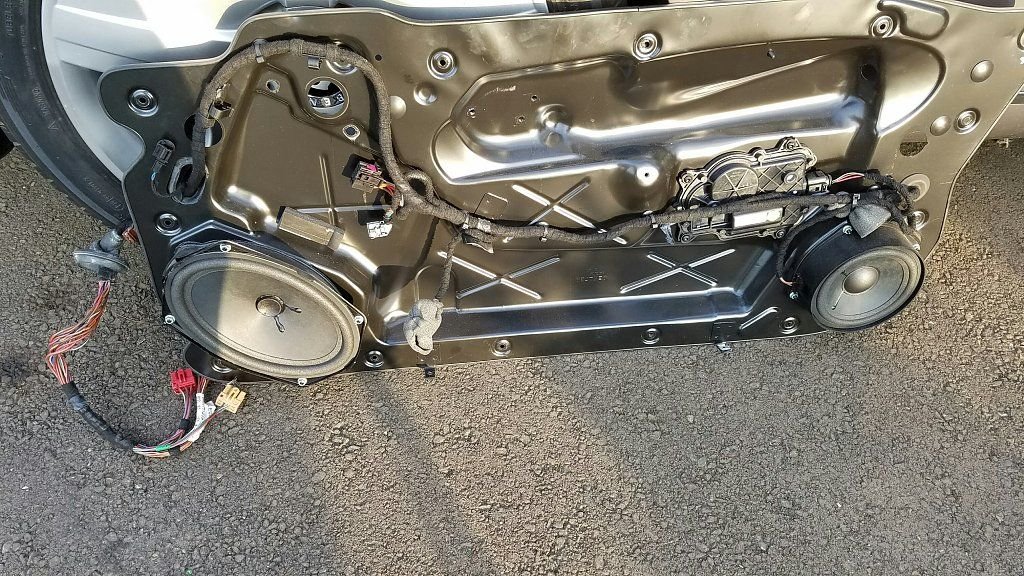

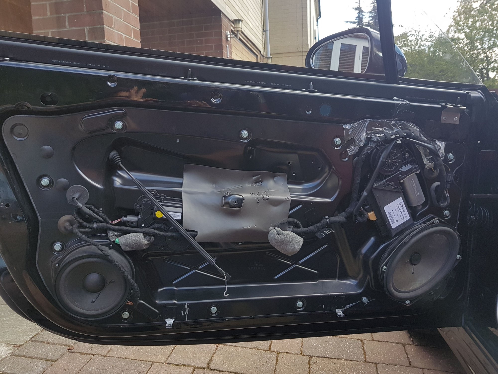

Ok today I removed the front door panel, to measure the depth (clearance) from front of the speaker to the rear avoiding the window, Front Bass speaker 7cm & the Rear Bass 9cm. This includes the spacer on the rear bass which is 4.3 cm. Now I can buy the right size speakers, The 6x9 I will have to make a surround to take a 16cm component speaker. I'll upload pics once the surround are made.
Heres a peek of the Door card and Speakers ...
