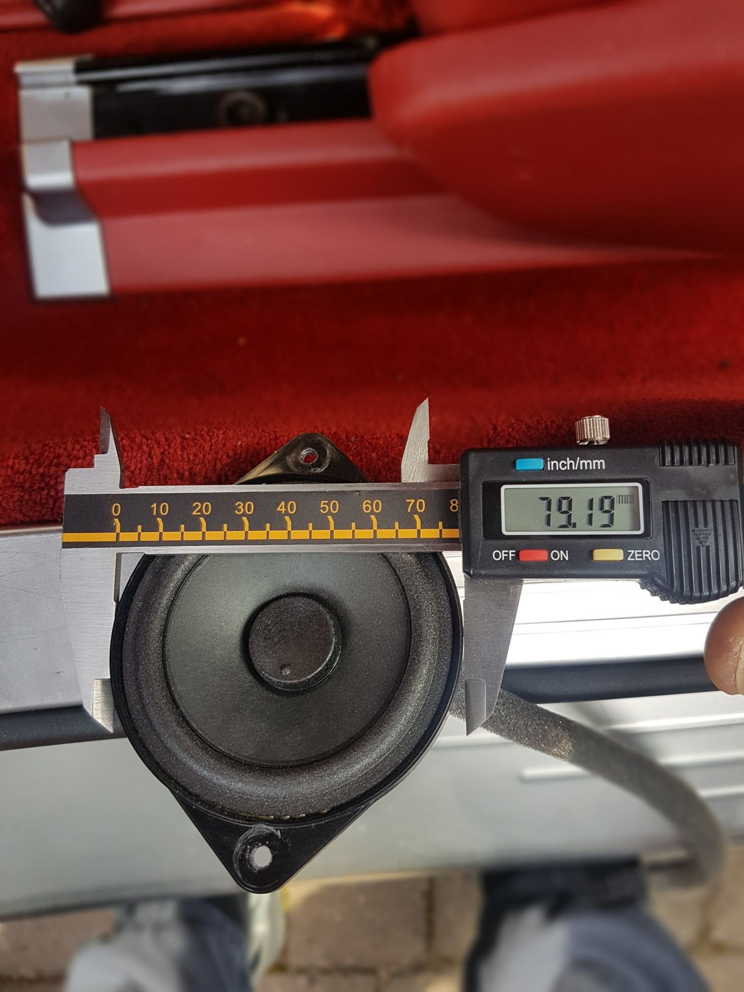

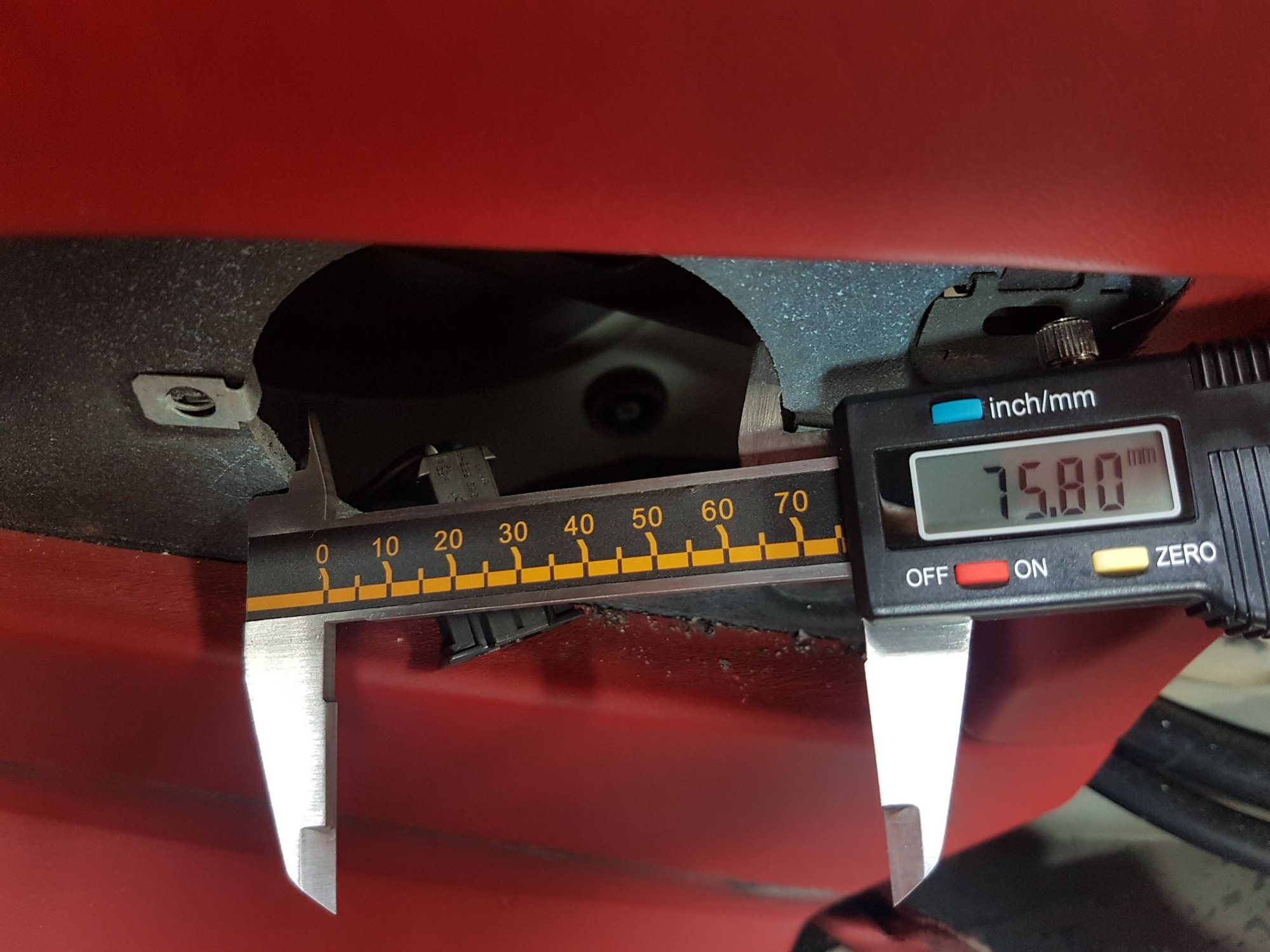

Rear seat Mids, removal, Remove the bottom seat by tugging at the bottom it will snap out of its lugs, then remove the centre bolt (torque) the back of the seat will fall, remove it, the grill will snap out by sticking your finger in the side & pull, the rest is in the pics.
If larger mids are required they can be done but a lot more work, this would consist of removing the side panel & inserting & fixing the Mid from the rear of the panel ...

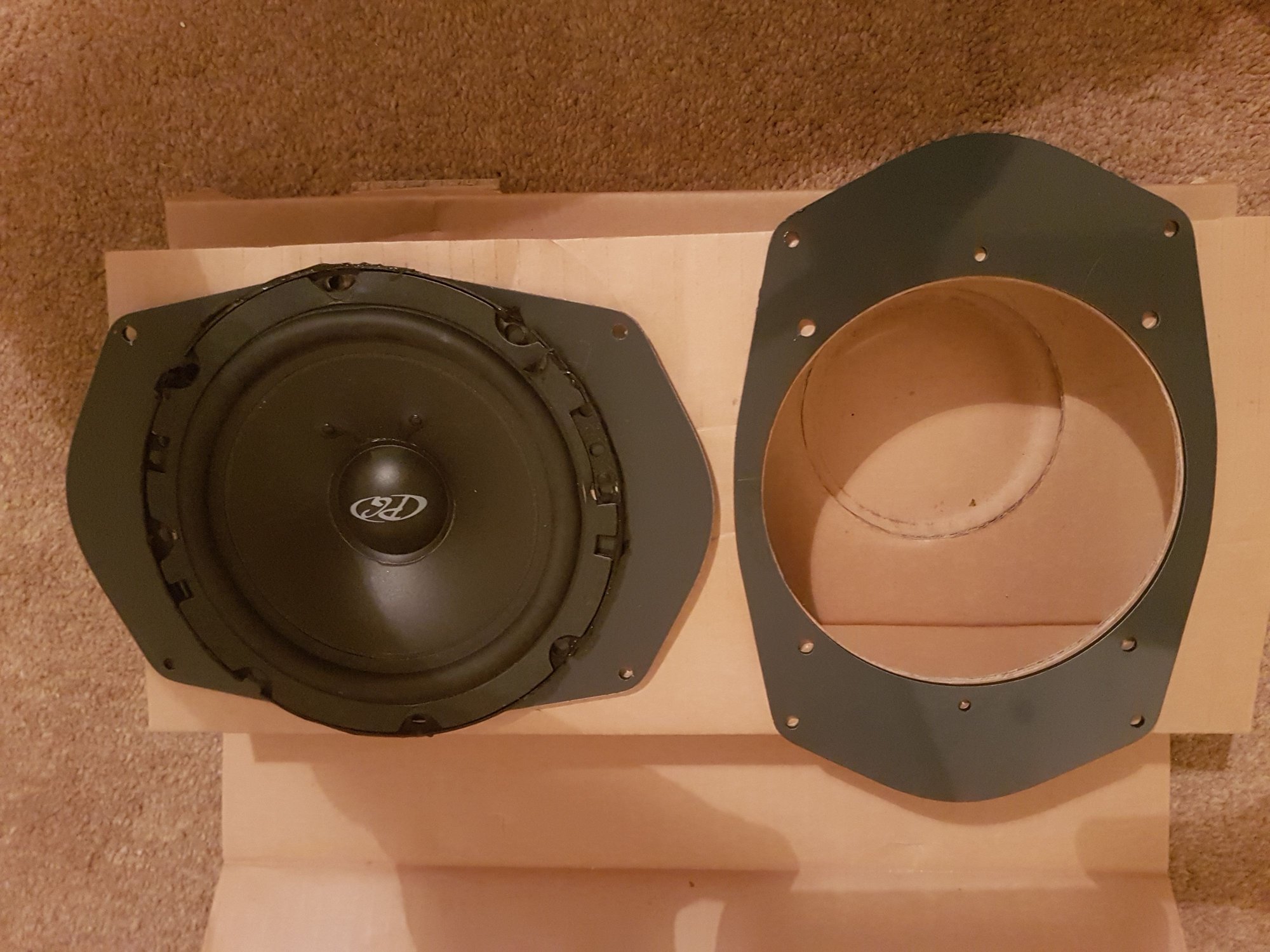

Replacing the 6x9 to 6.5 need adapters, take a profile from the 6x9 ...

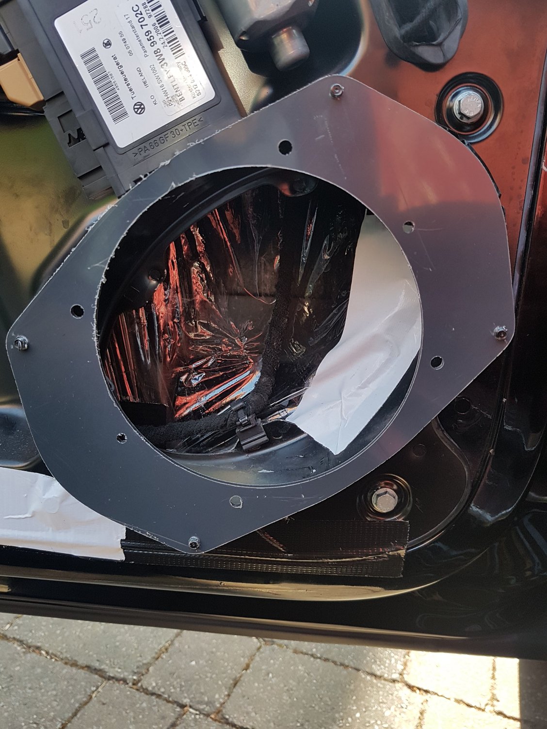

Took the door card off today to finish the carbon fibre panels & i installed the speaker plates, removed the 6x8's & installed the 6.5's, they not the speakers I'm installing as Im waiting for delivery, fitted these to see how they fit, perfect ...

I talk to an installer from YouTube that did a damn good system on our cars and he made it seem like it was some type of PhD was needed to make the adapters for our doors.
Nice 👍🏾! I don have the tools needed to make some so I’m just going to buy some good ones from somewhere. How thick did you make yours?
Are you you going to take that secondary panel off to get access to the inner shell of the door and install sound deadening or no?

Hi TeamJones, PHD no just need a laser cutter which costs 80k, Lol but i know a man who has one & i gave him a profile taken from the 6x9, he made them out of 5mm alloy tuff & waterproof, yes I will be sound proofing before I install the correct speakers ...

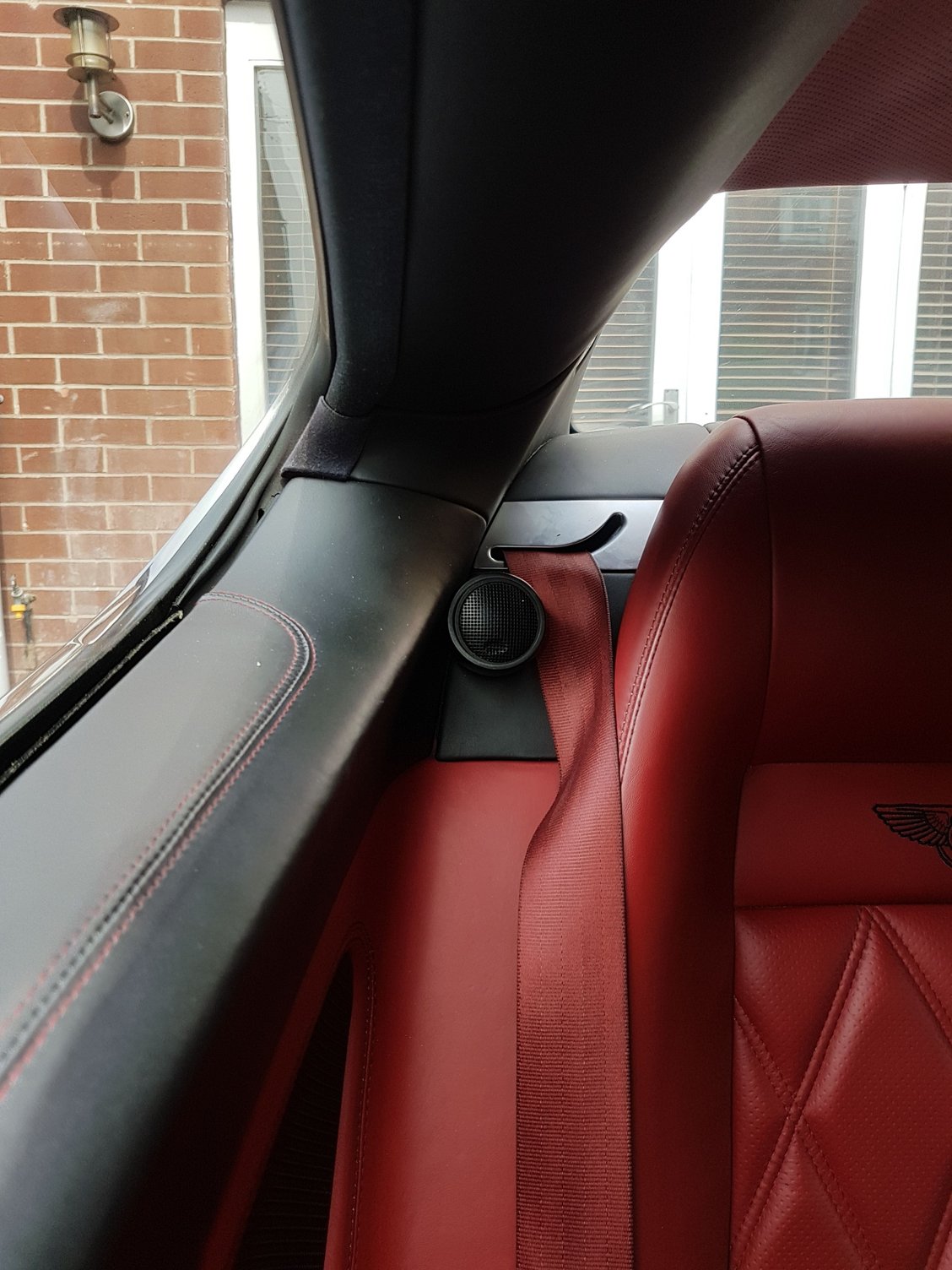

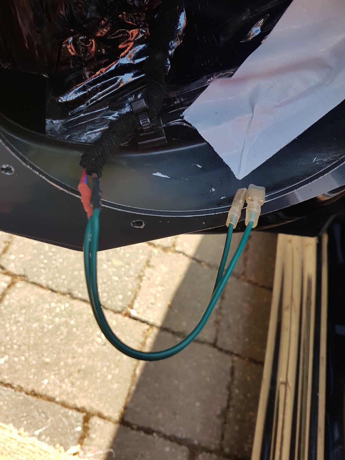

Installed the rear tweeters as for a odd reason car did have any, only 10 speakers, now I have 12 ...

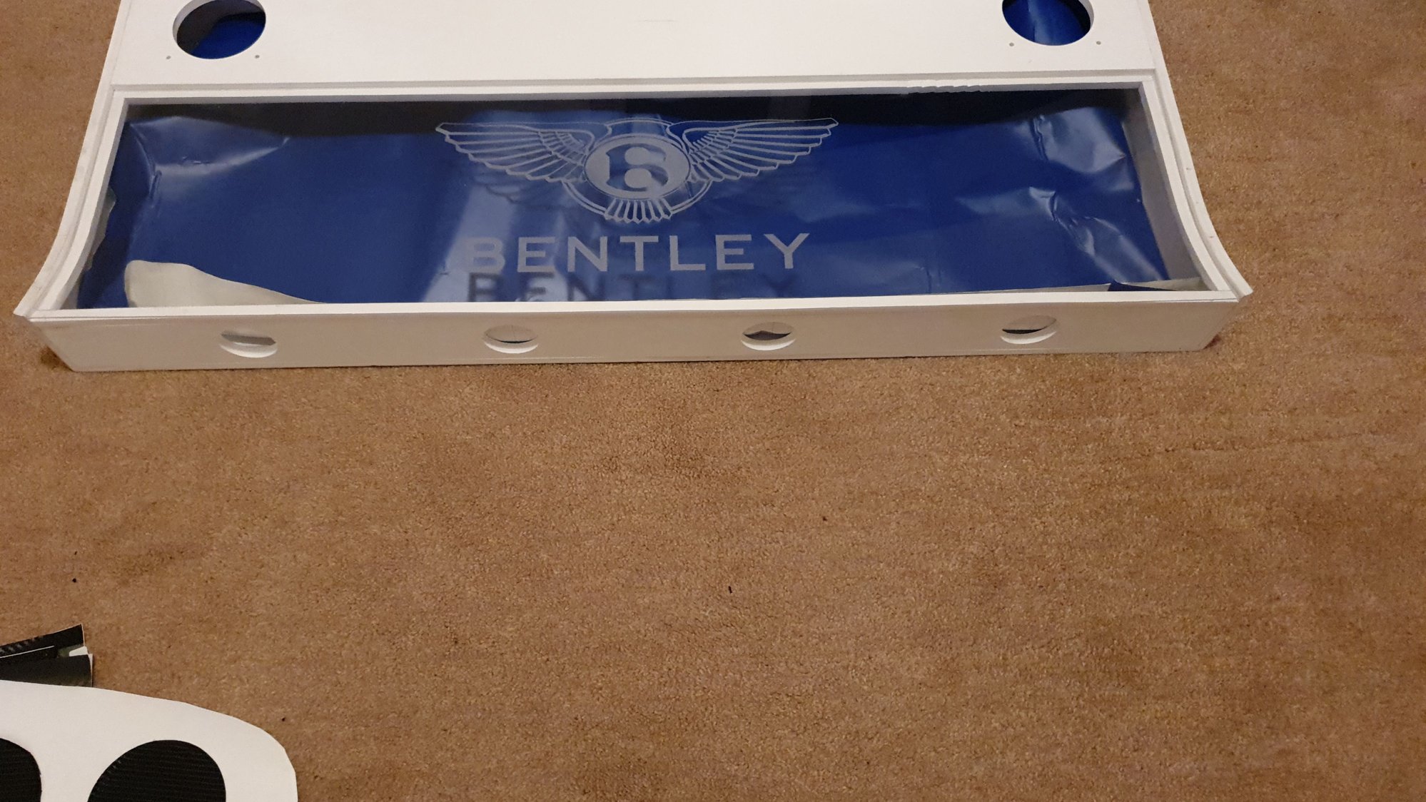

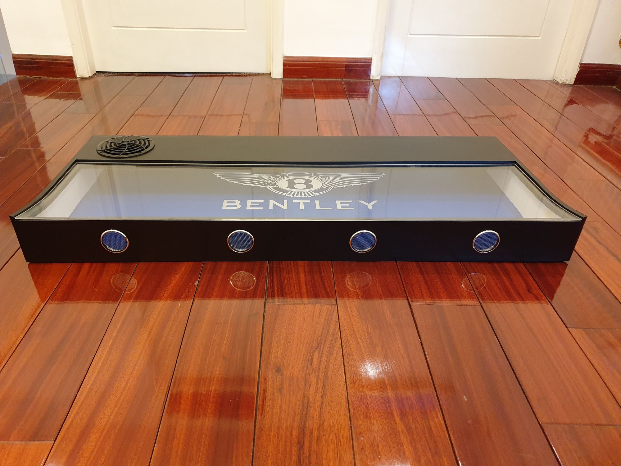

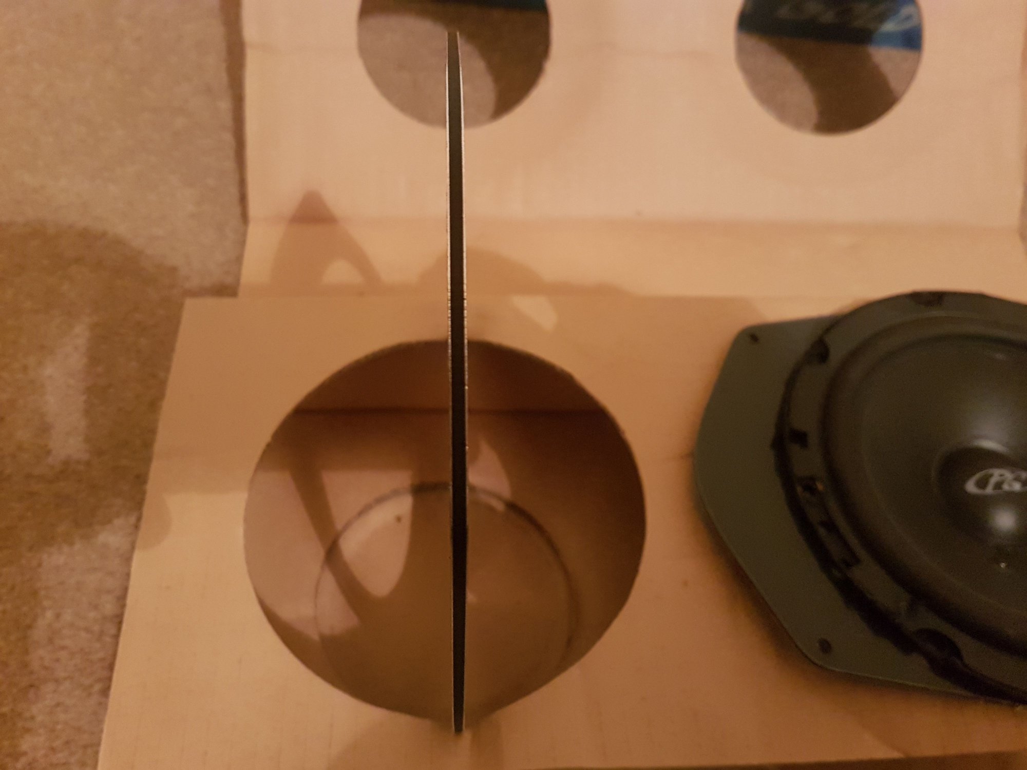

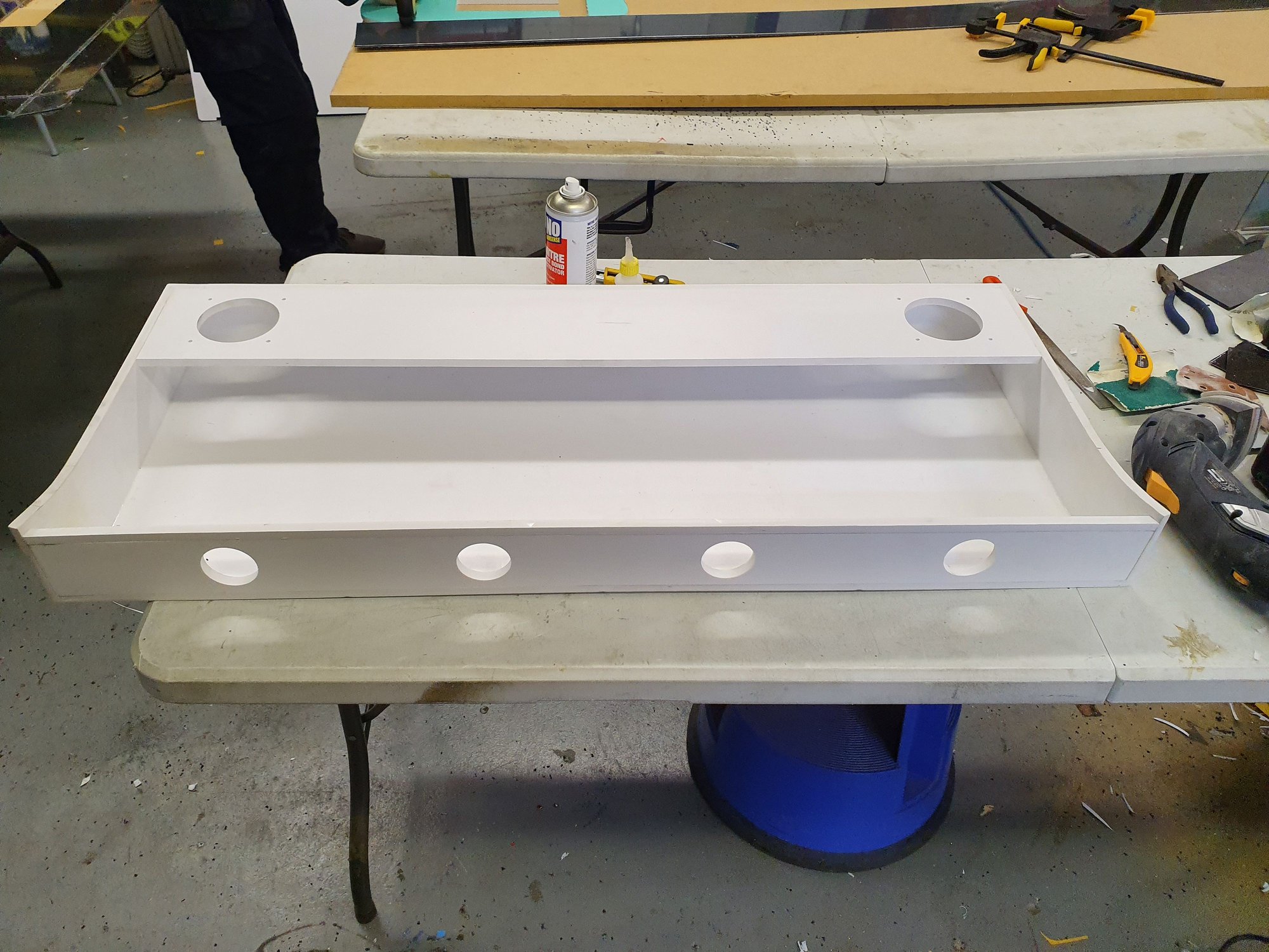

Been busy today constructing the Amp Box, here how I got on so far, got the box all made up needs rapping in Black, the 4 small holes are for air intake, the 2 big holes are for fans (exhaust) will be lite up in Blue L.e.d's, the box was designed on PC & cut on a CNC Router ...
Etched the clear carbonate with the Bentley logo, it all weights as much as a bag of sugar ...

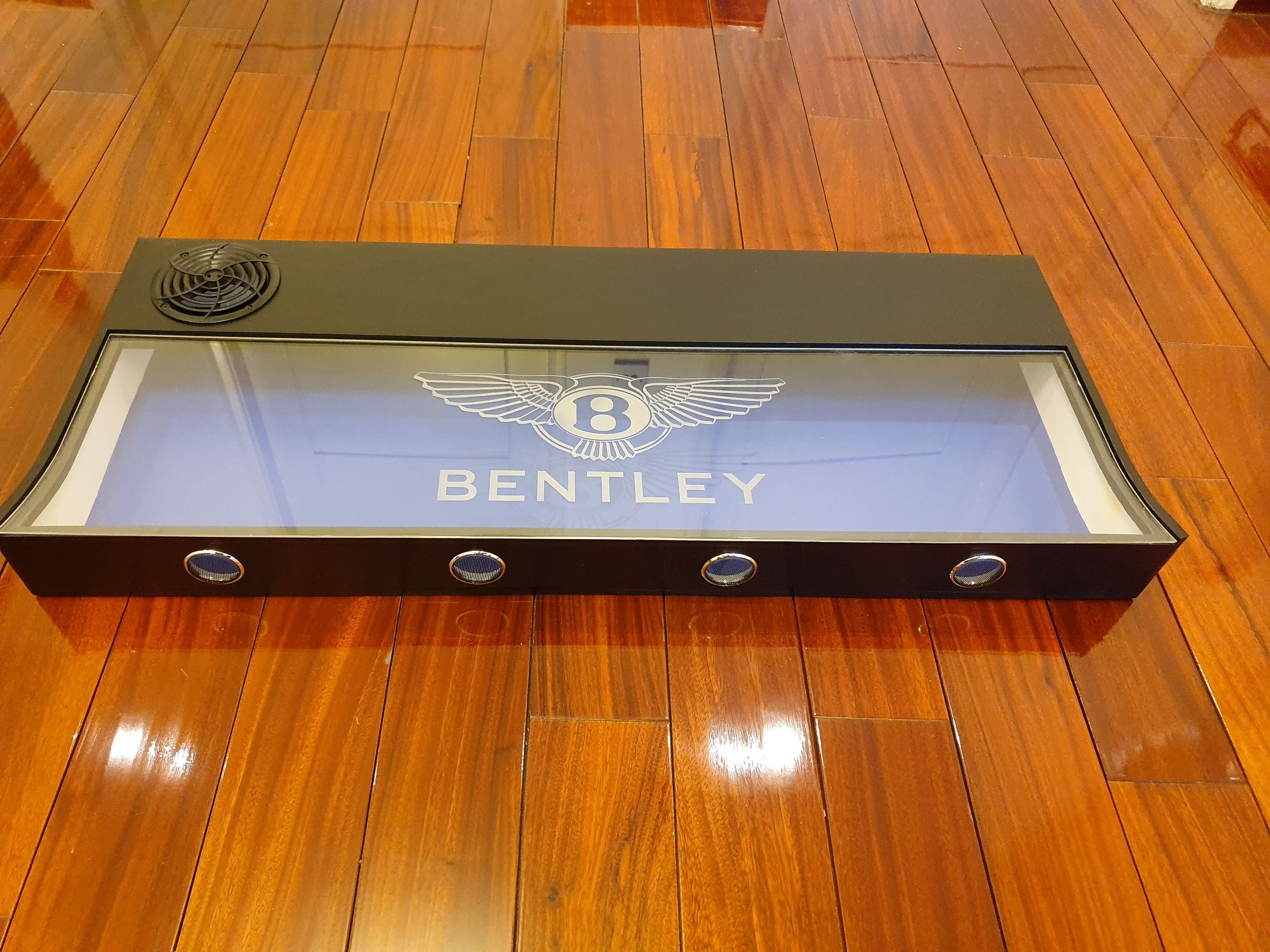

Finished the Amp box, now for the install but not today we got big storms with thunder & lightening ...
