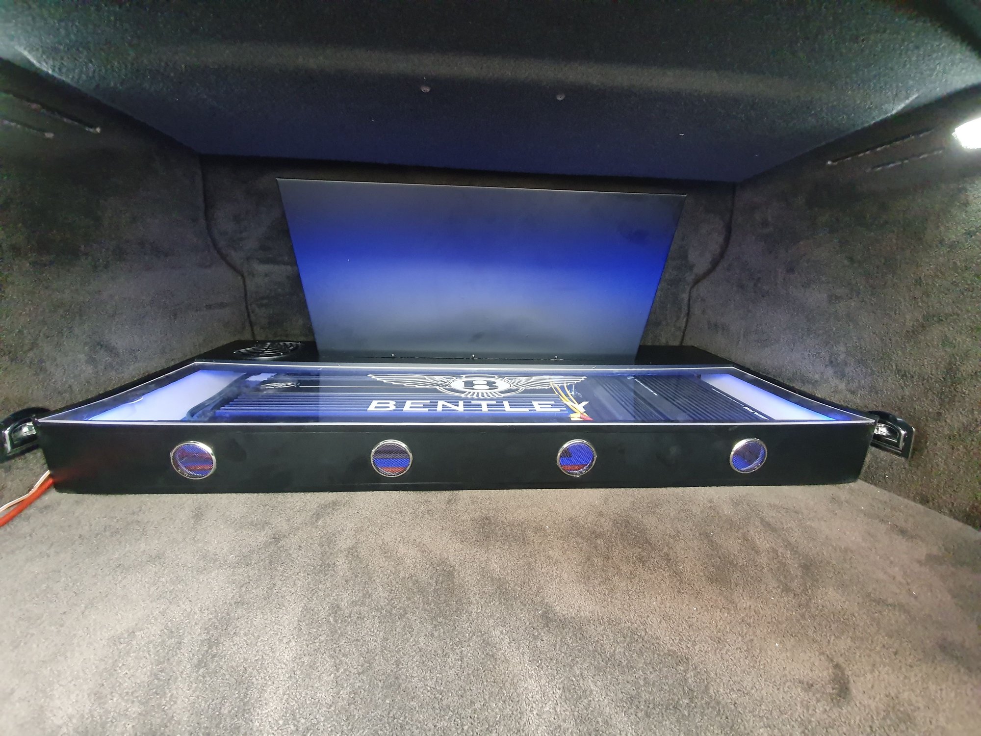

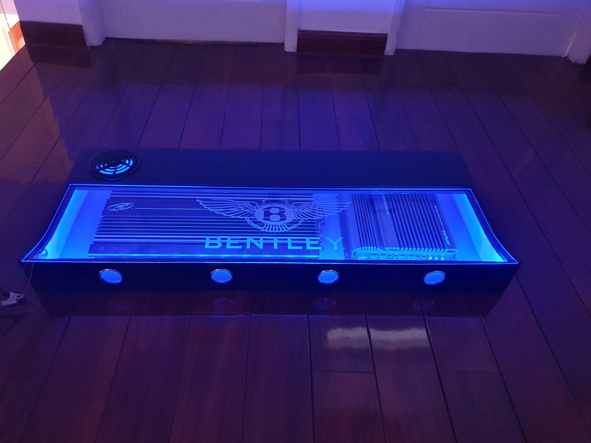

Finished ...

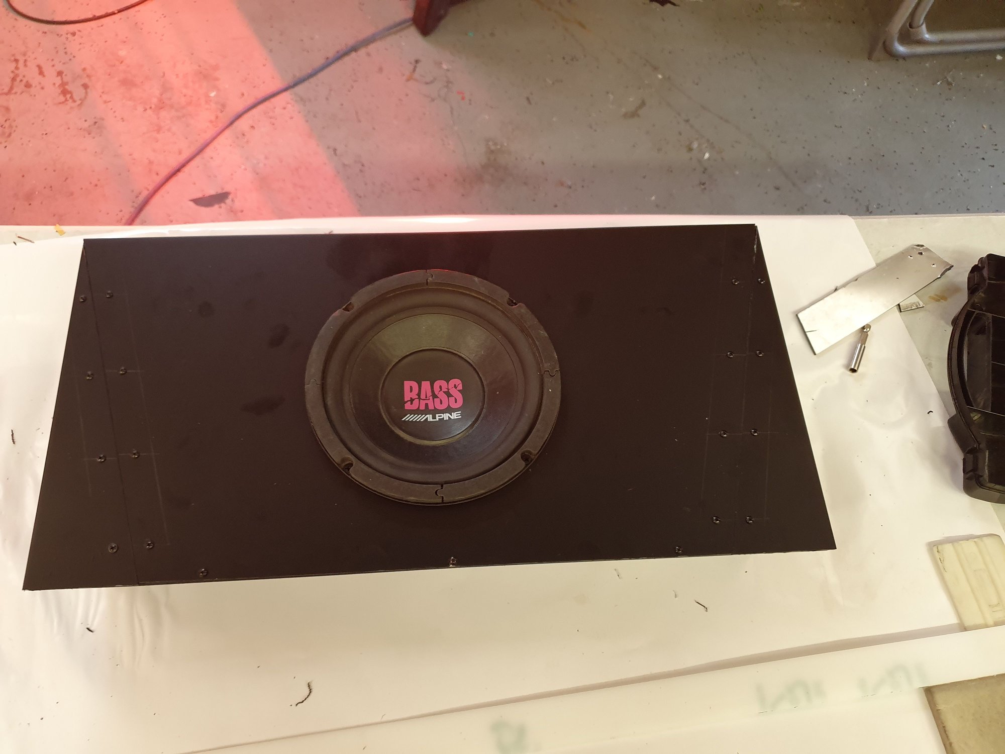

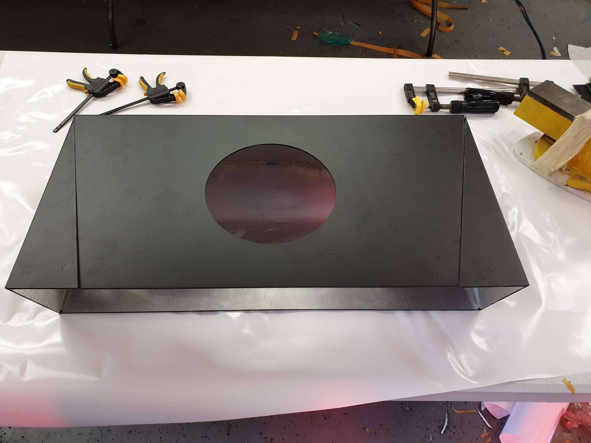

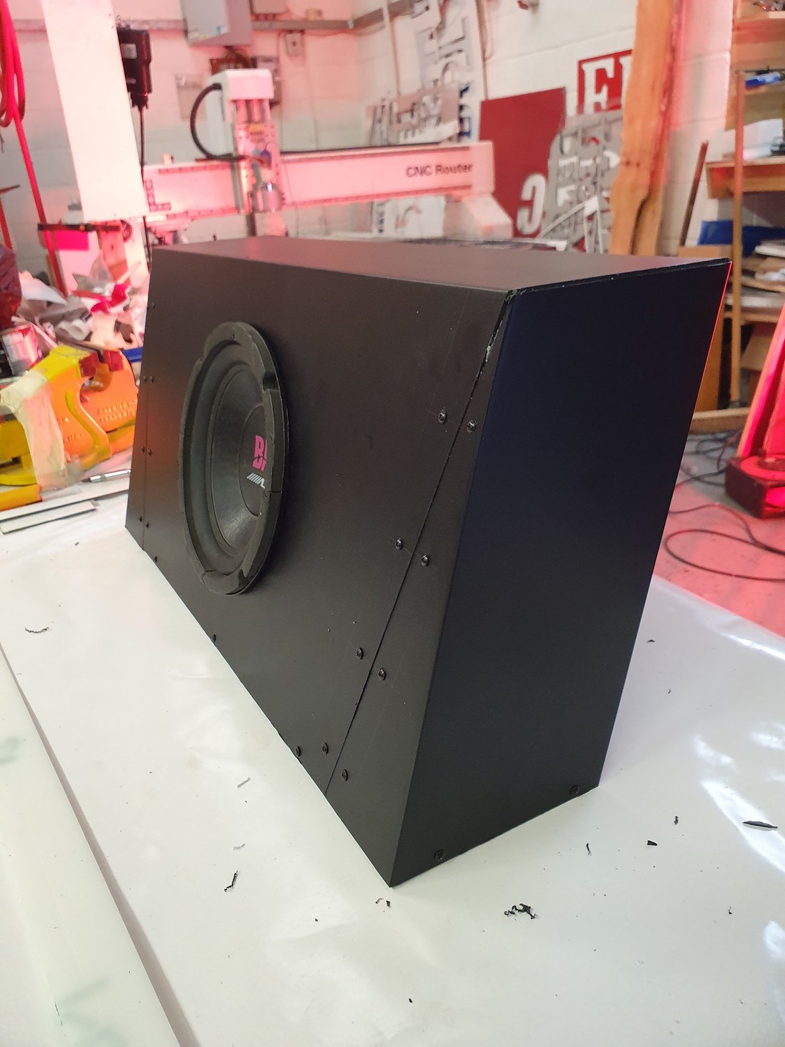

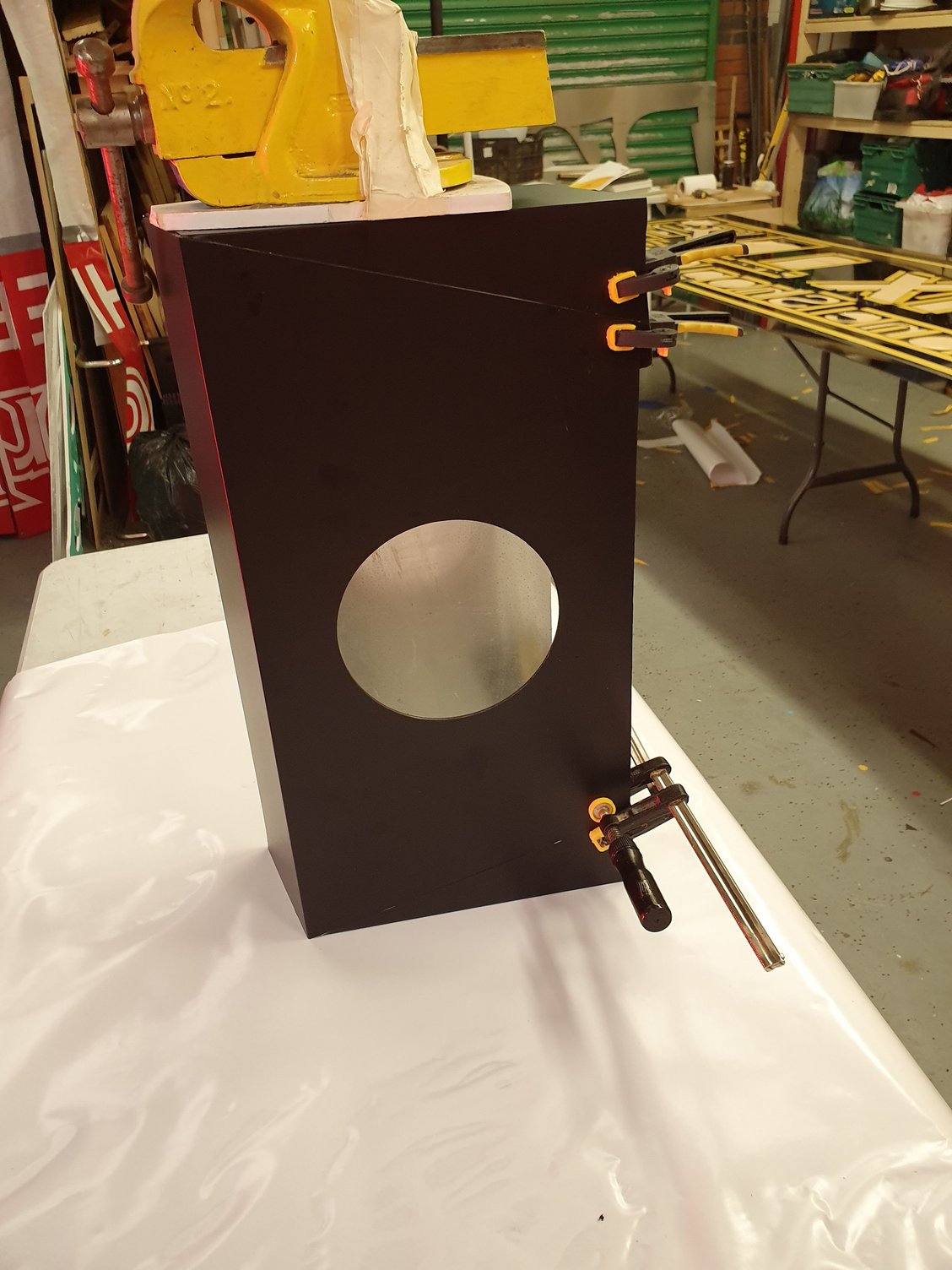

Made the SubBox from Alloy & raped it in black vinyl ...

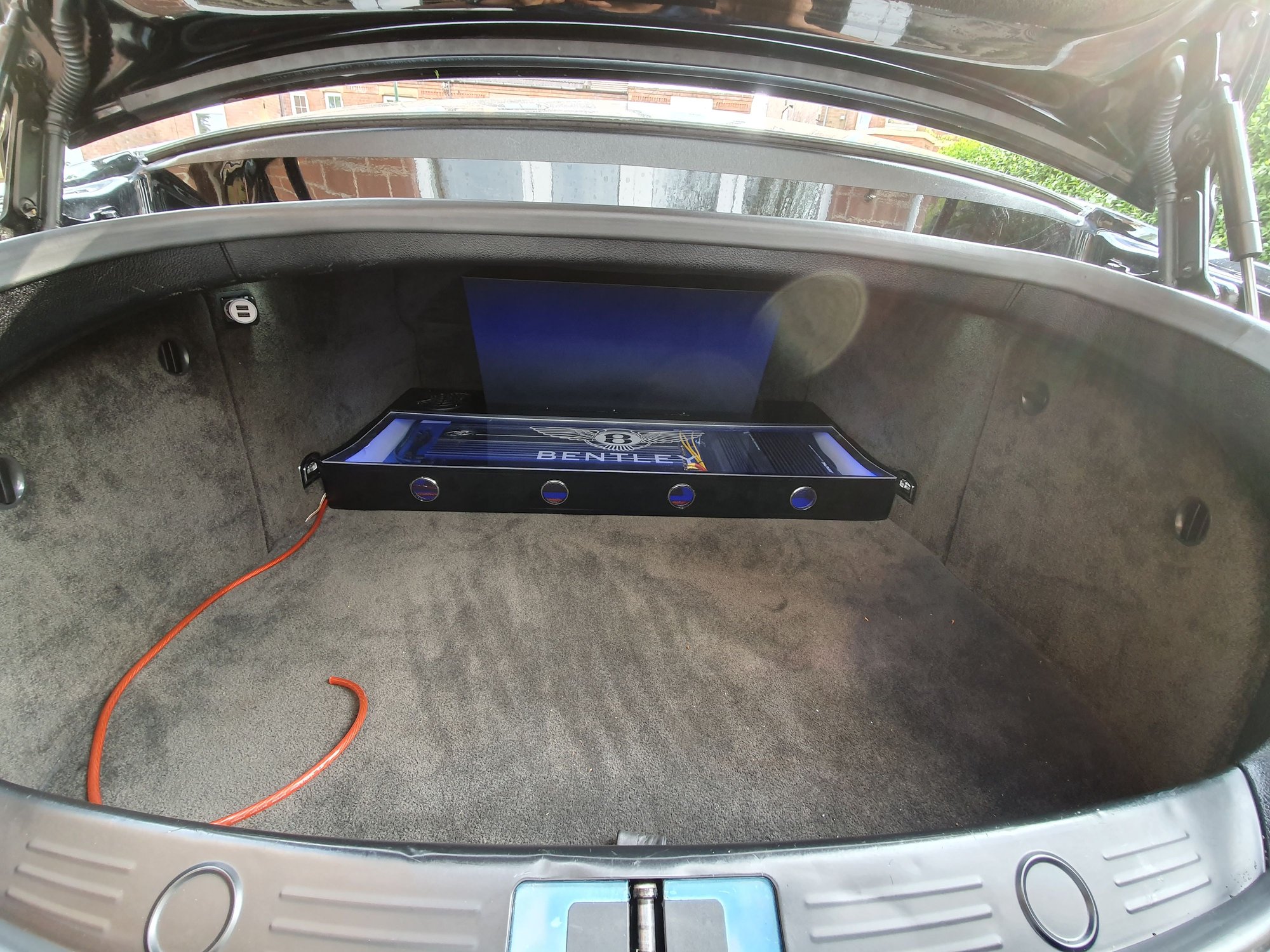

Fitted the Amp Box and the Sub Box, needs wiring up, did all the prep work in the amp box, once the RCA cables from the rear of the amp box are sorted the box will go 100 mm further in. Wired the blue led's to the boot light with a detachable connector if the amp box needs to come out, the fan runs on a thermostat in the amp box ...
Now for the fun part got to wire up the hole thing disconnect the stock amp and fit the speakers ...

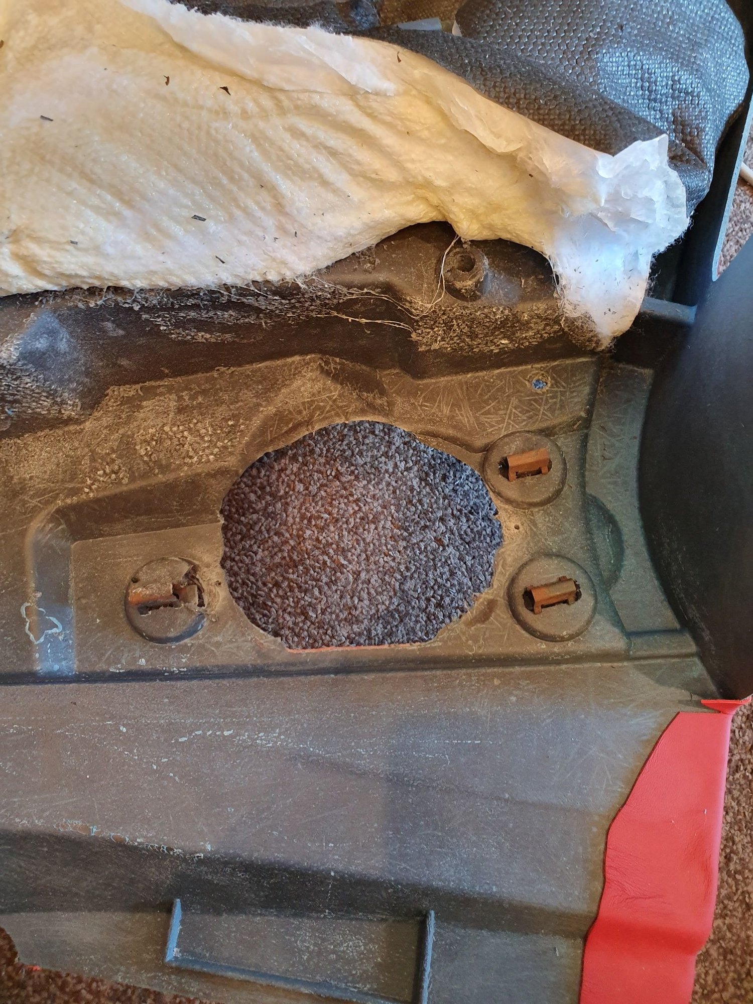

Ok I got busy today and installed the rear speakers, removed the stock mids and replaced them with 5.0 (130mm) coaxial speakers, Ive used coaxial due to the PDC Beeps, using the tweeters on the speakers for the PDC Beeps and the main speaker will run off a crossover with external tweeters, the O.S.R was simple but the N.S.R is a mission due to 2 modules right behind the speaker, had to relocate them. Theres a bit of modification involved but its done ...

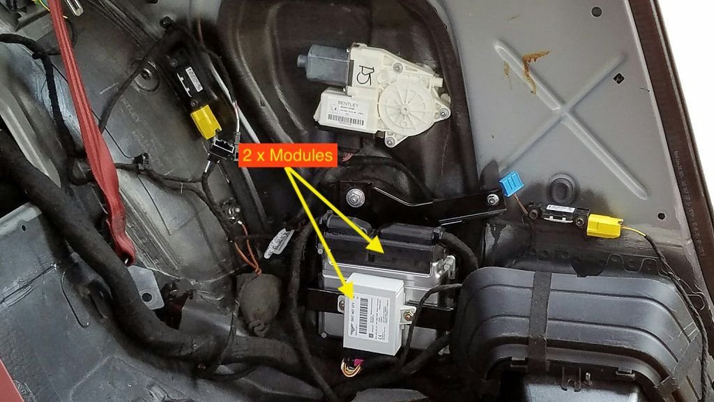

Ive used the pic re the modules from Johnny's post, I forgot to take a pic ...
