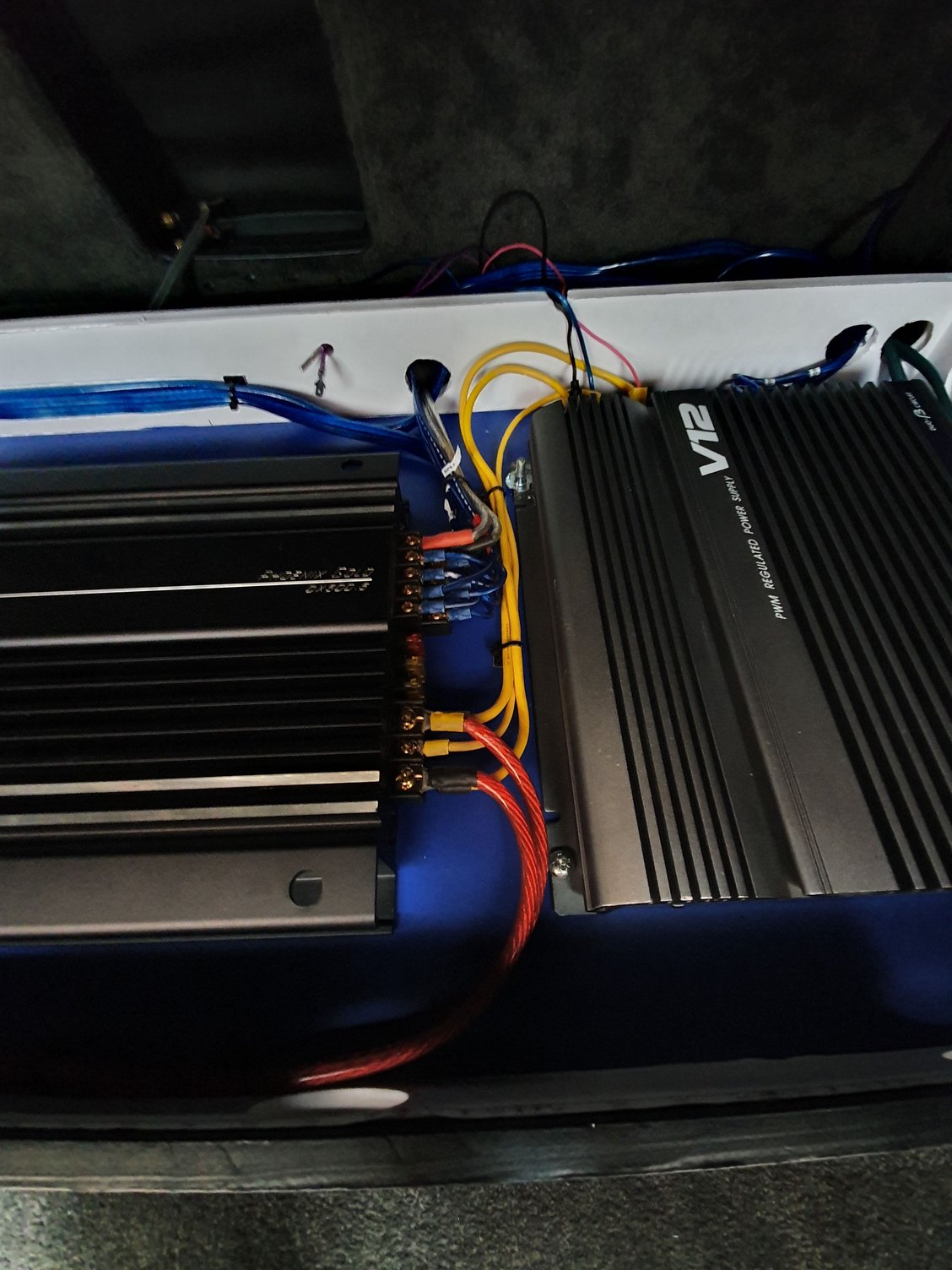

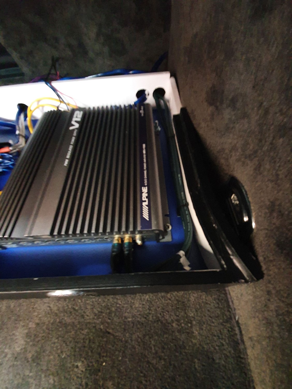

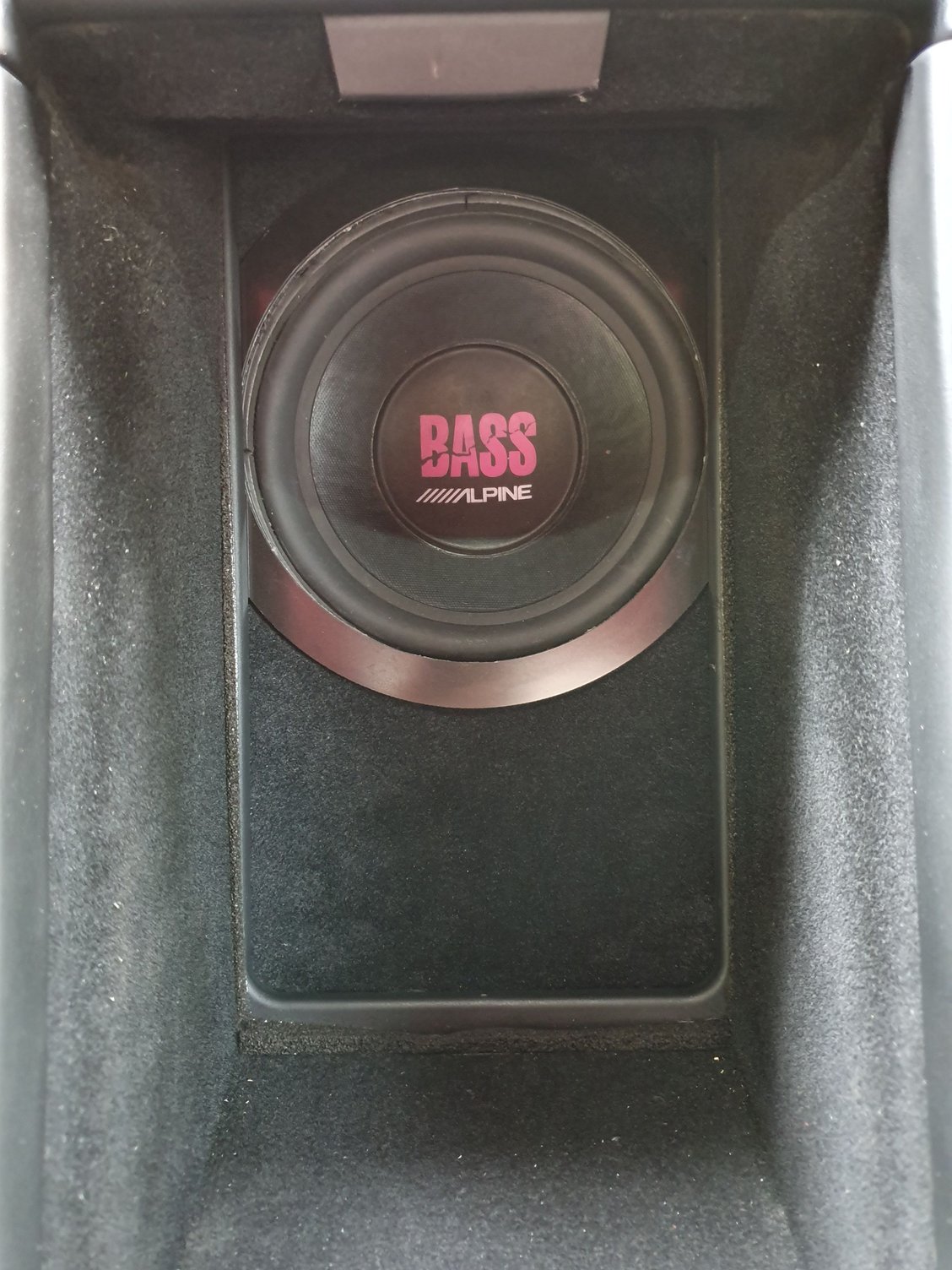

Centre Sub Box complete ...

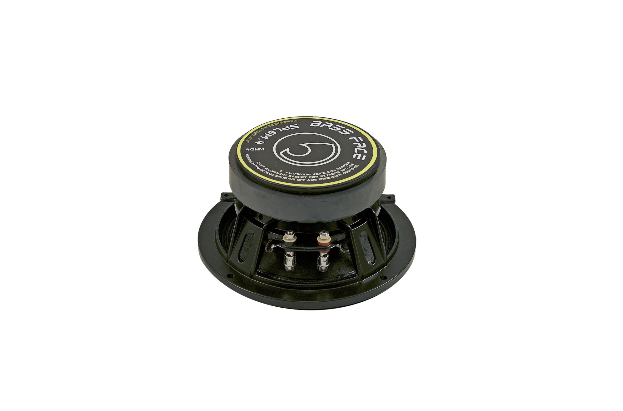

Been waiting weeks for these speakers, got them today. Going in the doors Rear Bass. 300w ...

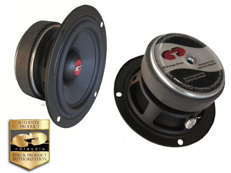

Found the perfect Mids for the Doors, from your side of the pond ...
MX-3F 3” cast mid-woofer
The devil is in the details and so is the magic.
The cone of MX-3F midrange drivers is made of a light, yet rigid, mixed fiber fiberglass. Producing unrivaled midrange that is engineered just for your car to make the most perfect blend with any CDT tweeter and crossover. Small size midrange for the true audiophile listener.
MX-3F
Technical specs and contents
  • 1 pr 3” mid-woofer
    • Frequency response 90Hz-11.000Hz
      • Power handling: 100watt (150Watt Pk) HPF-250Hz
        • Impedance 4 Ohm
          • Sensitivity: 85.9dB
            • Mounting depth: 1.69” (43mm)
              • Cut out diameter: 2.90” (73.7mm)
                • Frame: OD 3.7” (94mm)
                  • Cone:Mix fiber glass
                    • Magnet weight 7.2 Oz
                      • Cone surround rubber
                        • Voice coil: 1.0” (26mm)
                          • Fs: 110Hz

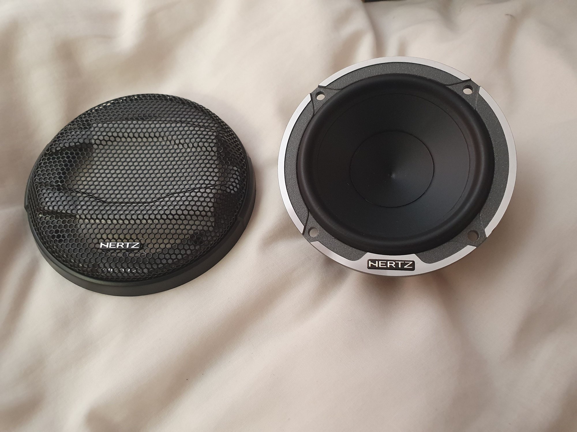

Got the Front Mids today Hertz Mille Pro MP 70.3,100w, 3" ...

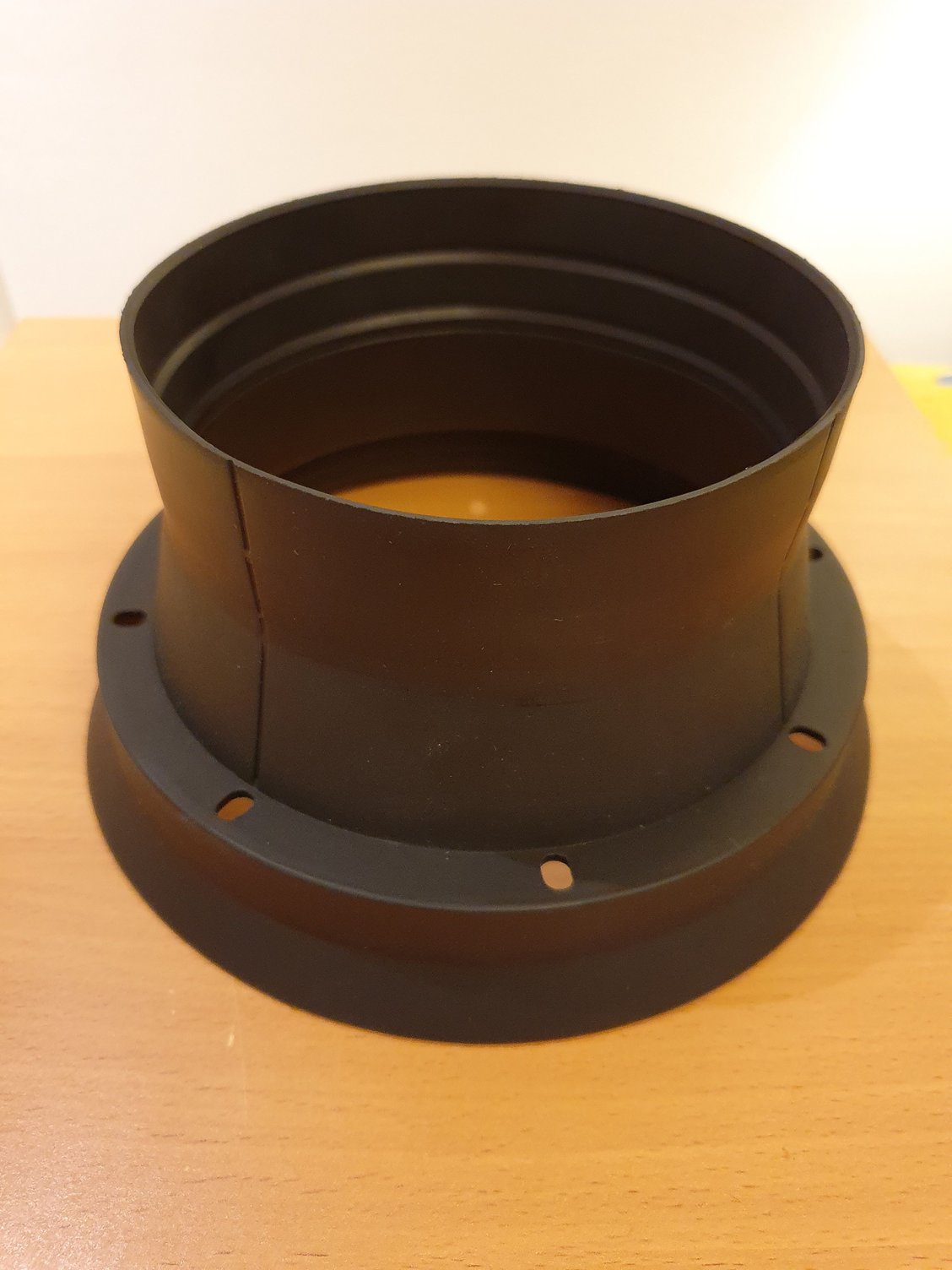

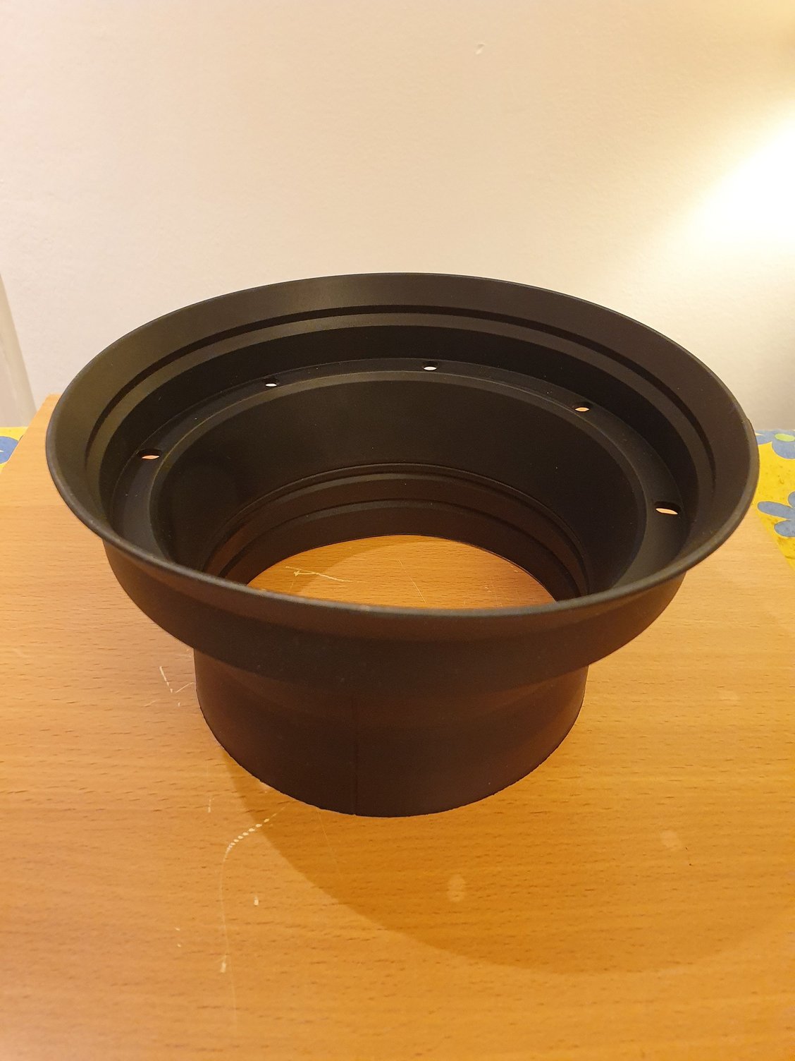

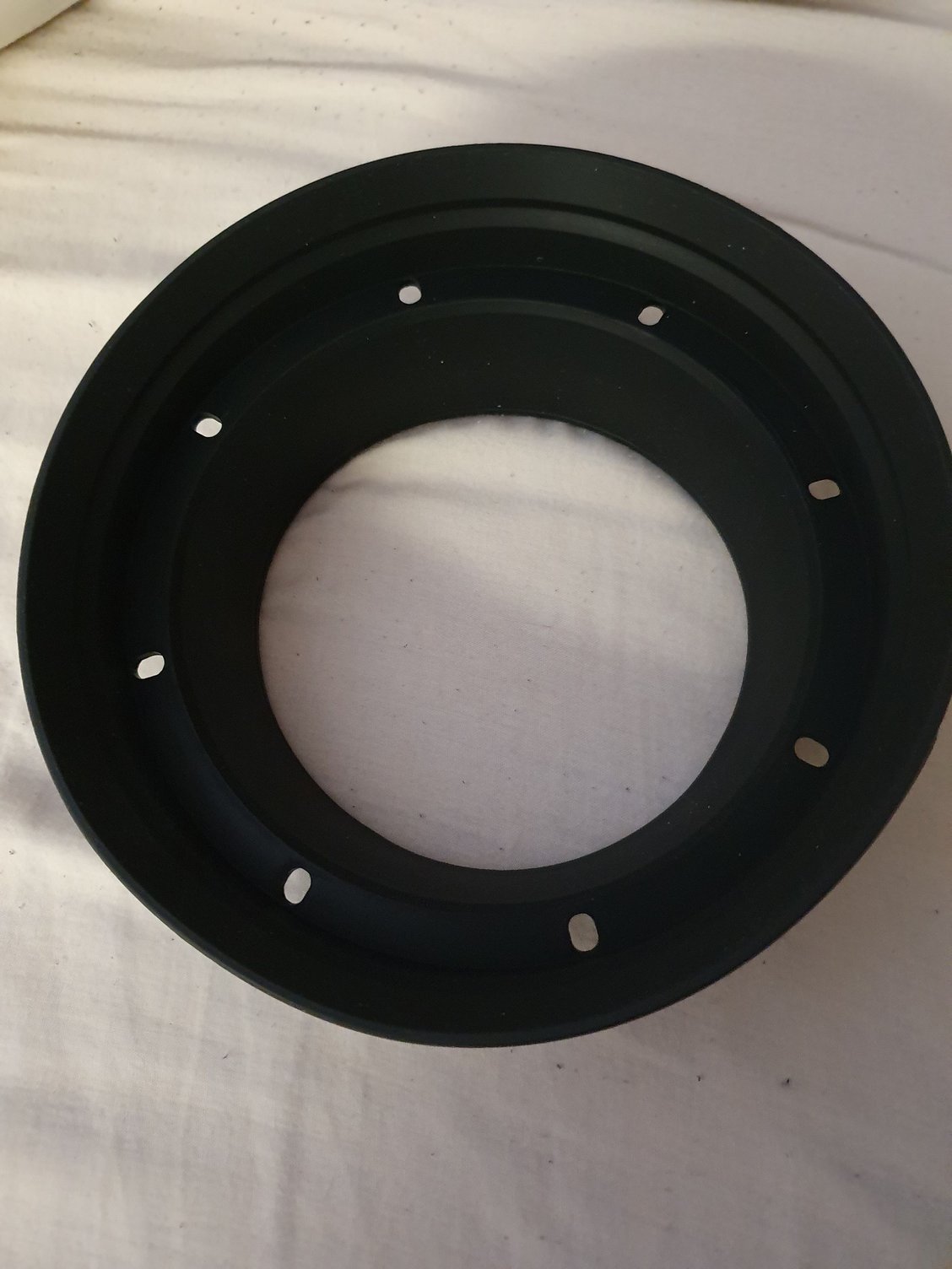

Got some more parts for the 6.5's to make them water tight and direct the sound outwards, Speaker rings and Bafflers ...

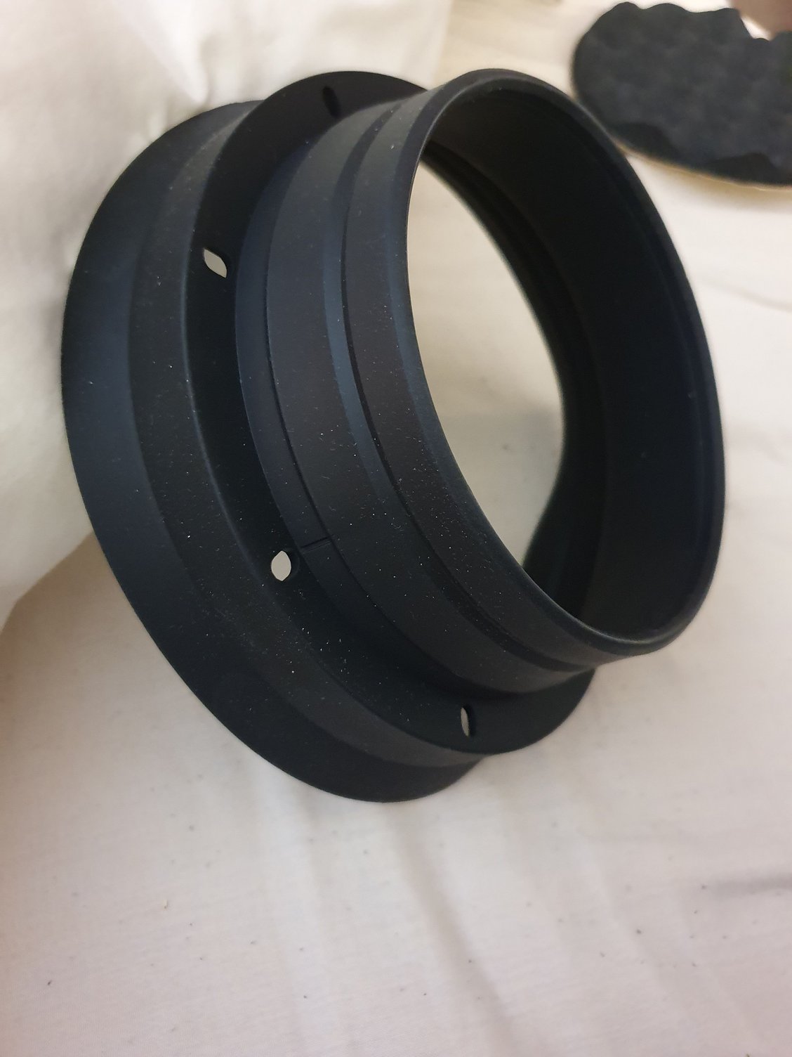

Got the Baffles which fit perfect over the 6.5's, on with finishing the system ...

These Baffles are the best things you can buy, they will protect the speaker from water running down the window and drive the sound outwards, there are ones on the market that are compleatly sealed but I don't see the point with these as there is no place for the air to move around from the speaker, buy the open ones as in the pic ...

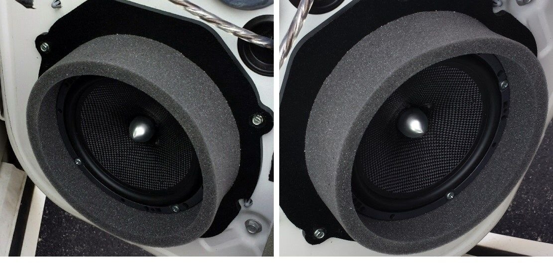

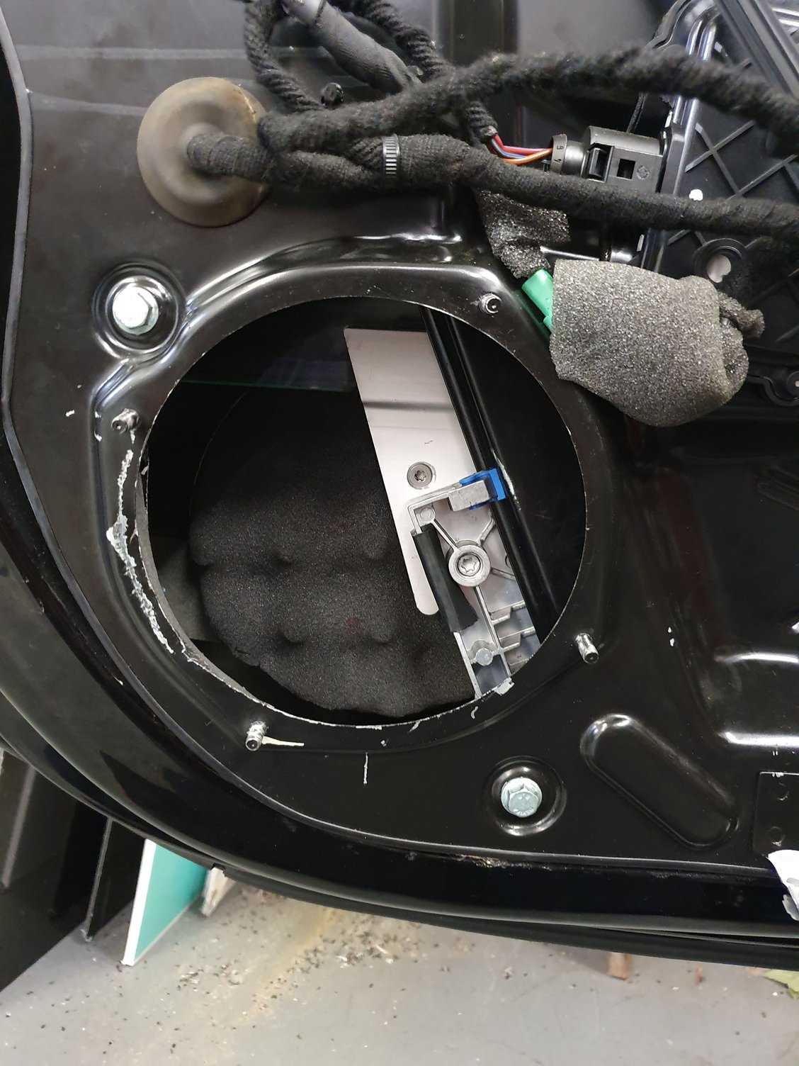

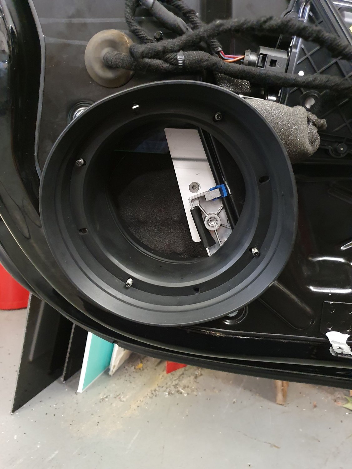

Started installing the last of the speakers, Installed the baffles for the Door Rear Bass speakers ...

Installed the Bass speaker Rear Doors, that all the speakers installed, all is left is to contact the amps and disconnect the stock amp and I'm good to go, I'll try and take a video of the wiring from the new amps to wiring loom on the stock amp and the sound system when complete ...

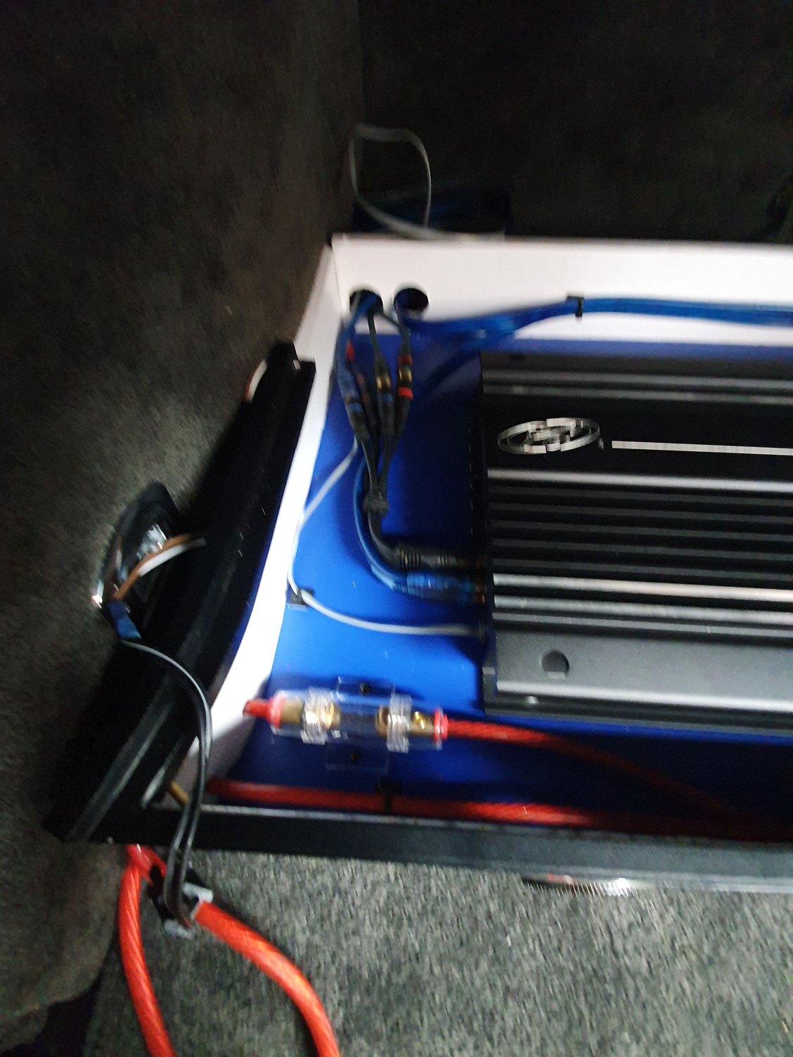

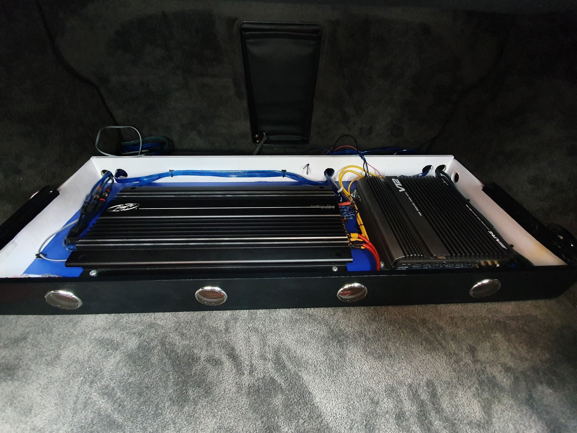

Finally wired up the new amps all put in place including the sub box, just the stock amp to unplug and connect to the new amps ...

Ive changed all the speaker wasn't easy espesally the rear door bass speakers had to make up new rings to space it out so it doesn't hit the window mechanism, did all the sound proofing in the doors and rear panels, put the volume up can't hardly hear a sound outside ...
