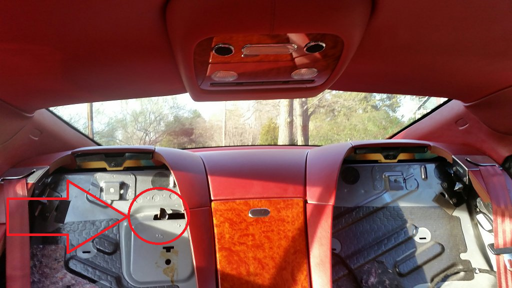

That is why there is a emergency release lever behind the right rear seat back.
