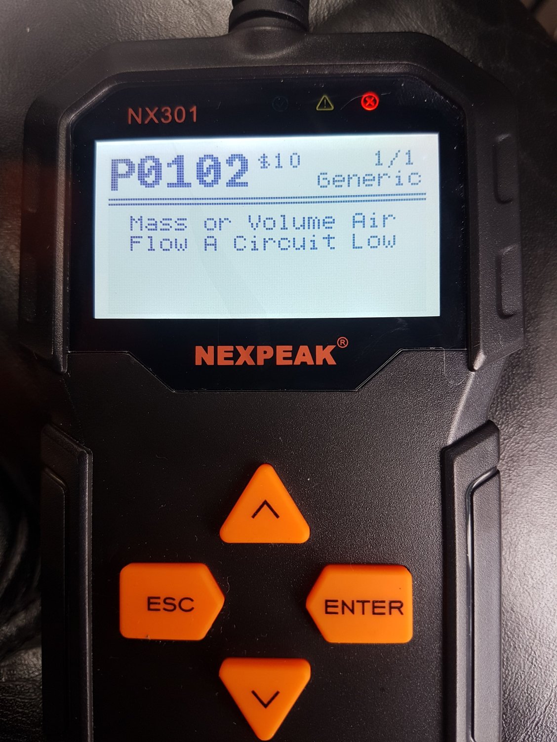

Code Just Popped Up ?
Whilst driving my 04 BCGT this morning, it felt a bit uneven on idle. Still drives ok, just a bit lumpy. Got home and plugged in the OBD Reader and it came back with one code, namely P0102. Mass or Volume Air Flow A Circuit Low.
Any suggestions or advice would be gratefully received. Thanks. Beo.

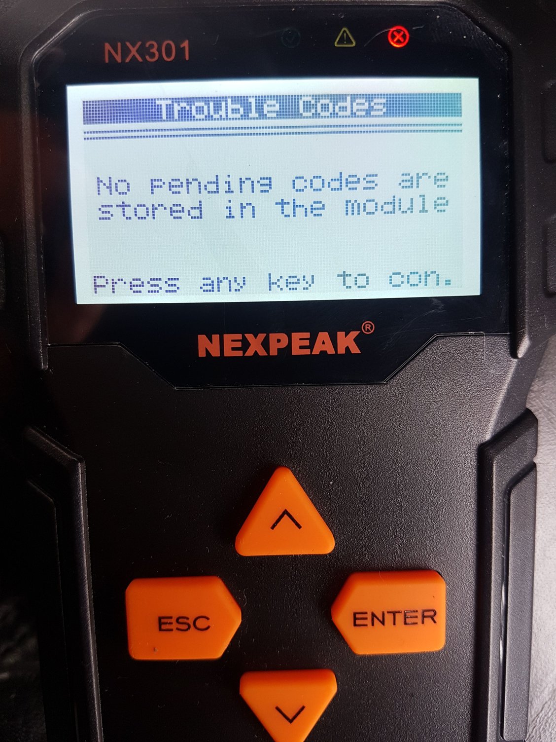

Removed the air filters and boxes. Removed the MAF`s. Gave everything a thorough, but gentle clean. Wire condition and plugs looked in remarkably good shape.
Re-fitted all components, cleared the codes and so far, so good ! Fingers crossed !!
Thanks for all the advice, its greatly appreciated.
