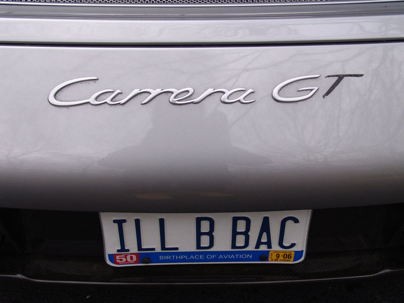

As you can see in the pic I included, the T in the lettering Carrera GT on the *** of the car is off! I was drying the car one afternoon and my towel snagged the letter T and it popped right off! I freaked out. From what I can tell, it was held on with what looks like double sided tape or foam tape. Is there a easier way to reattach it or a brand name of tape that would work? I was going to give clear silicone glue a try but I was afraid it may harm the paint. Any help would be appreciated. Thanks, Michael

Best fix is to get the factory part and have your detailer remove the old double back tape and apply the new letter.

Michael, you can try those double sided tape designed for cars, you should be able to find them online, but you better clean the old tape first before you put the new one on. NEVER use glues!! They are not good for cars!!

stay away from any glue. order the new lettering from dealer (if u can't get it i'll mail u some). the double sided tape should come off easy but DO NOT rub on paint to get them off. use hair dryer & goo-gone if needed.

Thanks for the replies. I called the salesman a few months ago and he said he was going to order a new set of lettering for me but he never came thru and I forgot to call him a second time. I'll do that on Monday.
