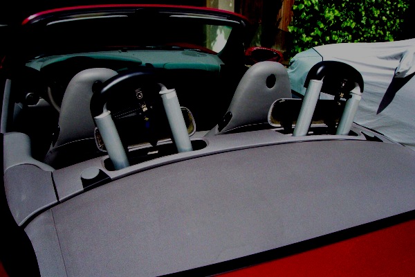

my rollbars popped up
ok now i was driving a little crazy, and my rollbars popped up... now i dont know how to get them down, and my top will only go up half way ... can anyone help me out?

you need to pull out the steel rod out of your tool kit and use the end of the rod to push down on the pin inside of the rollbars (it is between the roll bar) Push down on the pin and the rollbar at the same time until it clicks back into place. Its kind of hard to explain but it is definitely in the manual

Actually it is not if all 4 wheel come off the ground, but if the car experiences negative Gs as when the car goes airborne. There are mechanical pendulum latches that release the spring loaded rollover hoops. The logic is that if the car is airborne, something bad might be happening, and better get ready if the car starts to roll.
There is a record of the event in the EMU, but it is no big deal. Just push the rollover hoops back down in the car as per the instructions in your owners manual, and be done with it. If you are a Girlie Man and have your dealer change your oil, have them erase the event then.

BTW, the picture that Don posted above is of my car when I popped the bars at a DE event 2 years ago. I pushed them back in, and cleared the event memory, and have been just fine.
