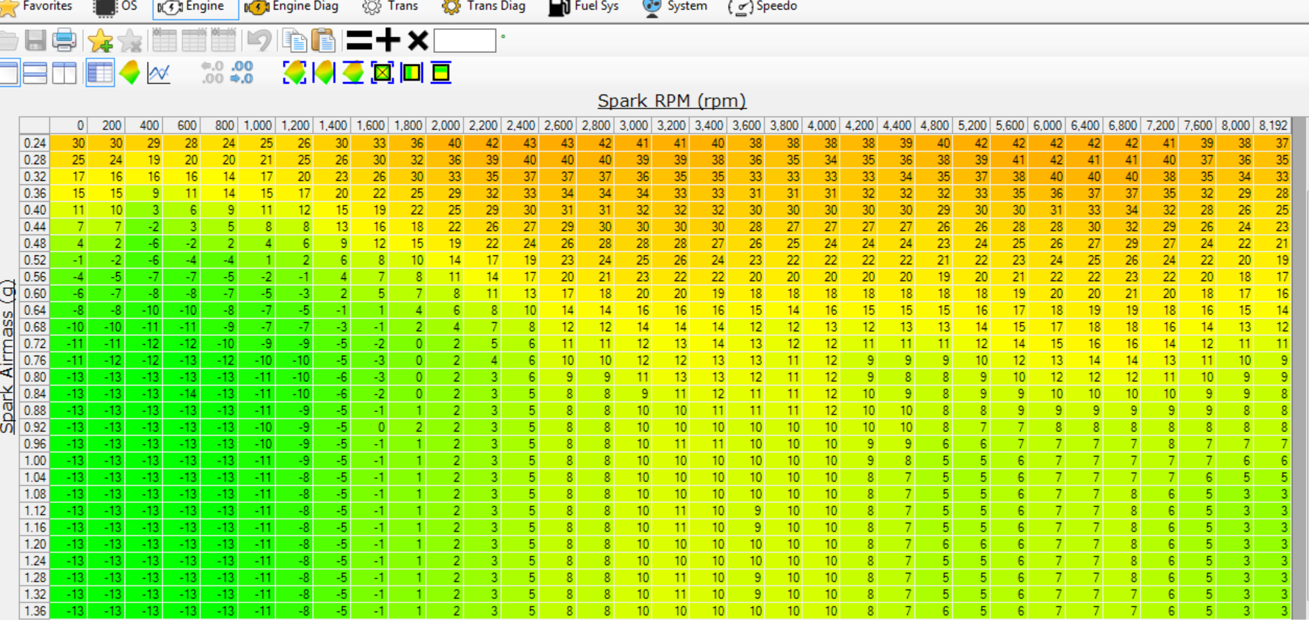

Here are a couple of pics from a different engine (and one that I personally tuned). The top table is the high octane table, the bottom low octane. I had to clip part of the lower air mass rows to get the pic in, but you can match a given spark air mass with a given RPM to see the difference in timing the ECU will use to optimize what you've put in the tank. Bottom line, although it will not harm anything, it is not optimal to have the ECUs constantly responding to knock and constantly reducing timing, living on the lower table.
