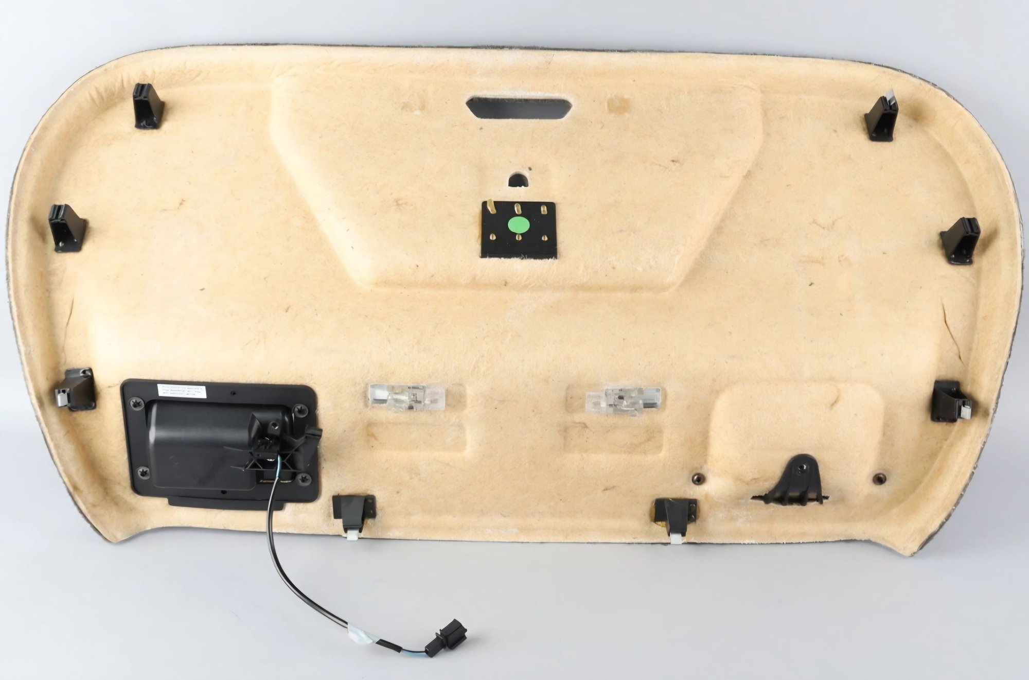

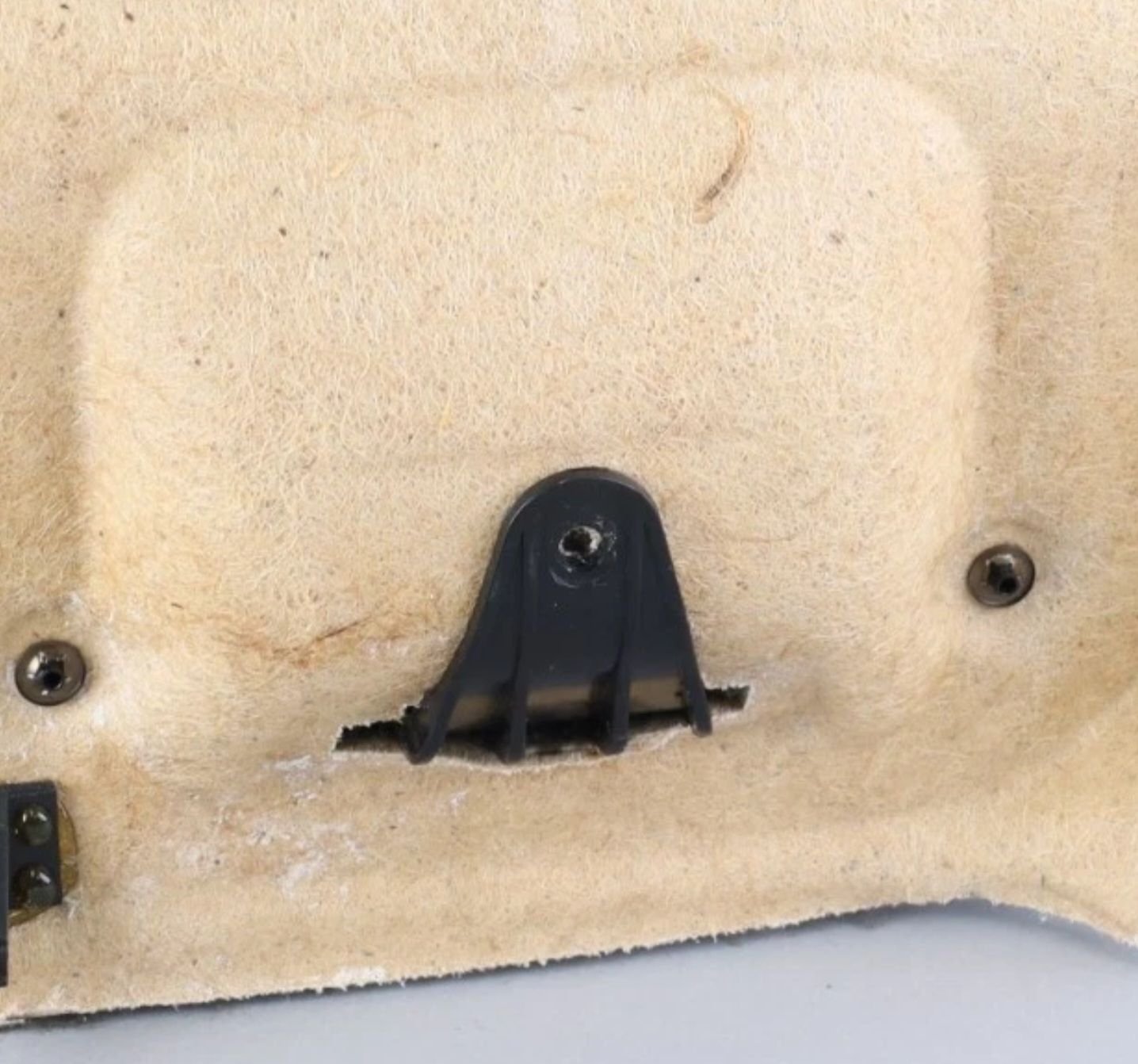

After hunting for the screw behind the pull handle for an hour!!!, I finally removed the panel on the underside of the boot. Purchased a 4 piece trim removal tool set from Amazon....dog chewed one before I'd even used it! I wasn't sure if the clips are supposed to slide off their plastic holder and stay attached to the metal of the boot for removal later, or stay fixed to the plastic bit glued to the material. Seems like it's a mix of the two. I only pulled one plastic bit off, which I can re-glue, but 3 are missing, as per the pic. Are they generic or specific to Bentley? Where can I pick them up from?
Assume you attach all the metal springs (spent 30 mins looking for one on my gravel drive...will be more careful next time) to the plastic holders before pushing the panel back on.
Broke 1, 3 missing. Was definitely time to sort the left drain out.

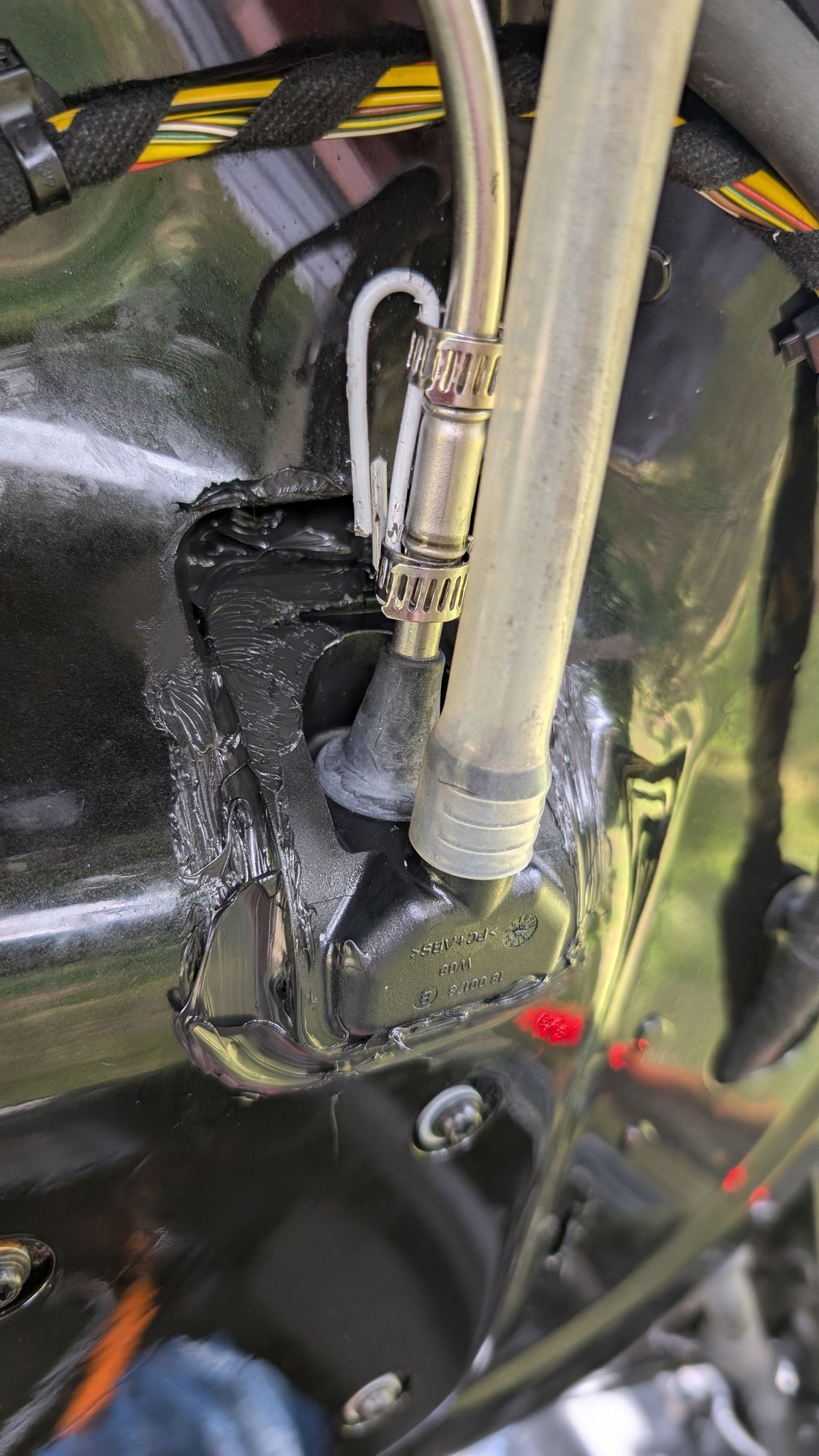

Detached the hose and cleaned out the blocked left drain. Glued and siliconed (first time doing this) the left plastic 'funnel'. Siliconed the right one for good measure.
Oiled the spoiler mechanism so I could move it by hand. Removed spoiler motor and broken plastic bits. Did the bent length of wire and clamps fix. It worked!!!! My fist repair on the car. I'm sou proud of myself and so very grateful to all of you that have gone before me and taken the time to post your learnings. I'm no mechanic, so if I can do this, so can you.
OK, so not the best with the silicone gin, but it will do the trick.
OK, so not the best with the silicone gun, but it will do the trick.
I still can't find the drain hole under the spoiler....but for now they both work.

You will not see the drain hole under the spoiler, as the the hole is the funnel itself that you put back in place, you can see from my pics with the spoiler and mechanism removed, that opening on each side is where the water goes into the bootlid, which then goes to the funnels.
