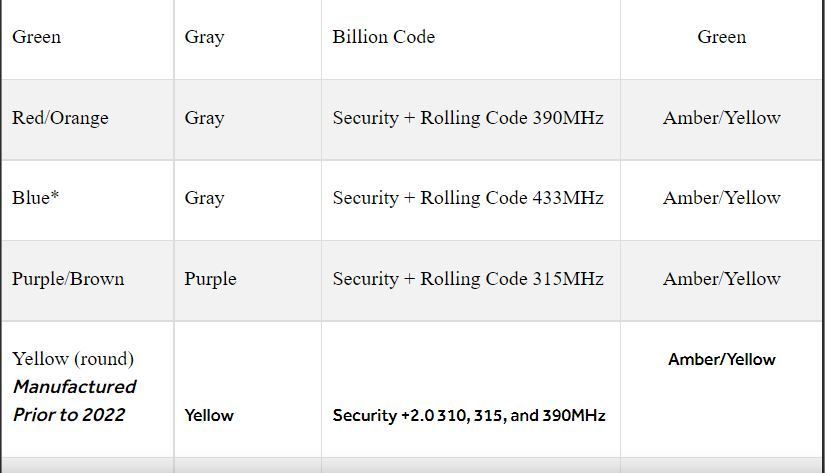

Most of the LiftMaster units are rolling codes. There is quite a bit of difference in how different models accept programming and on which frequency they operate. This is determined by the model, the color of the learn / programming button and the type of wired / physical opener you have in the garage. It is important to know what LiftMaster technology you are dealing with before attempting to program.
I have never been able to successfully use the method you described of pointing the hand held wireless LiftMaster opener at the car's receiver. Generally programming will require clearing any previous programming in the car, several steps to get the car ready to program, then pressing the learn button on either the LiftMaster opener mechanism itself or the wired panel in your garage and then pressing the button in the car you want to program for that door opener. I've provided a list of Button Colors below as well as examples of one of the openers I have. When you get the car back, let me know and possibly I will have mine along with my notes and be able to help you get this setup. In the meantime figure out what specific model opener and wired control panel you have.
BTW We have 3 different LiftMaster models / generations built between 2005 and 2018 and all of them require a different process to connect to different vehicles.

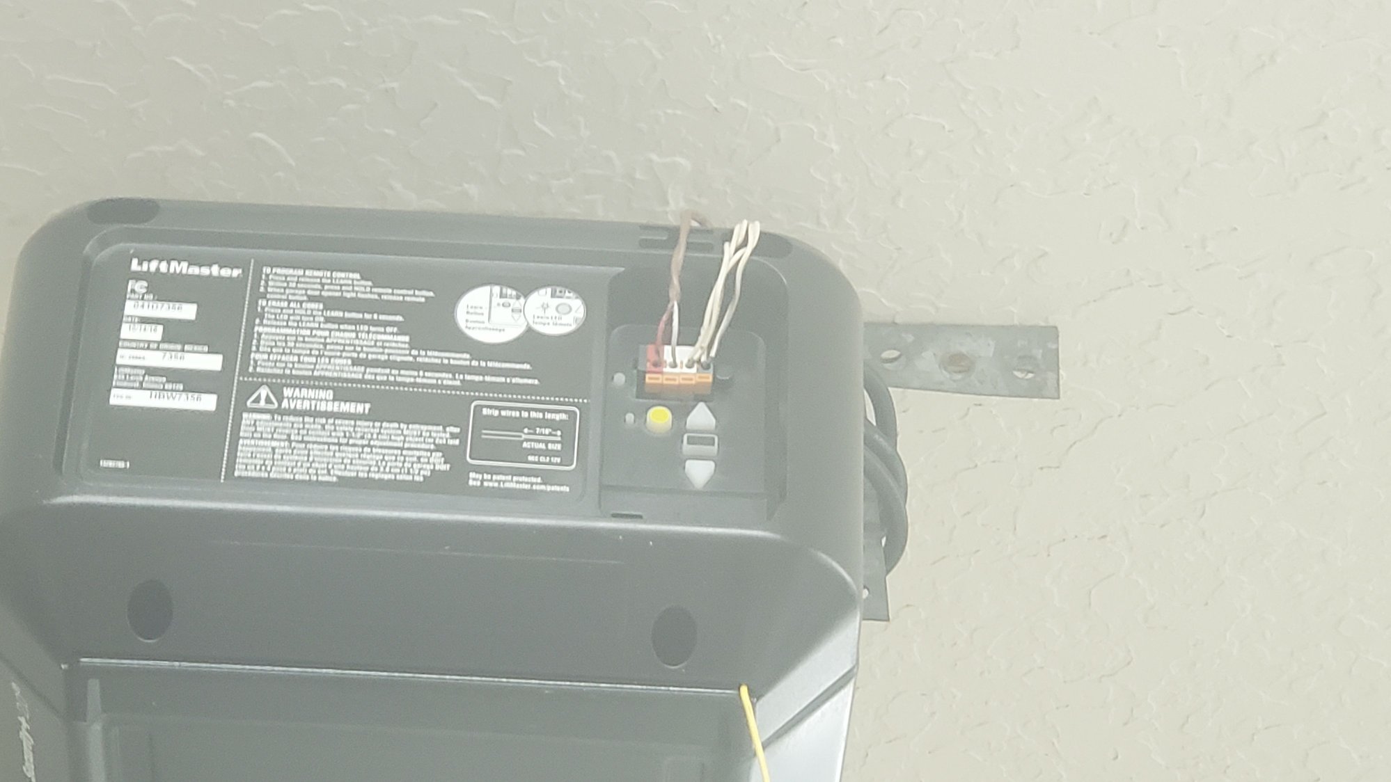

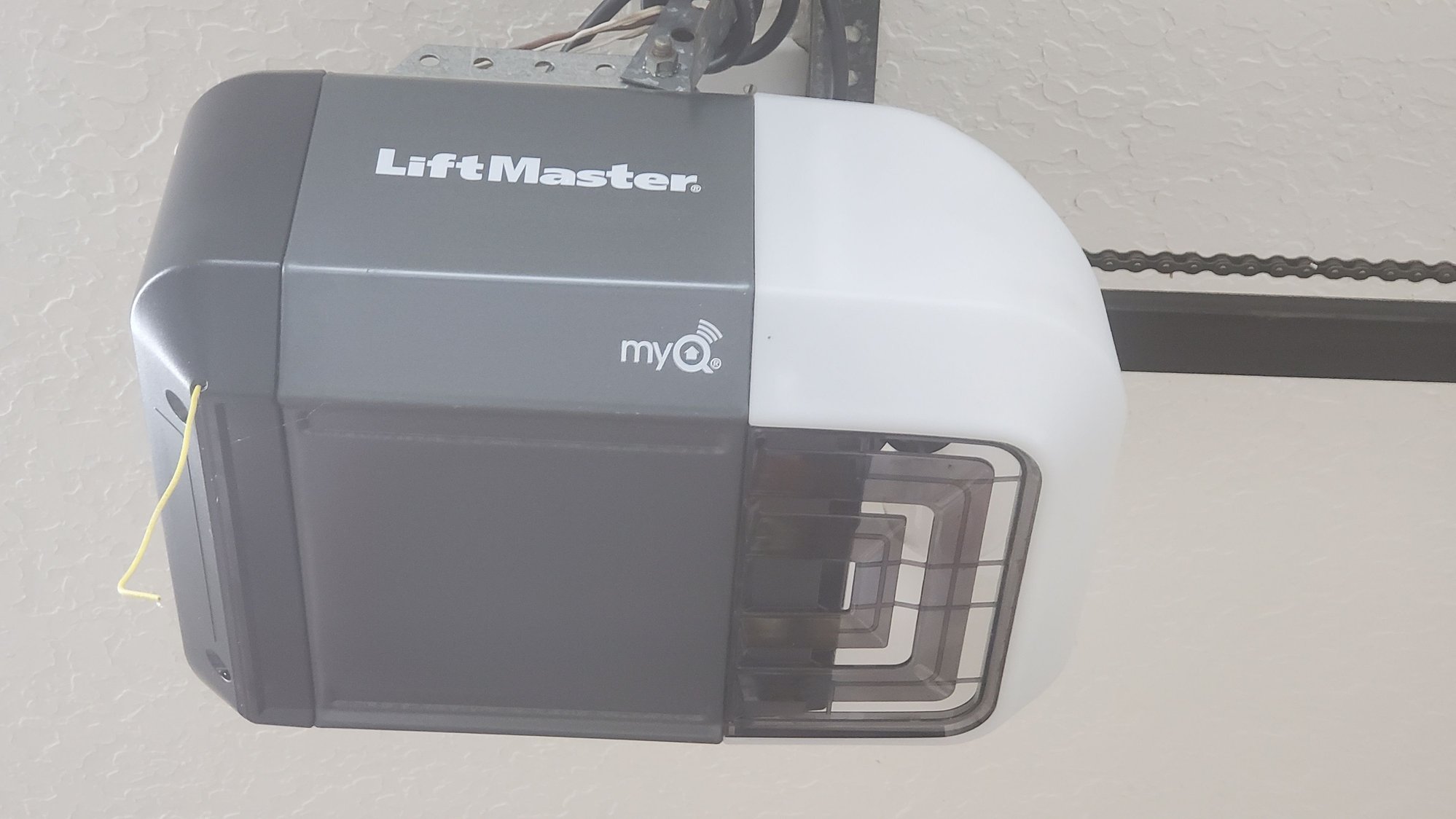

This pic shows the opener and the logo on the side indicates it is MY-Q compatible. This means the unit is able to be configured to use LiftMaster My-Q Smartphone App (using the add on 828LM Internet gateway) to operate the door from your smart phone. I find this very useful in letting people in, receiving deliveries when I'm not home and in general knowing when my garage doors are opened or closed.
This pic shows the back panel of the opener with the model and serial number (important) along with the round yellow programming button indicating is Security + 2.0 and can operate on 315 or 390mhz

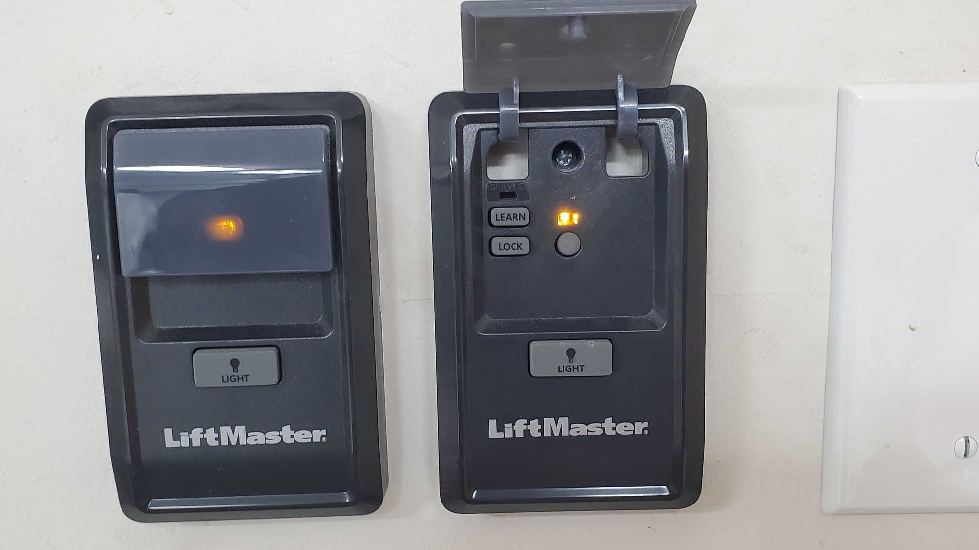

This pic shows that this opener also has the more recent wired control panel which has a built in learn button allowing you to press "learn" without having to climb up a ladder and push the button on the back of the opener itself.
