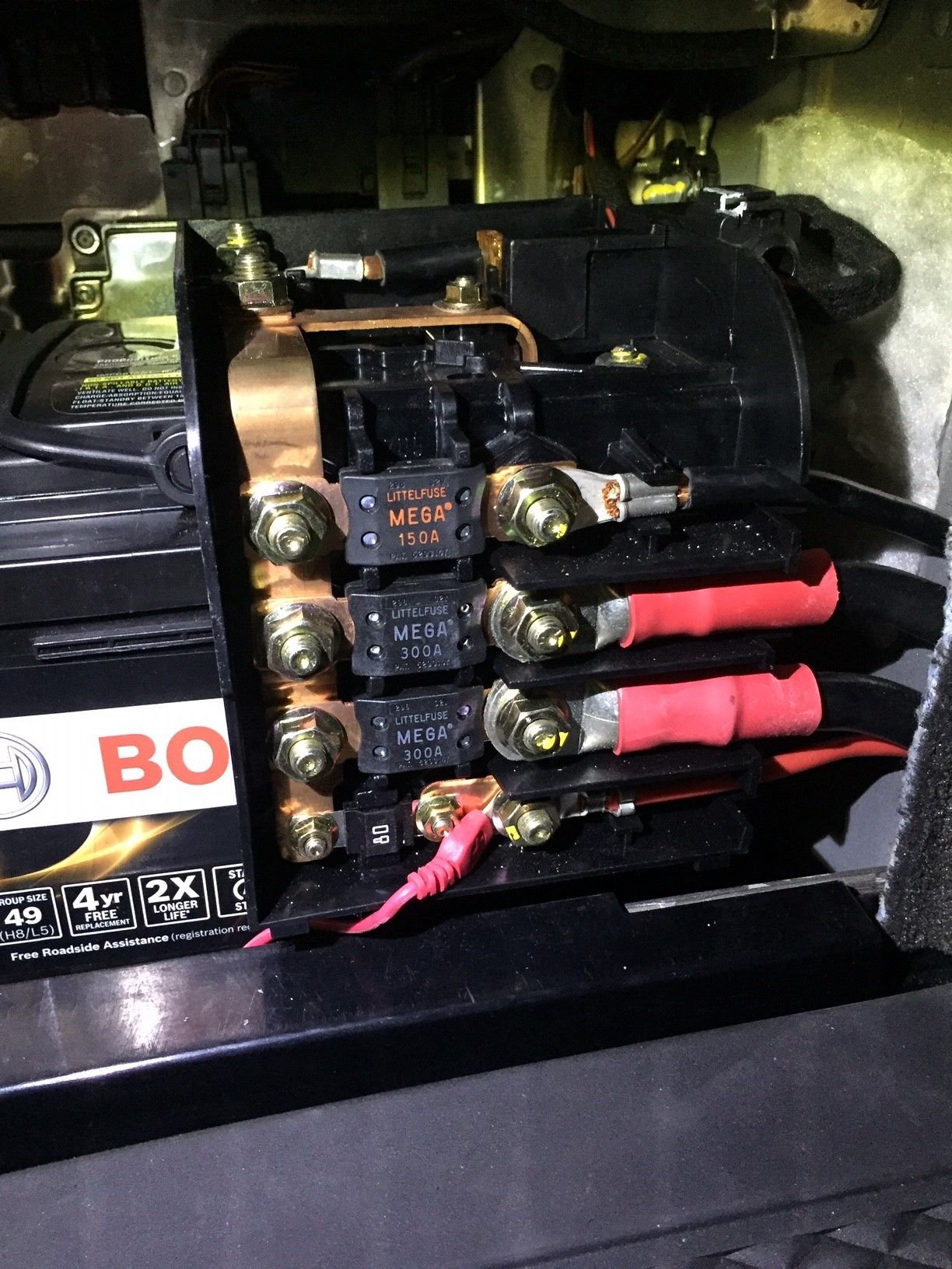

Remember guys, there are two completely independent electrical circuits at play here. When the key (or push button) is used to start the car, the starter battery (which is isolated from the main battery) is used to start the car. Since you can start the car this would tell me that the starter circuit is probably in tact. Probably the pyro device too. Then, when the key (or button) is released, the starter electrical circuit shuts down and the main battery circuit then continues to "feed" all the systems including the ECUs. Something on the main battery side is failing to keep the systems running.
I suggested checking all of the main fuses. These are the simplest items to check and gets them out of the way. They are located at the main battery (pic below). If you know how to do a continuity check, do that for these 4 fuses across the line and feed sides. If all is good there, then you need to move to other possibilities which are endless and the guessing gets more creative at that point.
I personally wouldn't spend much time on the kessy. This would be a pretty low probability if the Kessy module became corrupted. Anything is possible, but probabilities have to play a part here.

Trust me I know I goofed up on removing the batteries lol. But yes the correct procedure was use to remove the batteries per the Bentley workbook I purchased. No pryo was discharged and at all. I have not been able to have the codes read yet, due to the fact that I can not get the car in neutral to get it out the garage and to a shop.
So overall I need advice on finding the neutral safety switch and if anyone know how to test the fuse on the batter cable hook up.
B Wing
I will look into this. Any advice on how to check these fuses?

I specified that in my post. Do a continuity check line to feed (or both exposed ends of the fuse). If you do not have a meter a simple battery powered continuity test light will work. One lead on one side of the fuse, the other lead on the opposite. If the light lights then the fuse is good.
