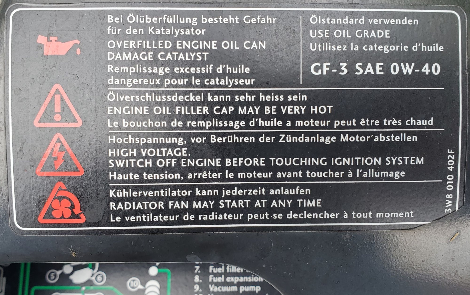

Old Aug 22, 2021 | 12:43 PM
Johnny Hotspur GT's Avatar
Administrator
Joined: Jul 2014
Posts: 3,946
From: Montgomery NJ
Rep Power: 1002
Johnny Hotspur GT Is a GOD !Johnny Hotspur GT Is a GOD !Johnny Hotspur GT Is a GOD !Johnny Hotspur GT Is a GOD !Johnny Hotspur GT Is a GOD !Johnny Hotspur GT Is a GOD !Johnny Hotspur GT Is a GOD !Johnny Hotspur GT Is a GOD !Johnny Hotspur GT Is a GOD !Johnny Hotspur GT Is a GOD !Johnny Hotspur GT Is a GOD !
Hello @Jero_b ,
Were you ever able to locate the label for the oil specs on your Bentayga ?
Like this sticker on my GT.
Like #12 for the many different markets.
https://www.scuderiacarparts.com/par...338/2091/36801
