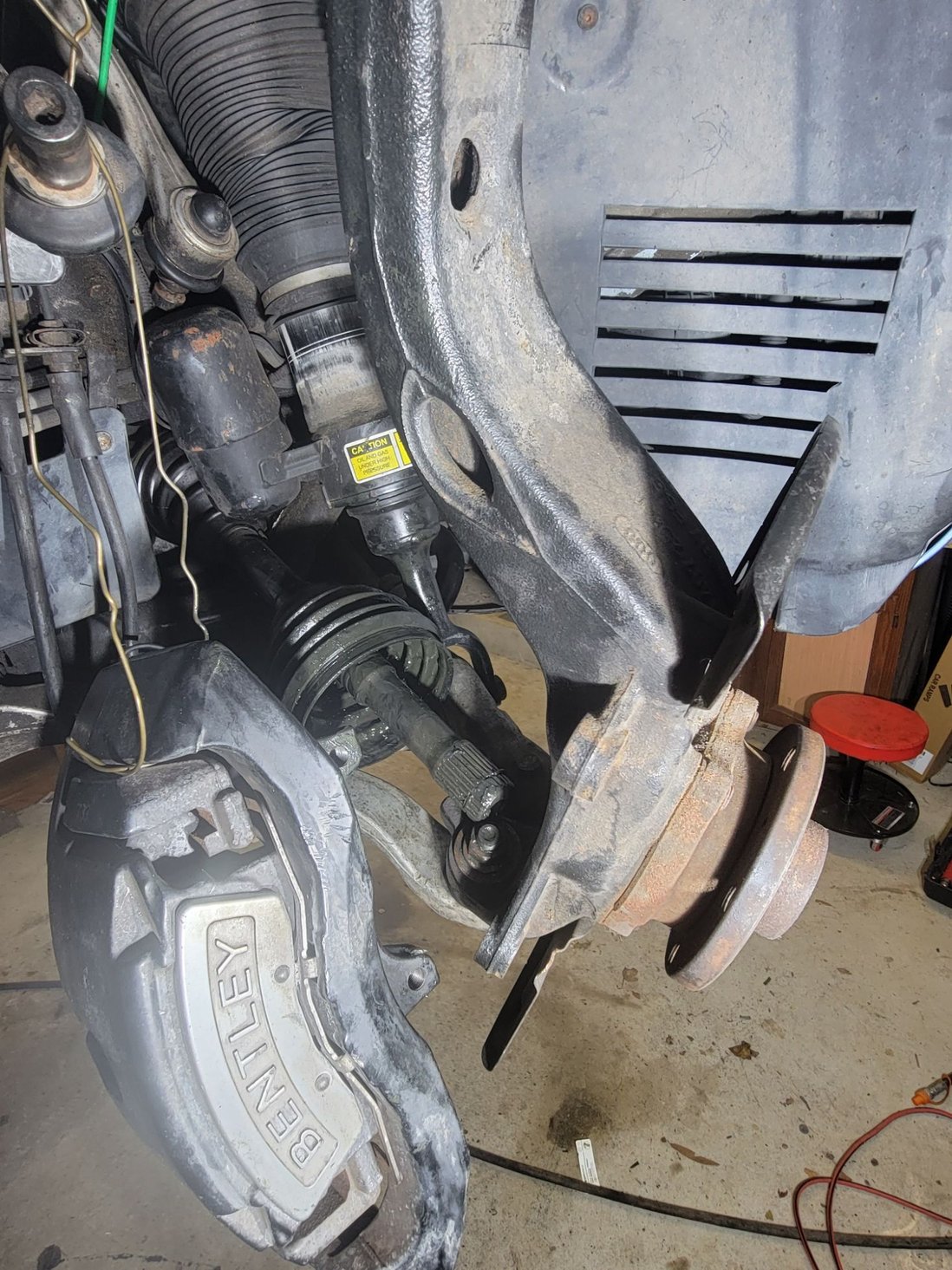

My ‘06 Spur (35k) has a failing front right wheel bearing. I found new hub/bearing assemblies and once I removed the rotor, etc, I found that the bolts that hold the assembly on are impossible to get to with my socket set - they are blocked by the knuckle.
So my question is to anyone who’s done this R/R - how do you get to those bolts?

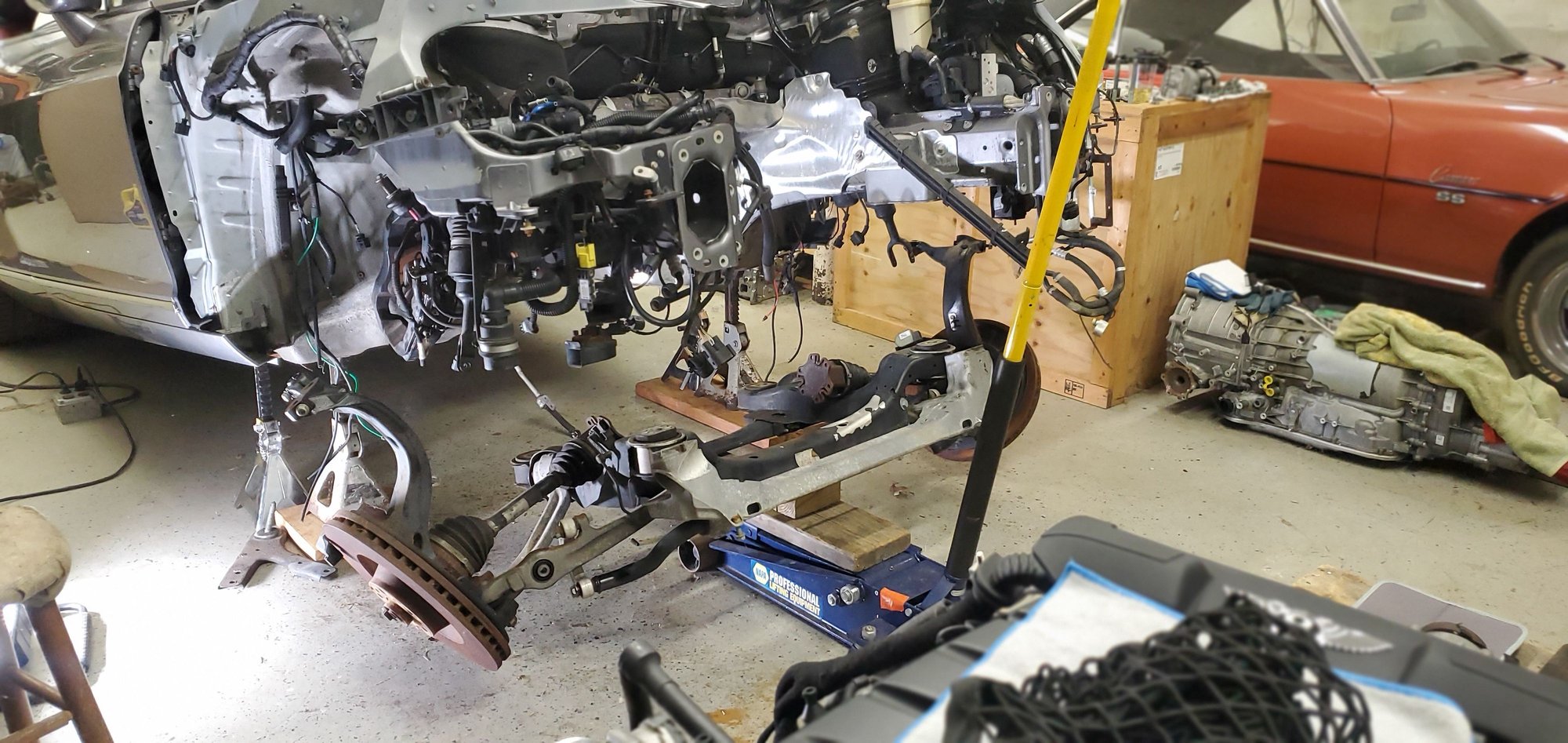

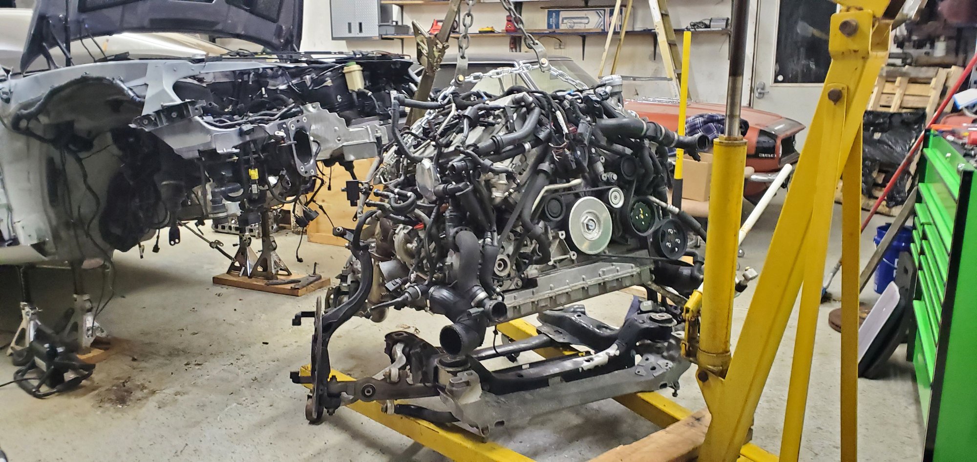

Otherwise you will have a hell of a time as I did braking that bolt loose while doing the job of changing out the hub assemblies during my GT rebuild, I had my sub-frame on the ground though. 😀

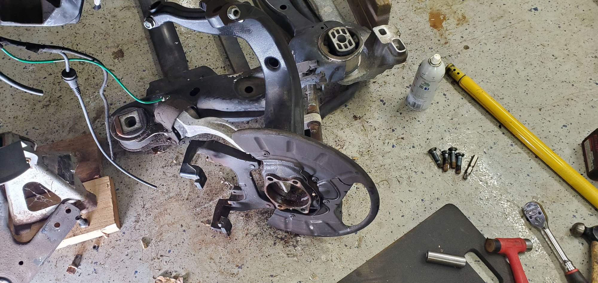

@notwise ,

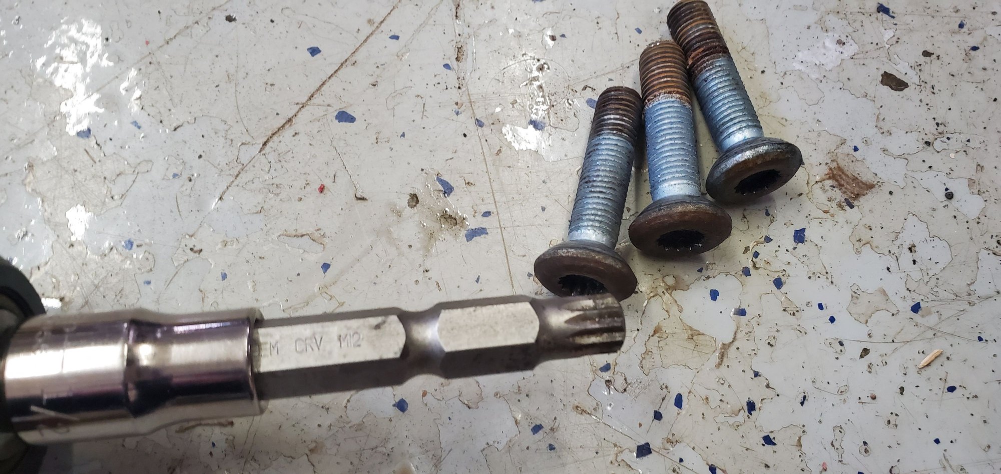

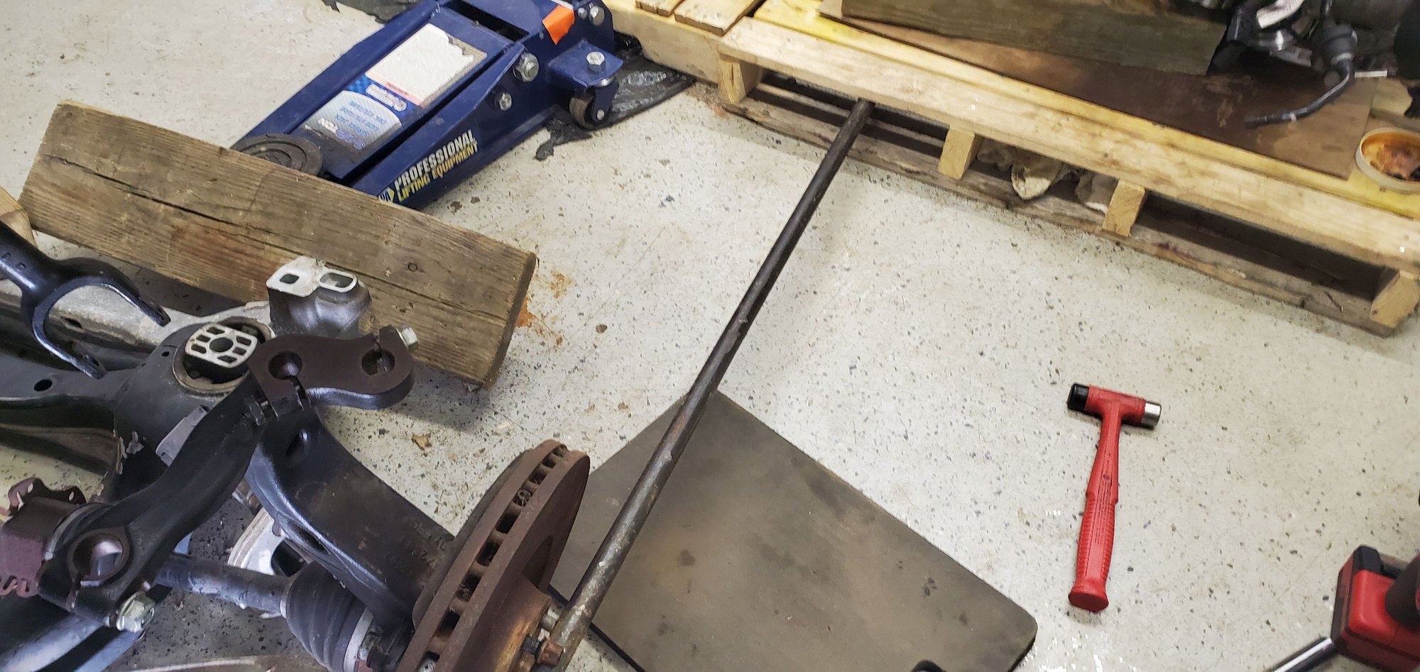

I tried a 3/4" drive impact gun on both the Bentley and my Audi A8L W12, no go, I just recently lost the passenger front axle right out of the transmission on the A8L , the outer CV joint broke at speed, and the axle flew out taking the output shaft right out of the transmission...
So, it took the1/2" drive breaker bar shown in the picture, along with a 4' piece of pipe for leverage, I actually stood on it.

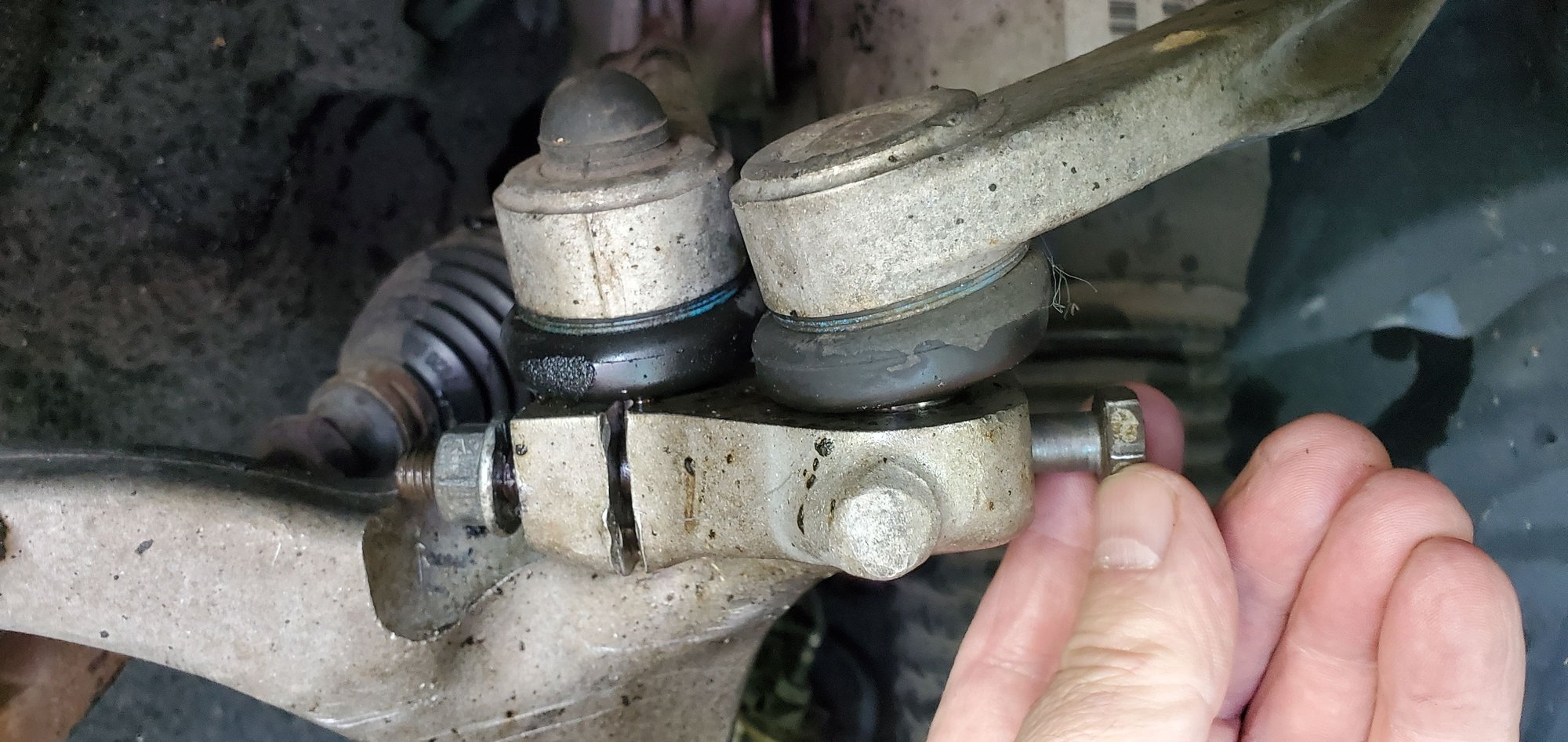

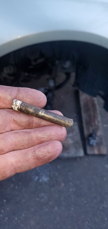

Then on top of that headache, the pinch bolt snapped, a little drilling and drive punching drove it out.
Good luck tomorrow !!

Right side.. done and dusted! Needed a 24" breaker bar for the driveshaft bolt - disconcerting to be putting that level of force, but it came loose. Thank you for the expert guidance. Now for the left side. What can go wrong?

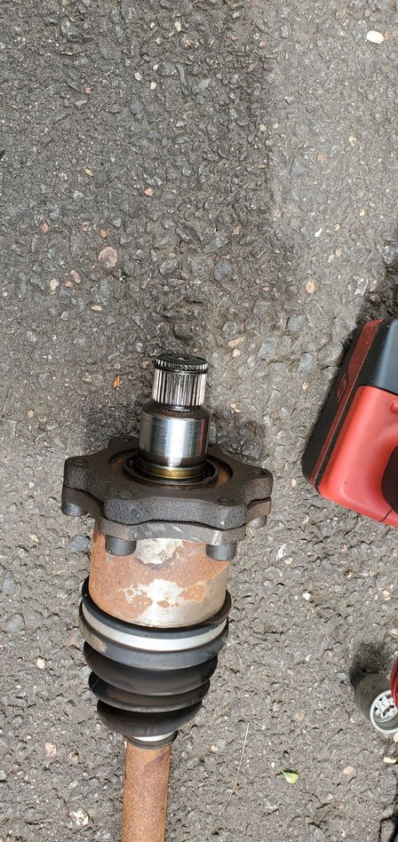

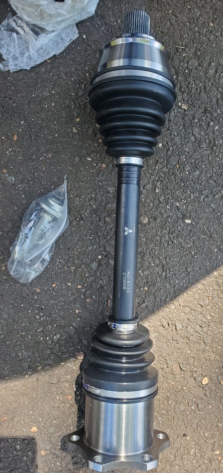

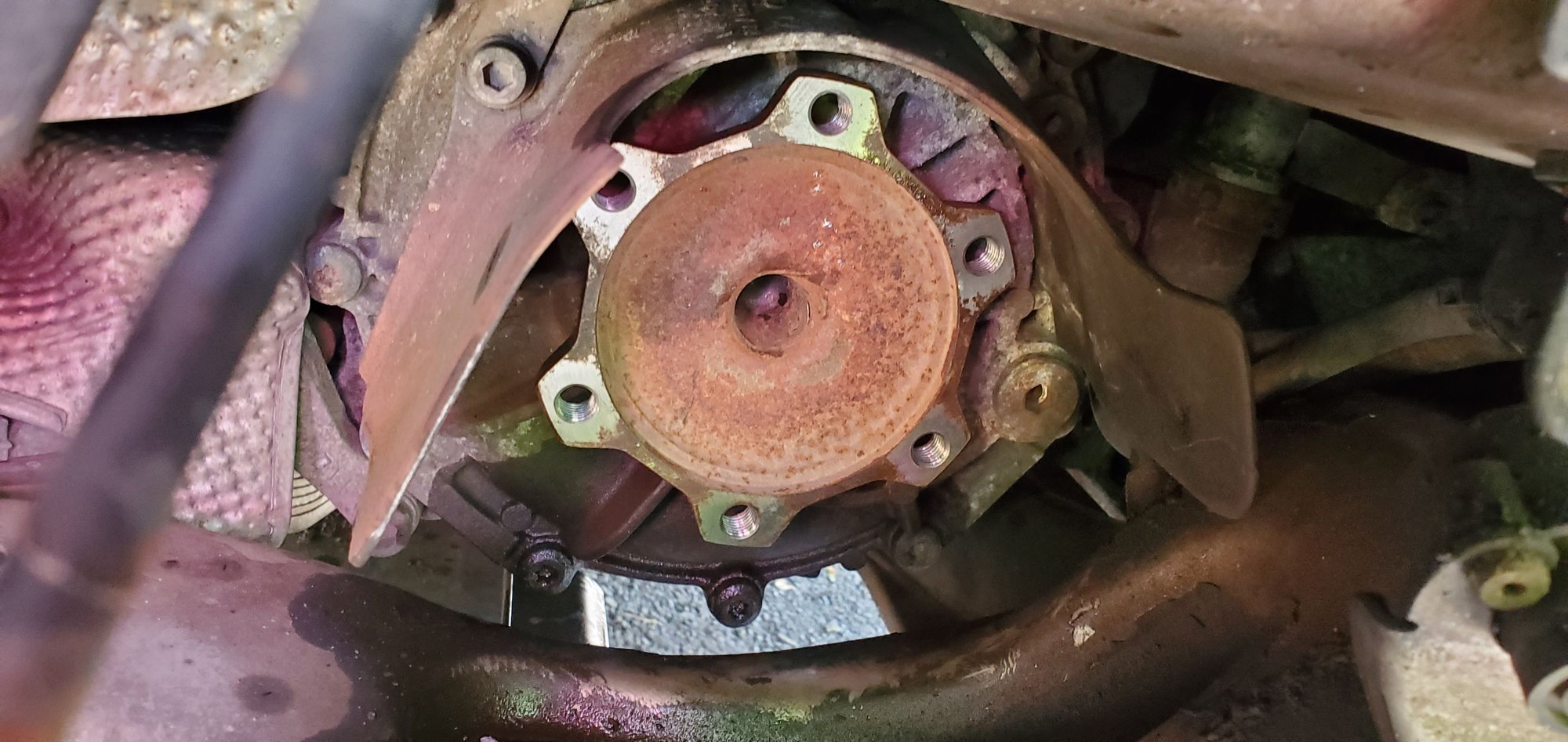

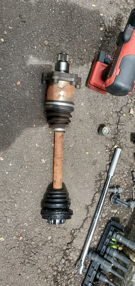

Got my axle off last night. Tried 25" breaker bar with 5ft extension and no go. Sheared the socket instead. Then, as last resort, I applied a little heat using my acetylene welder together with my impact driver and it came off. These bolts are no fun to remove
Old Aug 22, 2021 | 07:17 AM
Zaos's Avatar
Joined: Nov 2014
Posts: 192
From: Belford, NJ
Rep Power: 42
Zaos has a reputation beyond reputeZaos has a reputation beyond reputeZaos has a reputation beyond reputeZaos has a reputation beyond reputeZaos has a reputation beyond reputeZaos has a reputation beyond reputeZaos has a reputation beyond reputeZaos has a reputation beyond reputeZaos has a reputation beyond reputeZaos has a reputation beyond reputeZaos has a reputation beyond repute

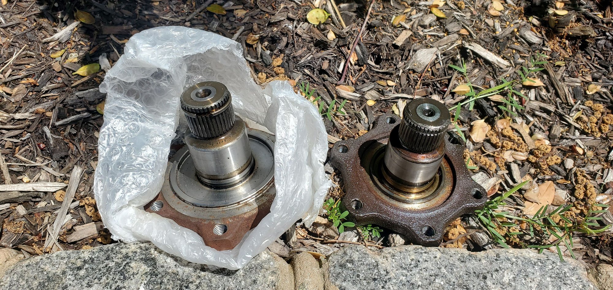

Bearings were rattling lose inside boot
CV shaft broken lose
My new favorite tool
The dreaded center bolt

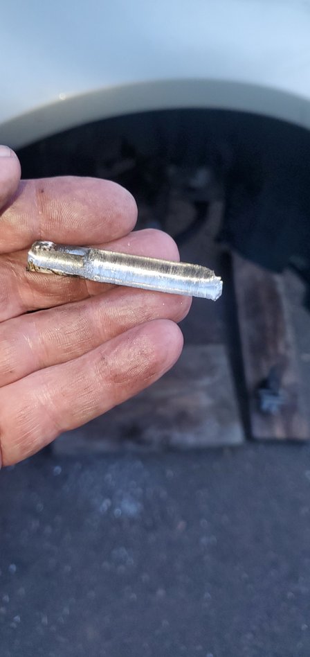

Used screwdriver trick instead while removing center bolt
1/2" impact gun did the job, together with carefully applying some heat and not mess up wheel bearing. Actually, there was no other choice.
