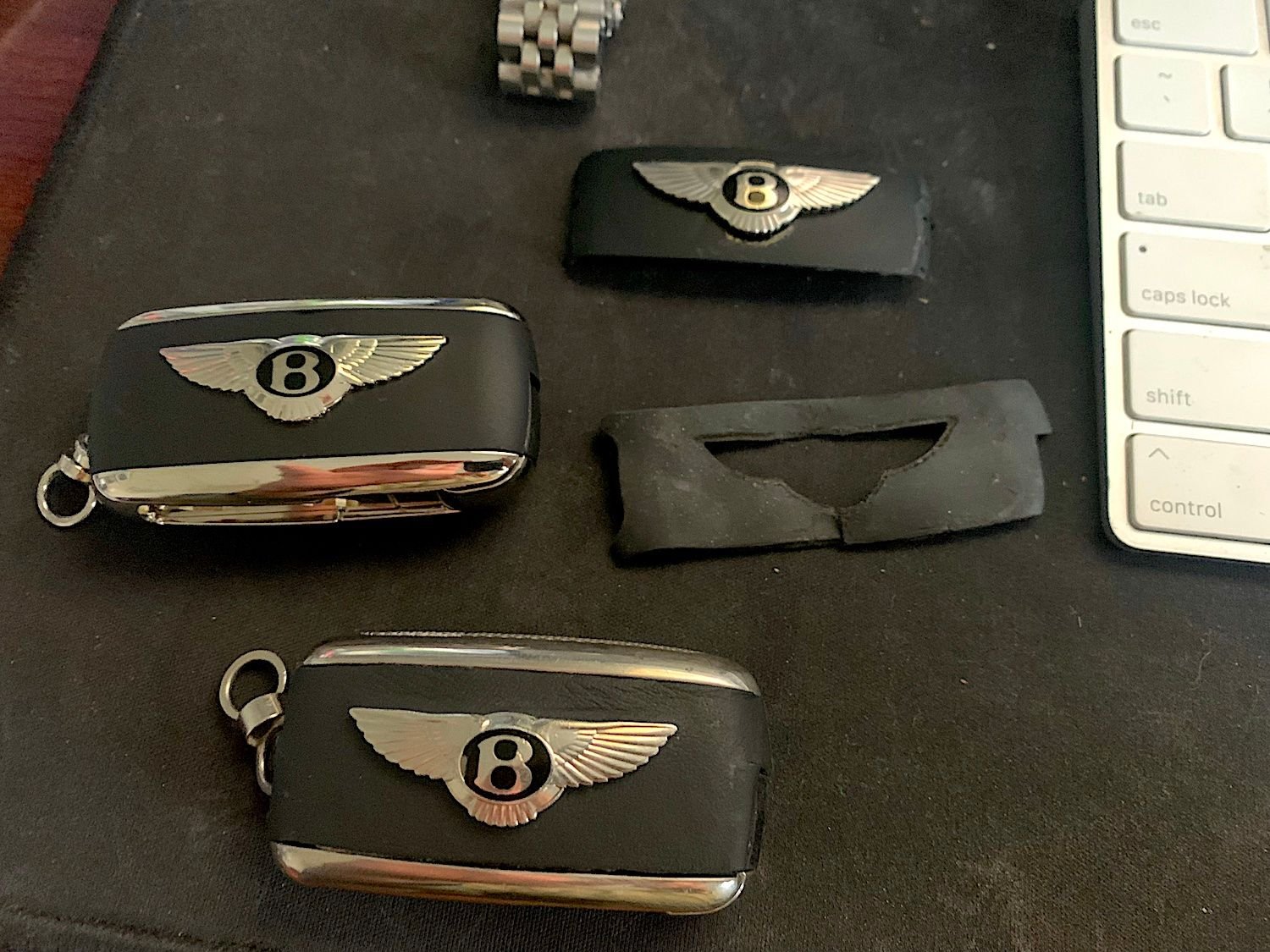

And the results of some experimentation.
At 12 o'clock is the oem key battery cover with the worn out rubber peeled off and at now at the 3 o'clock position.
At 6 o'clock is an old key, with the rubber replaced with a piece of Bentley leather from an oem steering wheel I'm getting recovered to match. Sprayed the back of the leather with formula 77, laid on the plastic, then cut with scissors and used an exacto knife to make the badge tab slots. 5 minute job. Could probably trim a bit more carefully next time for a perfect fit. Wish I had some saddle leather to match the keys to the interior. I do have the dye, but don't think it will cover black.
At 9 o'clock is the replacement ebay key. The ebay key has a matte textured plastic that looks like rubber, but appears to be more durable, harder and not soft. One other note is that the Bentley flying wings badge on the ebay key is different. (10 feathers on OEM on right side vs. 9 on the 'copy')
The badge comes off by opening the metal tabs on the back of the battery cover. You can also see the freshly cut key blank just above it on the ebay key. $35 to cut and works a charm.
