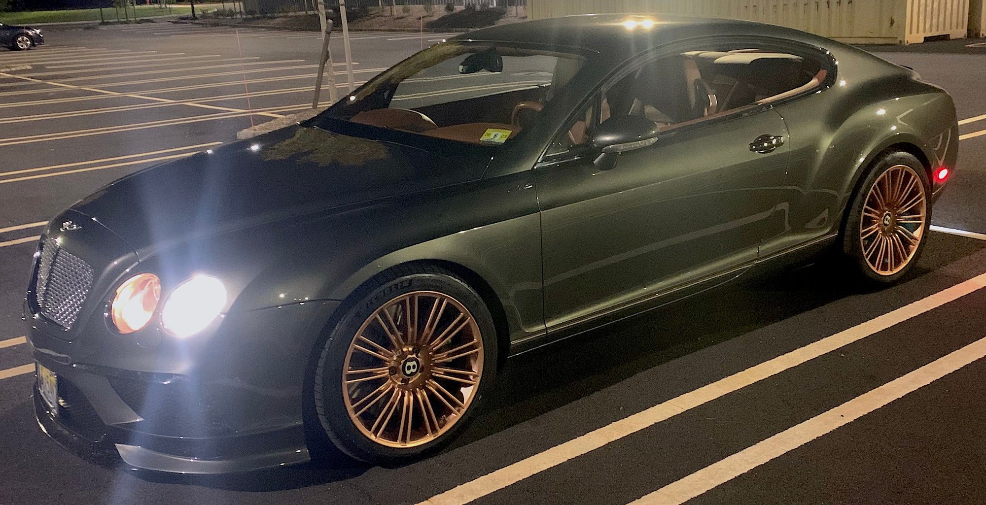

Put some 25mm spacers on the rear and 20mm on the front, with ET41 9.5" wheels. (Both spacers are H&R Trak+ DRA type - these bolt to the rotor/hub with bolts that come with the spacers and the stock wheel bolts are used to mount the wheel to these spacers.) No rubbing so far, and I did some hard braking and turns, so seems OK with the recommended 275/35/20 tires. No wobble or anything, but I was only able to go 60-70mph around town, so we'll see how they do on the highway.
Will probably bring the rear down another 1/3" but keeping the front where it is so that I can go in/out of my steep driveway without the ridiculously low aftermarket front bumper lip scraping. Pretty darn close to flush and glad to take some pictures with a straight edge against the fender, if anyone needs.
The wider 1.5" front and 2" rear track also seem to provide the car with some added cornering stability.
Please excuse the missing bolt covers, as I have to retighten the wheel and spacer bolts after 60 miles.

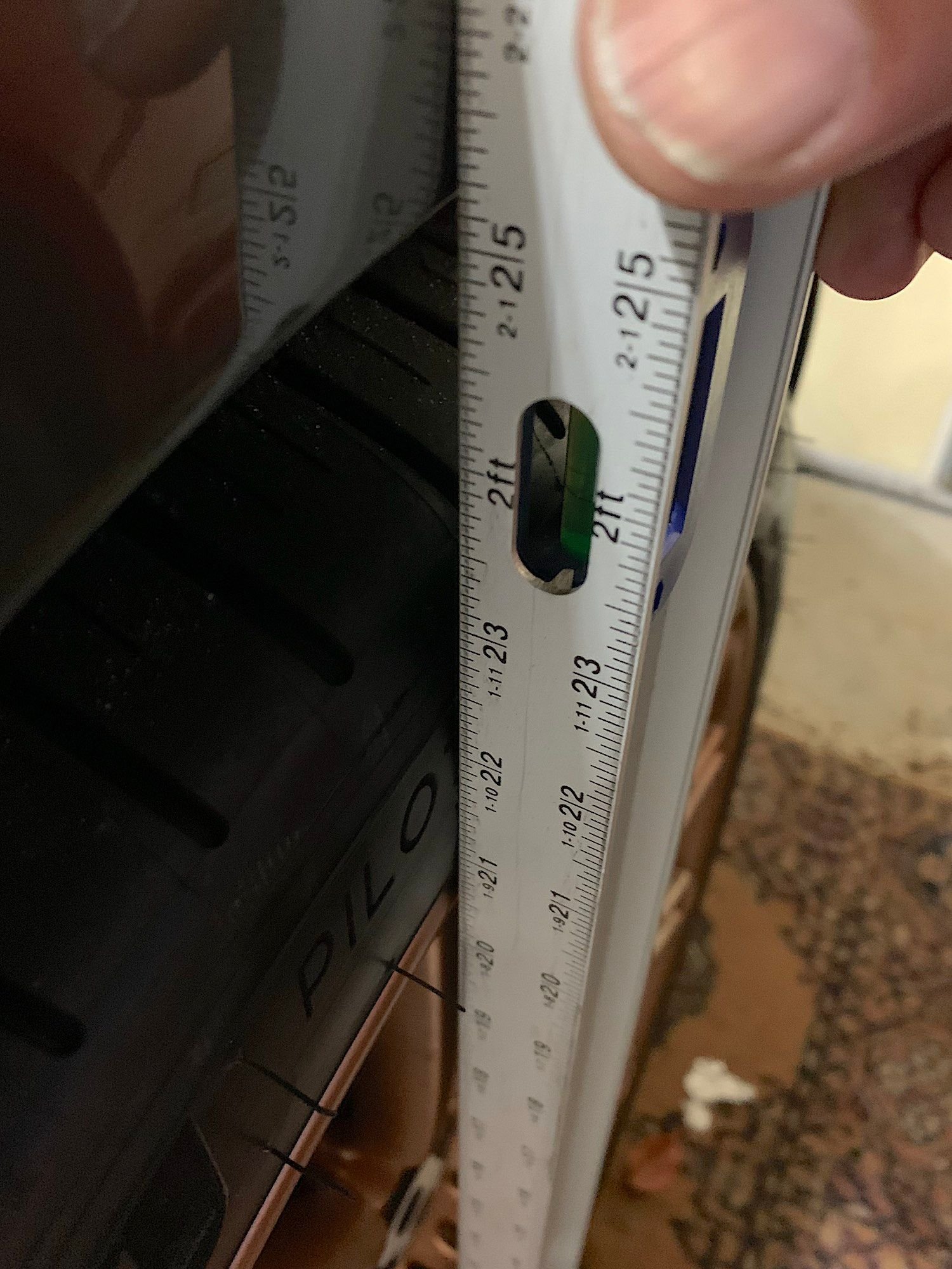

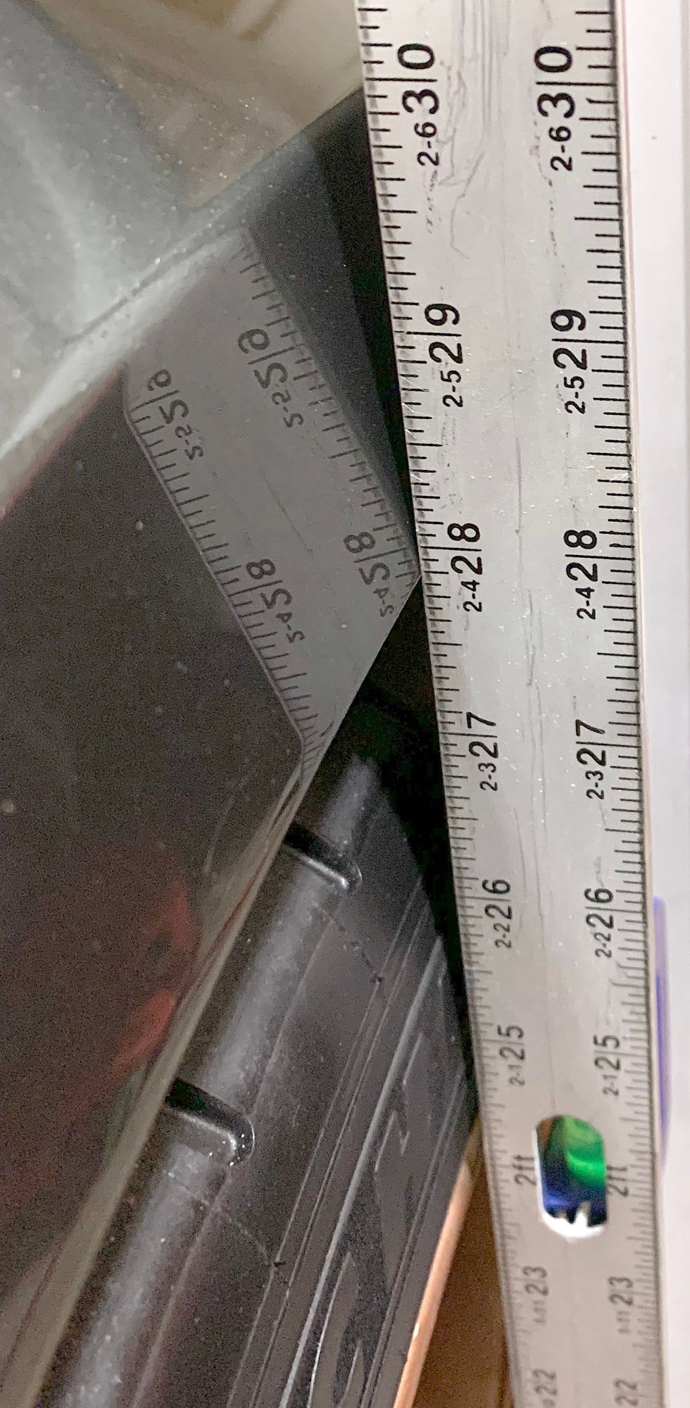

Also, just so folks know this will extend beyond the inner fender, below are some pics. For those folks wanting clearance here, which would be good insurance if the air struts fail, this offset is too 'extreme'. For the front, the fattest part of the tire is about 1mm shy of the outer fender surface. Looks more than 1mm in the picture, but the shadows are playing tricks here.
Front clearance
For the rear, the fattest part of the tire is actually about 1mm proud of the outside surface of the fender.
Rear Clearance
