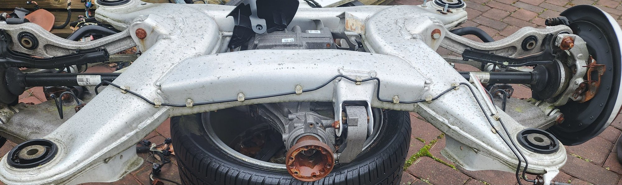

Hi,
This is probably a question that needs to go straight to Johnny, but my engine and differential mount bushings are now bad, 20 years and it's time for new bushings. The engine mounts are obtainable but crazy expensive ($1,000 ea) but the differential bushing is now unobtainium.
the only bad part is the rubber bushing; can I simply take a used part to a machine shop and have them replace the bushing with something generic? I mean rubber is rubber is probably not rubber but still, a mount is a pretty simple concept? I can buy a used part for less than $50 but I don't want to change a worn-out one for a worn-out one.
The part number is 3d0599125e and Scudera doesn't carry it, it is "post VAG" which doesn't make a lot of sense. It's listed everywhere for the Phaeton, but I don't think it really exists in that realm either.
I'm tempted to buy one, take it to a machine shop and see what they can do.

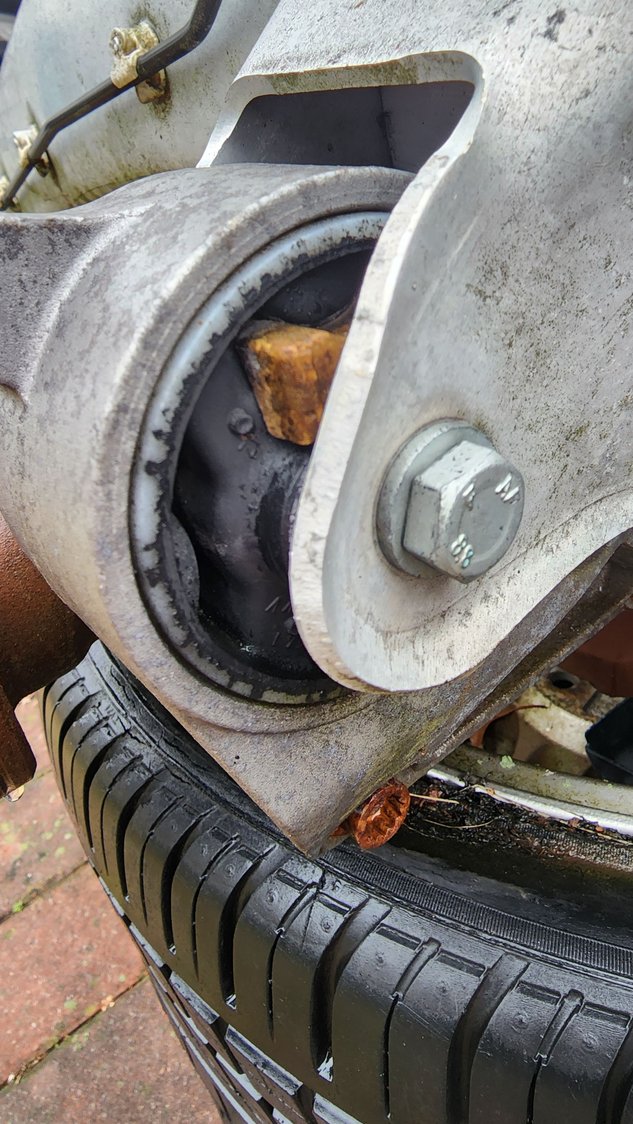

I believe this is the bushing you are looking for, and yes, these can be pressed out and replaced using the original housing.
Audi VW Differential Bushing – Rear 8E0599381B Genuine VW/Audi 8E0599381B (eeuroparts.com)
I've done several of these Lemforder bushings on other Euro car suspensions where the aluminum housings are perfectly good, just the bushing wears. And typically, the whole arm or backet with a new bushing is astronomically expensive.
On these bushings I purchased a floor press from Harbor Freight (nothing in cost), pressed out the old bushing and pressed in the new one. I first refrigerated (doesn't need the freezer) the new bushing (24 hrs) so it presses in more easily. I don't see a big issue in your pic with press in depth, but I would just use a micrometer depth gauge and measure the bushing housing from the bracket housing and press in that same depth.

I have the differential mount available used with only 10k miles, but I wouldn't want to remove it from the complete rear subframe assembly I have, not for $50 🤑, especially when you can get the bushing for about $30, see screenshots.
As to the engine mounts, I do have both electrical mounts available, they have about 10K miles on them, I can get pictures of them later today if you are interested.
