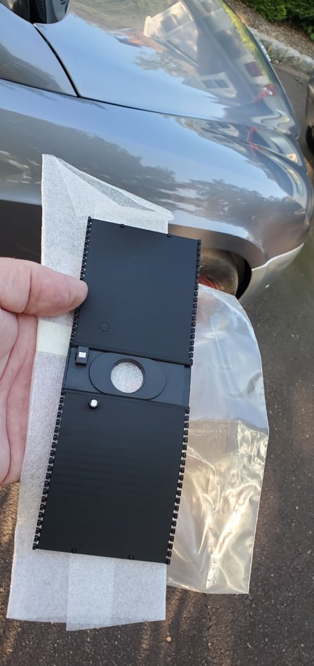

@DR3ADKN0T ,
Do you have any issues with the shifter gate dust cover, and it's magnets ?
Johnny

@DR3ADKN0T ,
if the dust cover is damaged, as in broken in half, with the front portion stuck up in the slider section, and the same for the rear portion, stuck in the slider towards the rear, then the magnets can not do their job of of sport mode, or proper manual shifting.
Please be sure when you replace the cover, that you make sure that the white piece shown in my pictures is properly seated on the shifter gate housing, my second hand shifter assembly had the cover brake after a few test drives during my rebuild, it would click every once in a while, and other times smooth, turned out that the white piece was hitting and catching the bottom of the cover.
Johnny

Thanks for the photos. Last time I tied to install it I wasnt able to get the shifter **** off.
