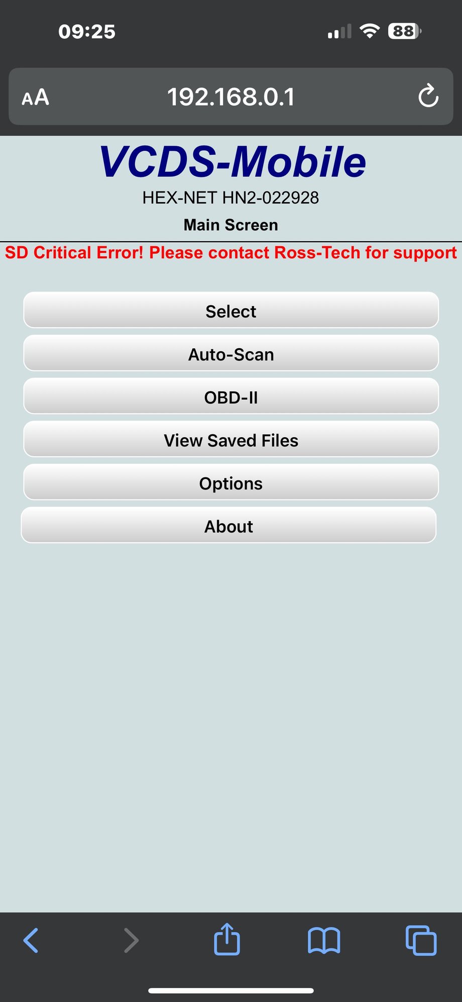

Hello Folks,
When it cools down a bit I am going to scan with a HEX-NET using VCDS Mobile. Anything to know or for which to look?

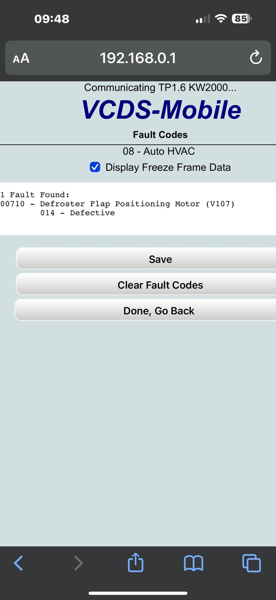

robob has much to be proud ofrobob has much to be proud ofrobob has much to be proud ofrobob has much to be proud ofrobob has much to be proud ofrobob has much to be proud ofrobob has much to be proud ofrobob has much to be proud of

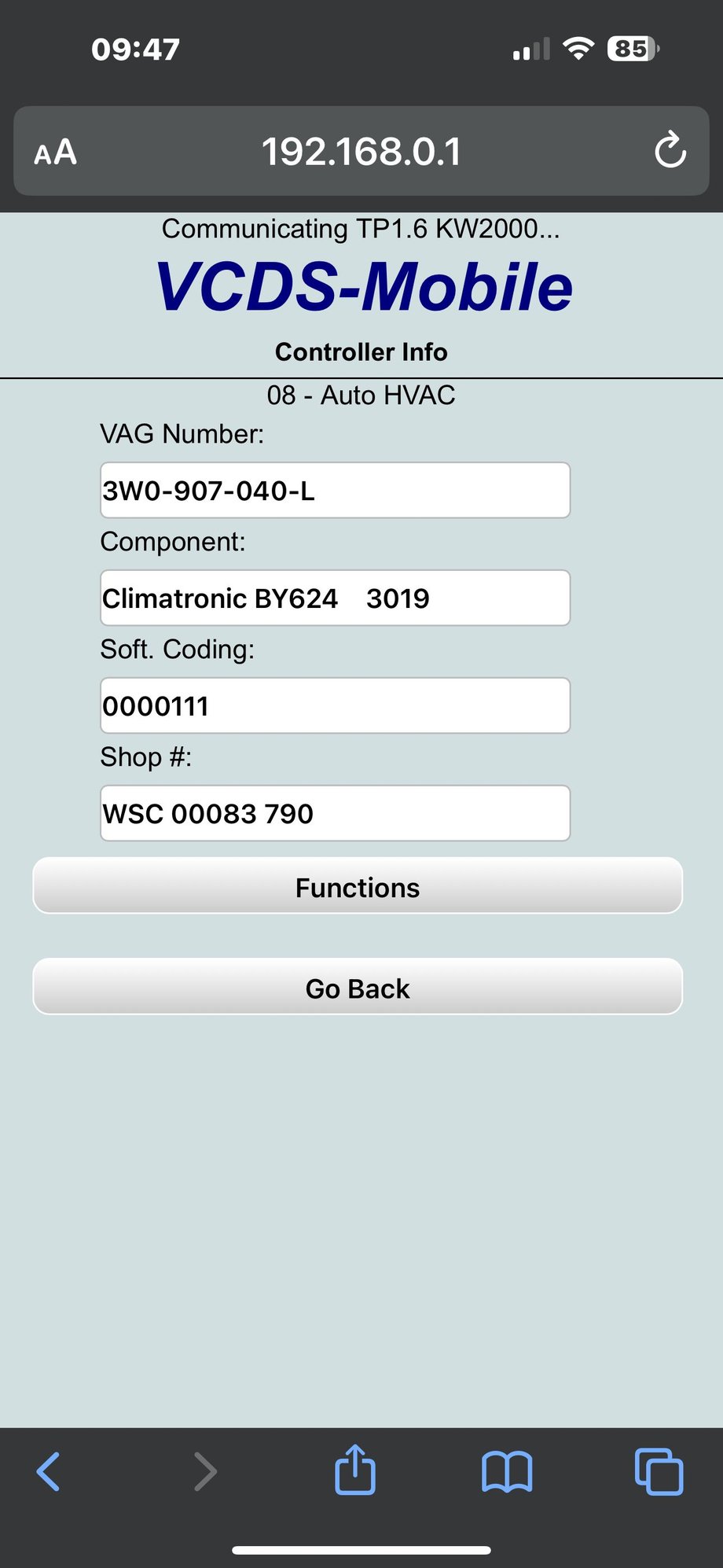

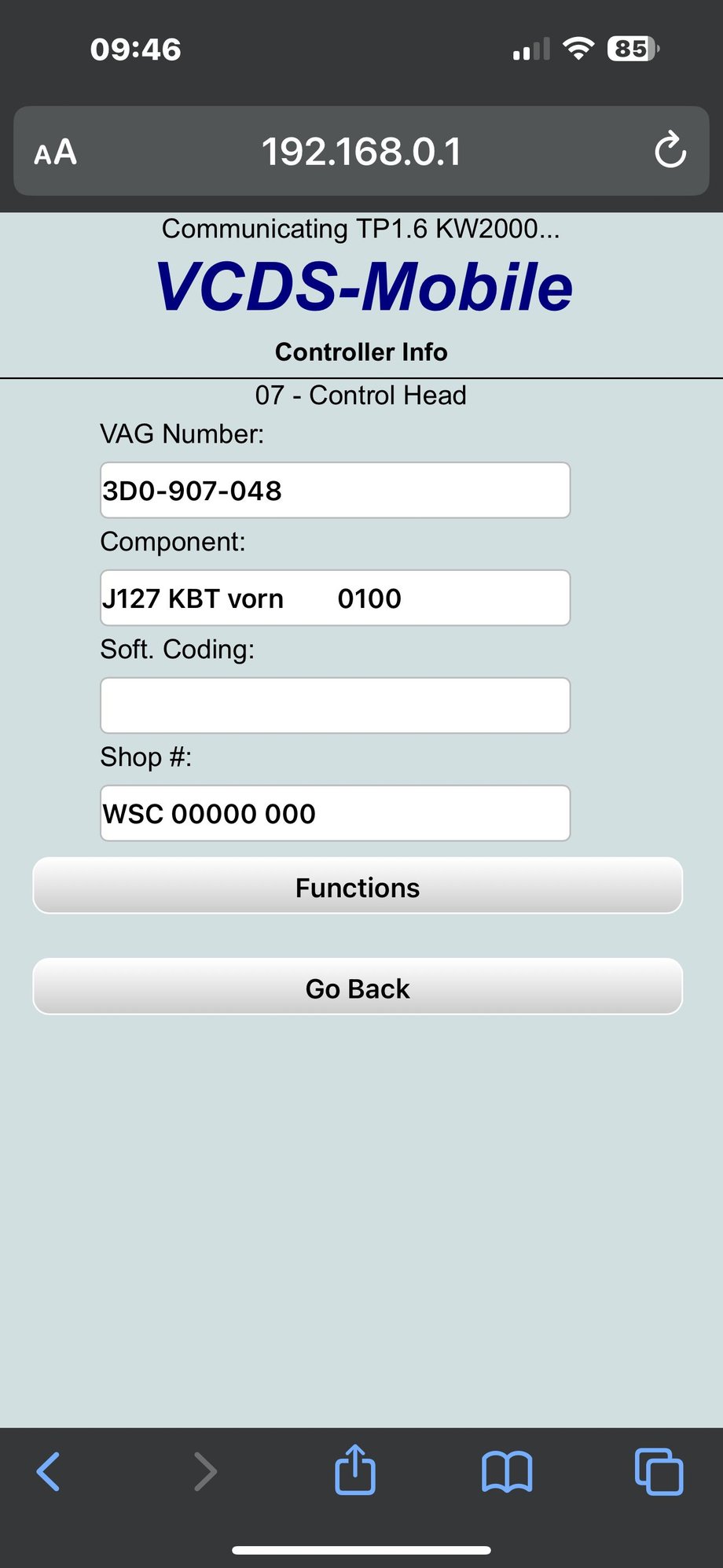

07:
08:

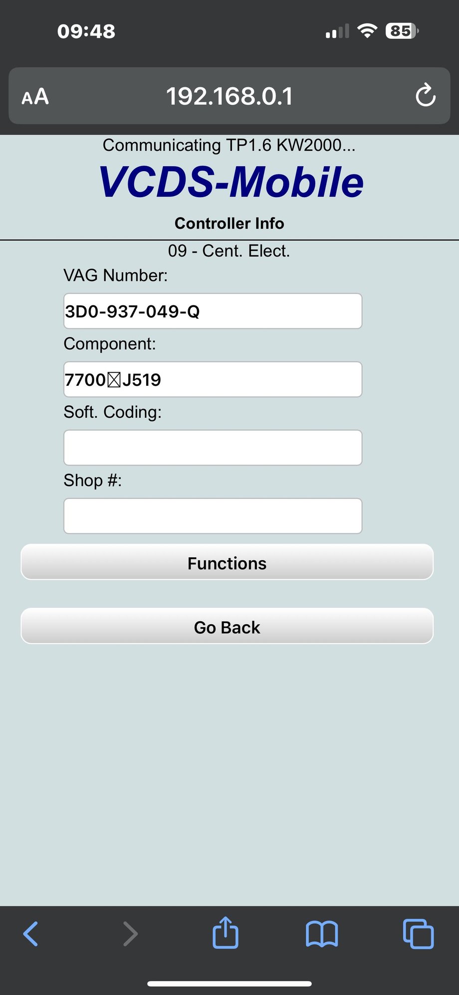

09:
More after lunch:-)

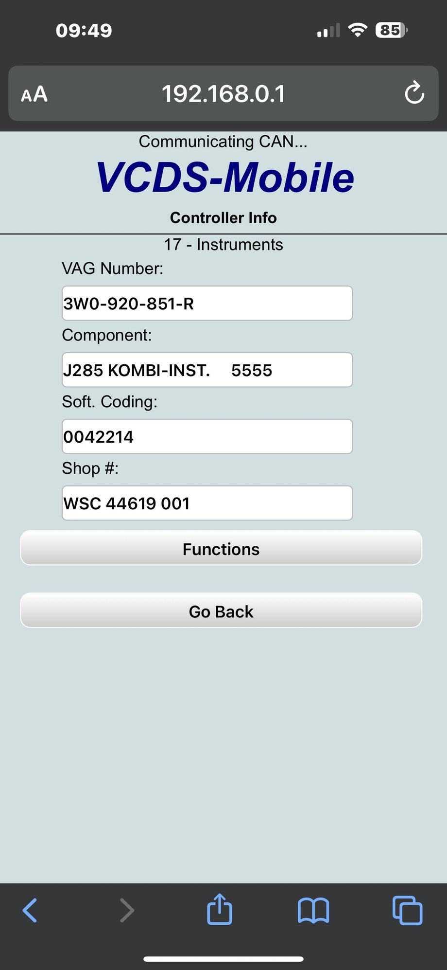

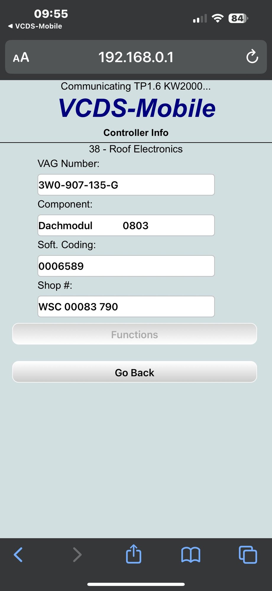

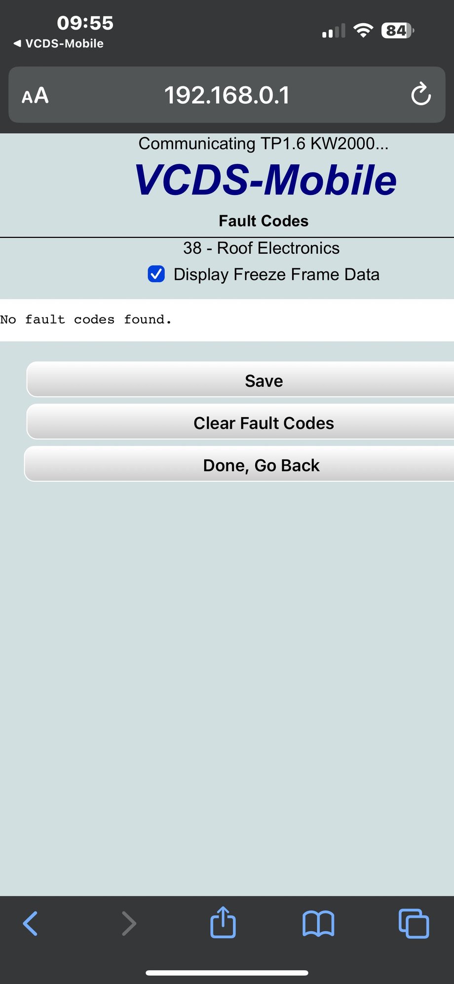

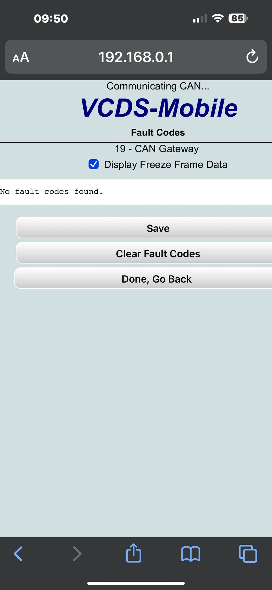

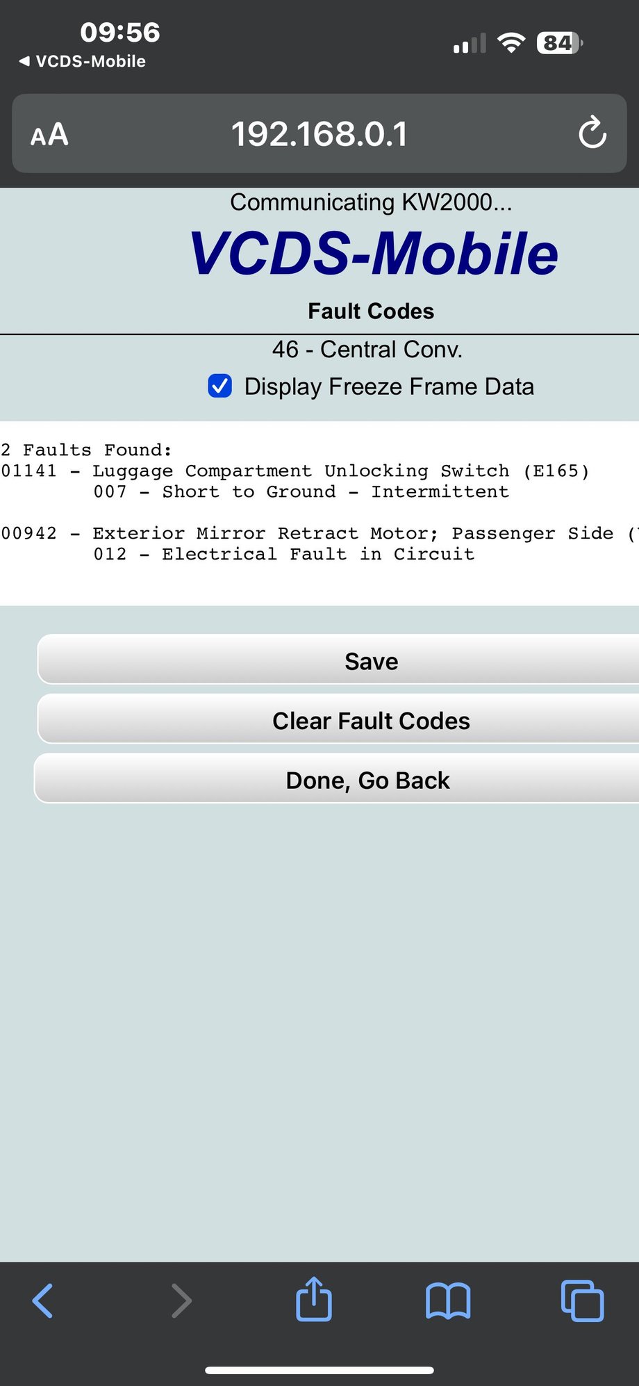

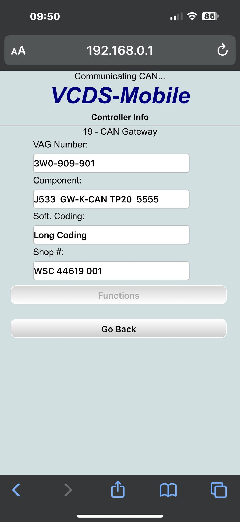

19:
38:
46:

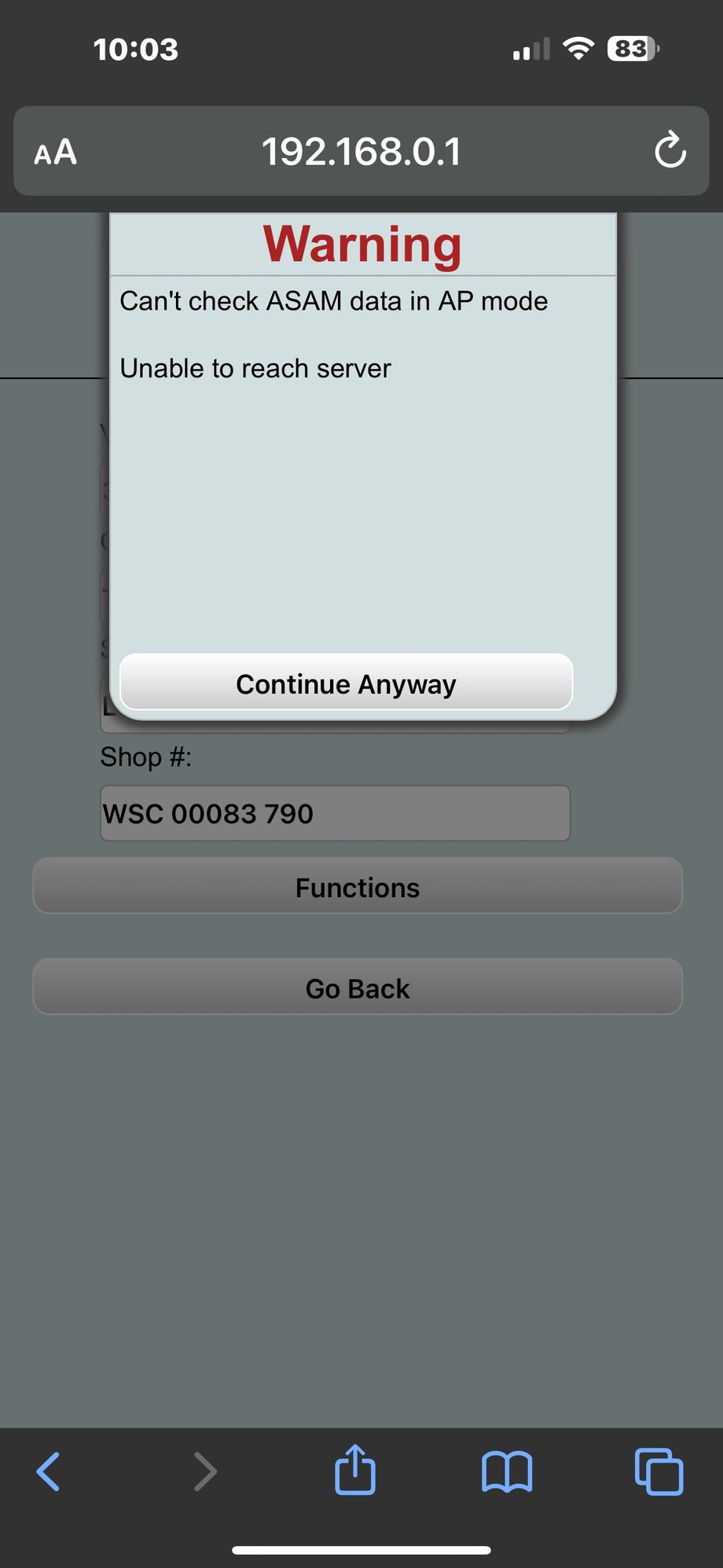

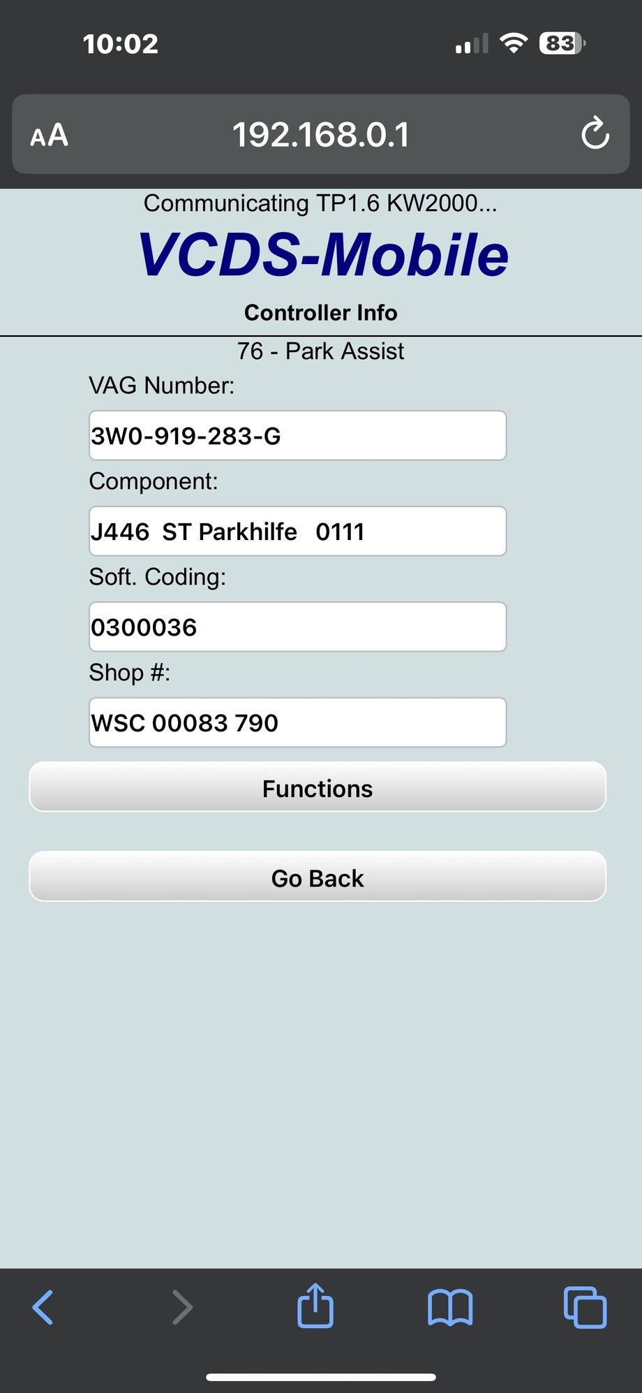

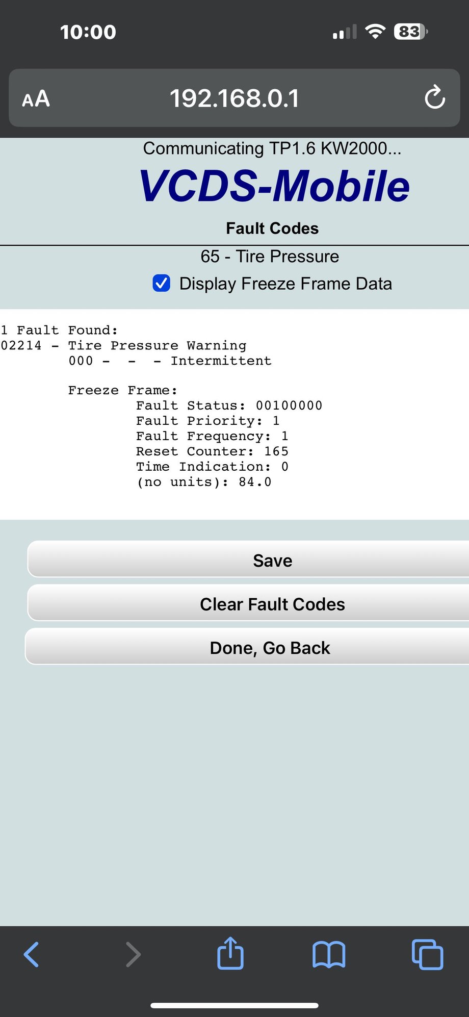

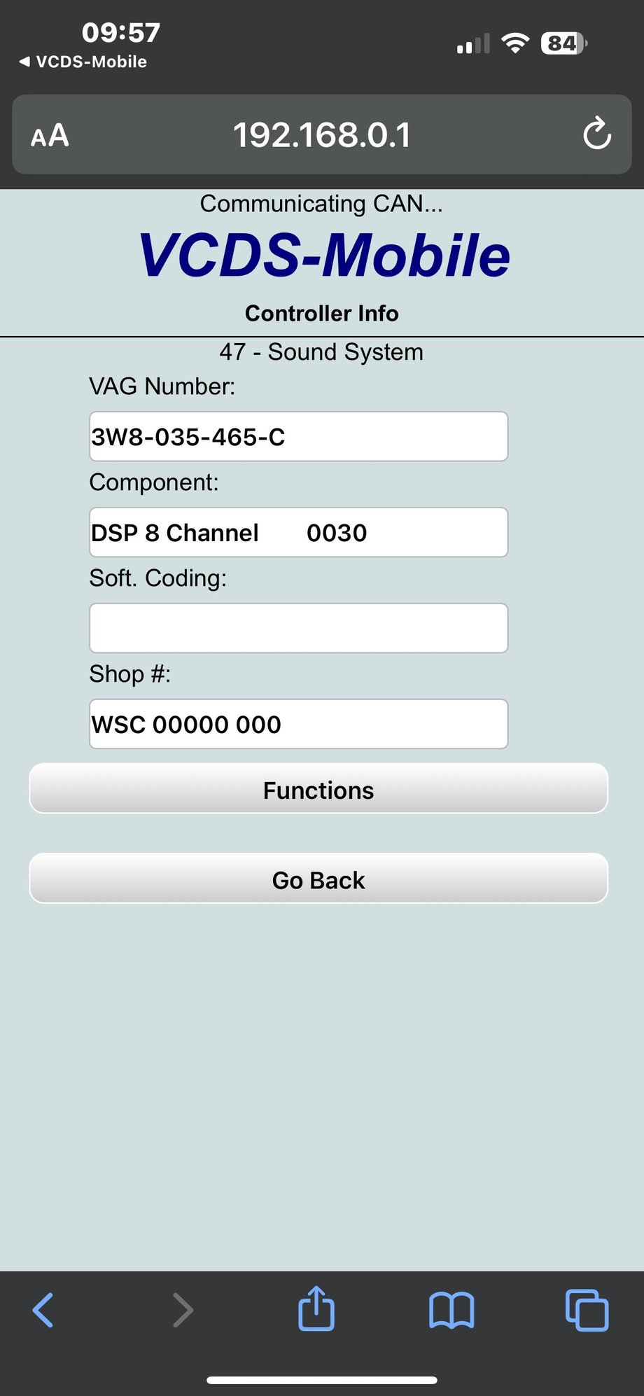

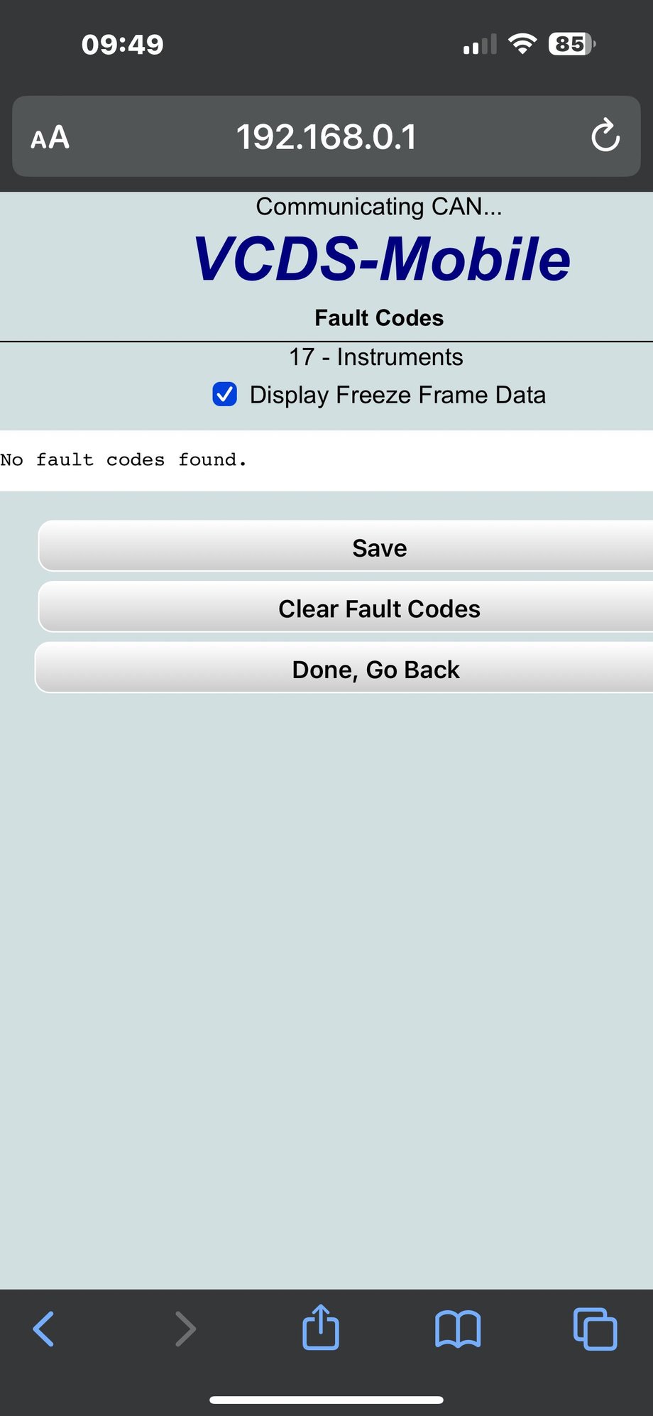

47 Only got Info screen, it failed repeatedly to display a fault or no fault code:
65:
76:
77 Missing the Info screen, I probably did not screenshhot it:
Warning, probably on 47:

Well...
Let me ask this so that we are all on the same page, when the unit was working for it's brief time frame, did the amplifier function properly giving sound without issue ?
Did you scan with the ignition on, off, or engine running ?
Being that you have the 3W8 035 465C amplifier, I think it not to be the issue, as it is the 8 channel amp, and not the problematic 15 channel NAIM for Bentley amp.
I think that the amp is being non responsive in the scan because the head unit is not fully turning on, and nothing else has faults that should interfere with the functionality of the head unit, I say nothing else should be interfering, but, and I will add, I have never had hands on you gen head unit, but I have worked on 2 or 3 for members here, and 1 guy locally here in Jersey, where all of them had the same issue of frozen screen at the logo, then rebooting over and over, or after so many reboots, the screen went blank, 1 was a lady that had 2 units with the same issue, her original went blank after so many loops, the replacement she purchased just kept rebooting at the logo, her's turned out to be on the replacement unit, it was for a model year newer, and being her one year older GT didn't have the SAT radio, and a different SW version, the unit didn't work, her original unit at some point, she had a rear camera video input placed on to the board inside the head unit, when the camera failed, along with the soldering points from the installer, the unit stuck at the logo and looped over and over, another member had a head unit whereas someone installed a audio video input into the head unit, but when the vehicle was sold at auction, this add-on was cut out, leaving the head unit to fail at the logo, the local man here in Jersey had the rebooting over and over at the logo, I went to his shop and swapped out the navigation disc drive and all was good, BUT, what I had him do first, as I did with all the other units, was to bench test the head unit itself, so I told him to pull the head unit first to test, as all these units failed when installed it the vehicle, but worked fine on the bench, that led to the replacement of the failing Navi drive for my local guy, and the removal of the add-on wiring/ribbon cable and video input for the lady, and the A/V + ribbon cable/module for the auction vehicle, he also had to remove some non usable items that were also somewhat cut out, but still had extra wires going into the head unit harness plug at the rear.
Sorry for the long explanation, but, I have seen where people swap out the head unit as they feel it must be the issue, I am not saying that it is not the issue, but before I would spend a dime on a head unit, I would bench test it, just need 12 volts +/-.
There is also a known issue with your Gen head unit, all the way from 2012, I have heard and read about the SW update for this issue, but some say that the Bentley dealership claims that they never heard of the issue, or know of a SW update, then just telling people that they need a new head unit, of 2 people I have spoke with (whats app) and here, both said the SW update fixed all, but then I never got a response when I asked for a detailed explanation of what the dealership did so I could inform others here, I will try him again now.
