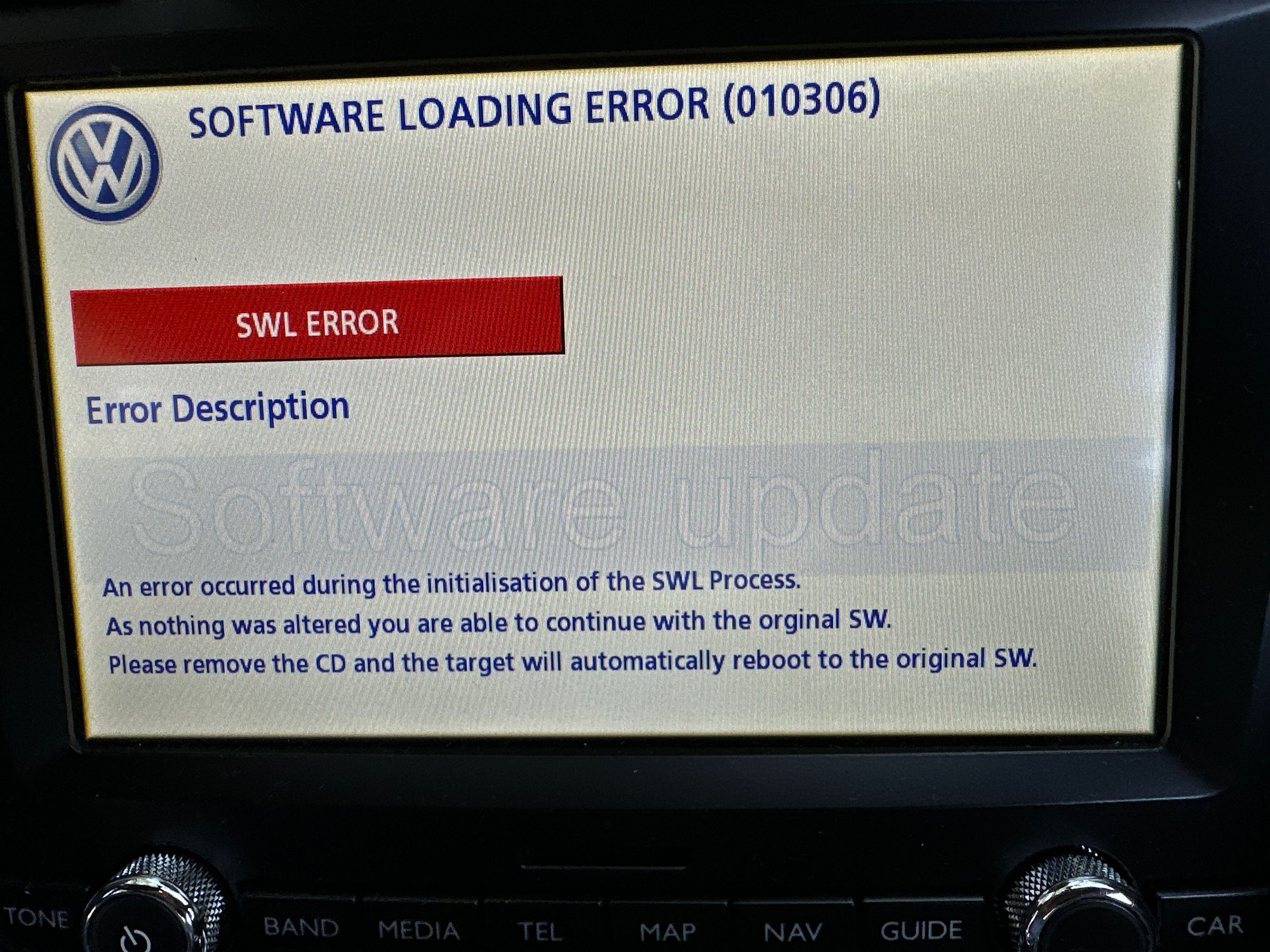

Originally Posted by robob
Hey Folks,
So no luck. Tried both discs many ways. On the SW update one, I get:
Anybody have another idea before I let a dealer take advantage of me?
Y'all take care,
Robert
@robob Do you still have that disc, I would love to try it on mine!

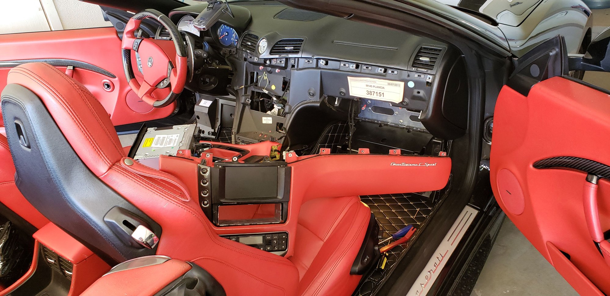

Ok, I'm going to do this. It's maddening - as somtimes it works for a few days at a time, and then not for a few days. It does SEEM that after I leave it on a tender for a day+ it has a higher chance of working.
Even crazier is how sometimes it boots up right away - other times it does not. One thing is for certain, it s a godsend that the unit is so easy to remove!
I had to pull apart my MAserati dash 3x, that is a HUGE pain. this is not so much. Can you help direct me to a proper 12v Power supply that you would recommend for bench testing?
