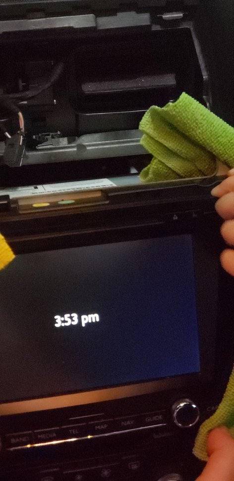

Crappy pic but this is as far as I can pull the radio out

Was able to pull it out a little more but still not enough to access behind the radio to unplug anything.

pull a little more. there is enough cable behind, sometimes it stuck a little bit.

Pull a little harder, while tilting up and down, hopefully you have it out already.

Not coming out as easy as it seems like it should be. Seems like the big plug on the back left side doesn't have much slack on the harness. Feels like I'm pulling too much but ill give it another go tomorrow. I keep walking away from it hoping something changes by the time I get back to it lol.

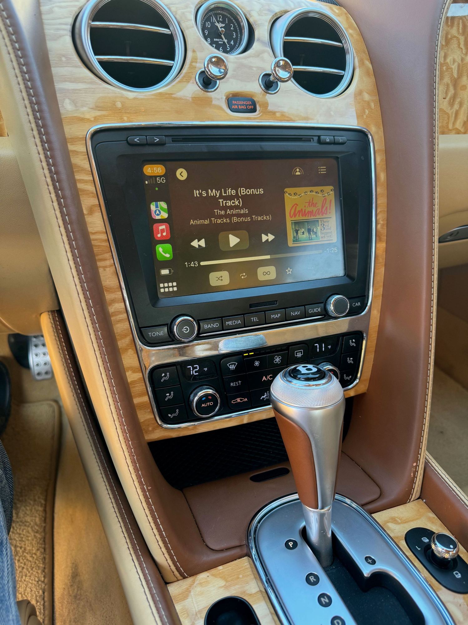

I have just added CarPlay to my 2013 Speed. The unit would not pull out as easily as the video either. As Johnny said - pull a bit harder. It will come out and there is enough cable slack. Mine eventually co-operated!

Mozart electronics and the fitting bay. The fitting bay didn't work at all. the screen would freeze up and just didn't work. I went back and forth with them for weeks. The mozart electronics one worked but the sound was horrible. The guy told me that it doesn't work well with android but it does with Apple car play. I gave up after those two.

Ok, so i got mine out finally. I wanted to share with the group how I did it.
#1 - I released the AC board controller.
#2 - I identified the coiled wires coming from the left power harness through a small crack. I used a screwdriver to gently pull the whole lot of wires rearward. It release the slack without putting direct pressure on the harness plug itself. After that it coudl pull out about 8-10 inches - enough to undo the clip from the bottom.
Now I can go make a video where it looks super easy to remove lol. Again, this was NOTHING compared to my masi...
