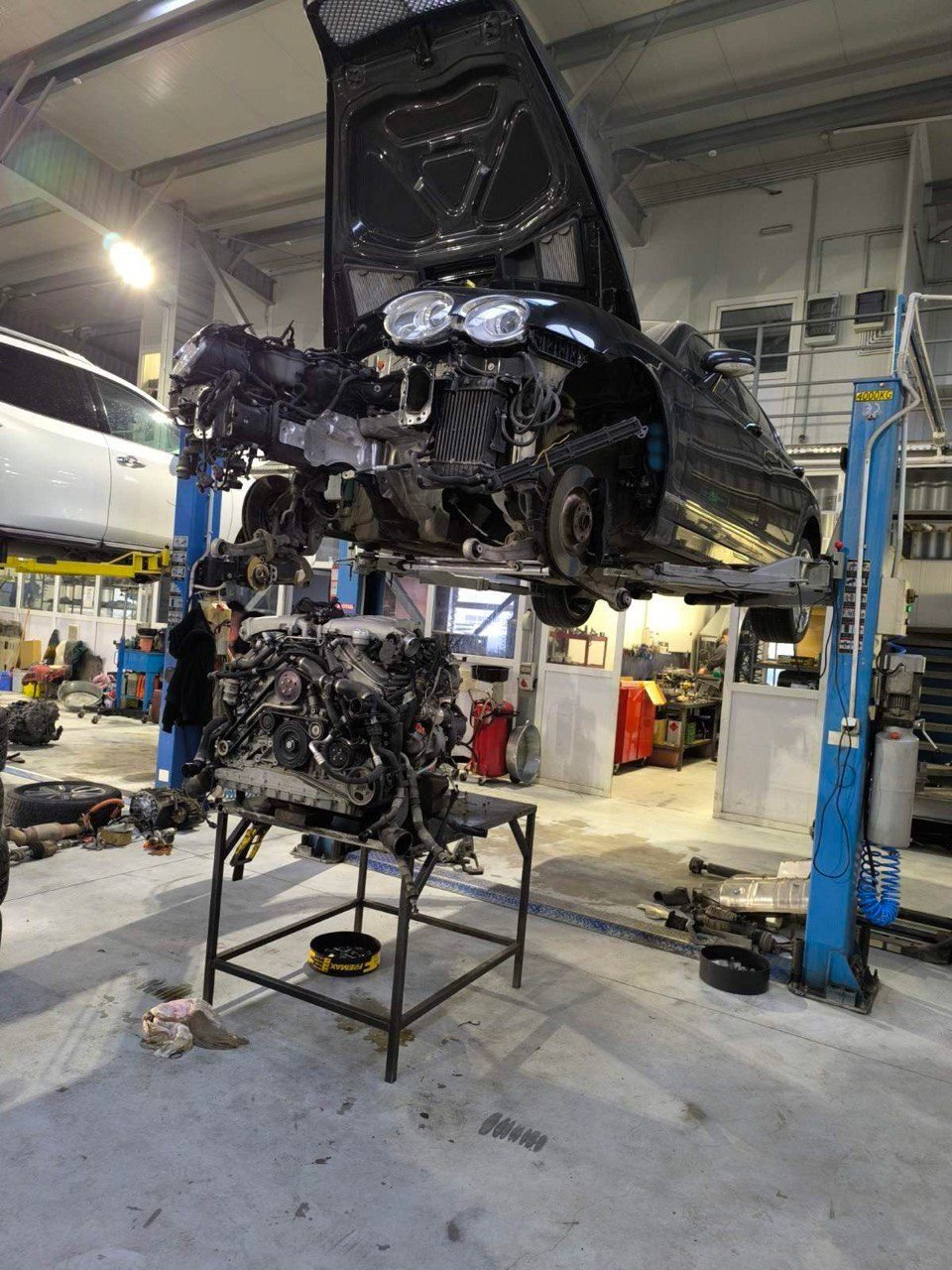

Yeah I was getting delayed shifts in 4, 5. It went from interesting to bad real fast. The transmission shop pulled it a couple days ago and pulled the box apart. Solenoids bad and now a few other things. I bought a lightly used (51k) gearbox instead of doing the full rebuild as the price was better. I'll probably get this rebuilt eventually. If anyone has any upgrade tips I'm all ears!
