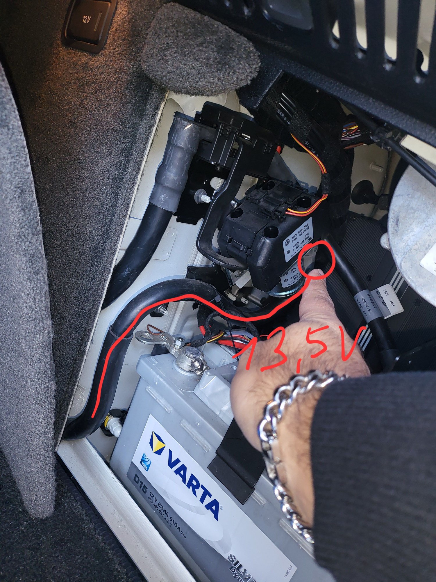

hen you check this for me, please check also this.
when engine runnig i have at the comfort battery ( All cables!) Around 13.5V
At the start battery and to the magneticswitch 15.2V ! After magneticswitch ( cable to the comfort battery) 13.5V.
Is this correct?

charging from alternator does not go directly on the starter battery - it goes thru dc/dc converter / transistor so the voltage is different.
