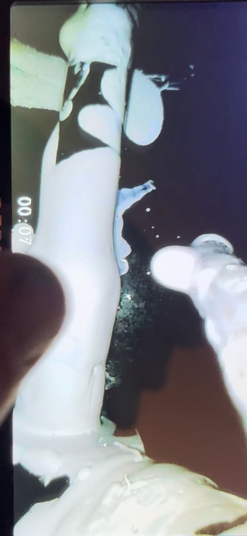

Good day all. I fixed my left sided vacuum leak with a camera a tube and flexseal about an 18 months
ago. I couldn’t find anybody that wouldn’t pull the engine to work on.
I’ve now developed “ small vacuum leak” for a few weeks Followed by “large vacuum leak” warning lights, and I can hear the vacuum pump cycling going up hills and other times.
The Brakes are great, and no sound of vacuum pump when I applying the brakes.
I did a smoke test of the right side. The smoke emerges only from my right side turbo intake horn. No smoke under the car or other places are that I can find.
Ideas? Seems odd to me. Perhaps bad diaphragm??
