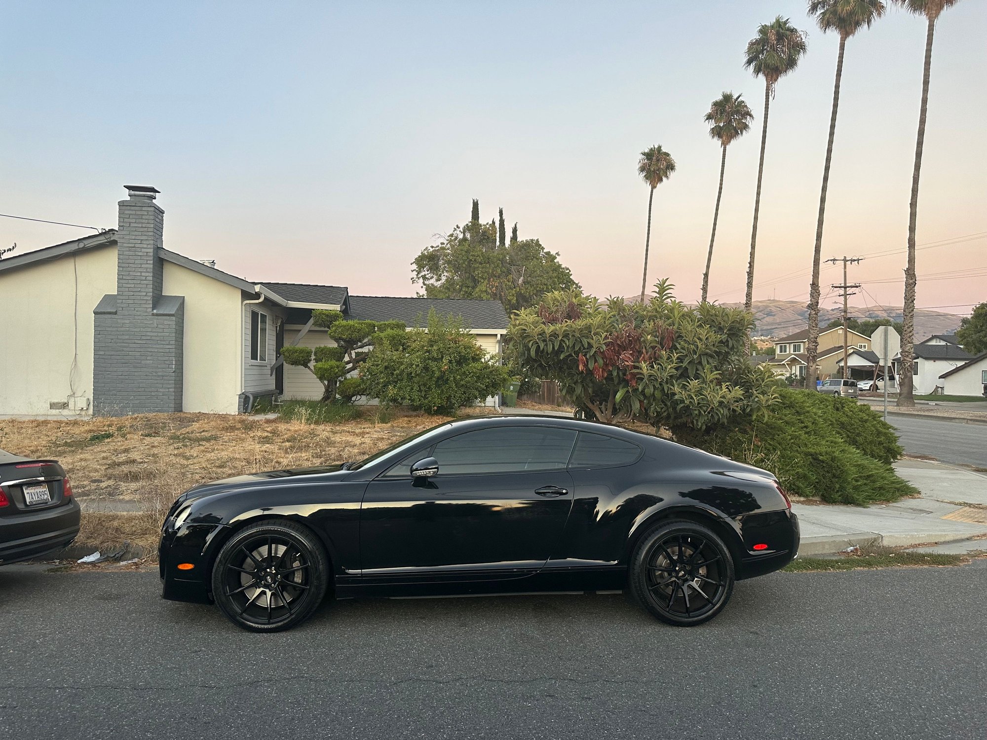

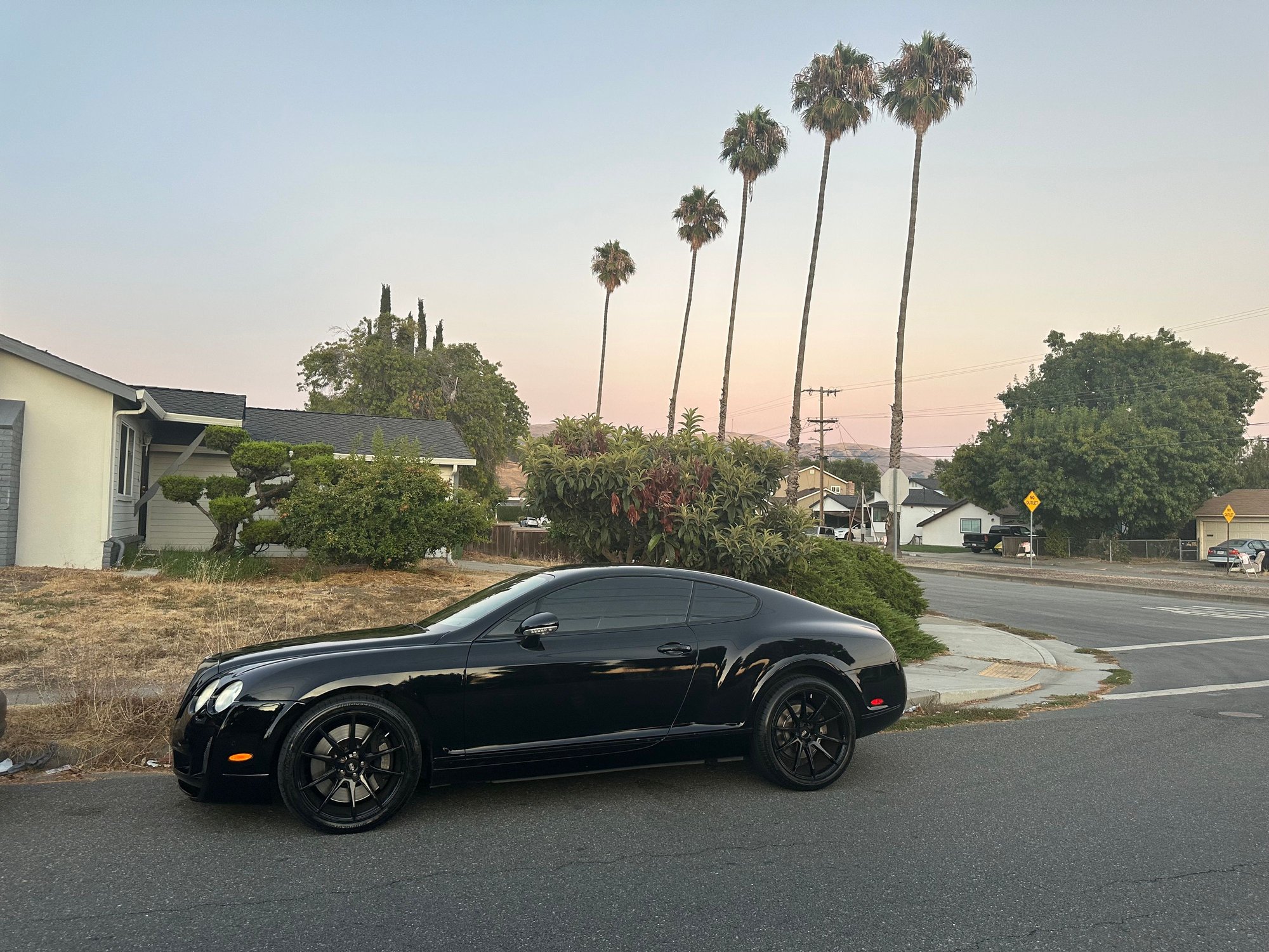

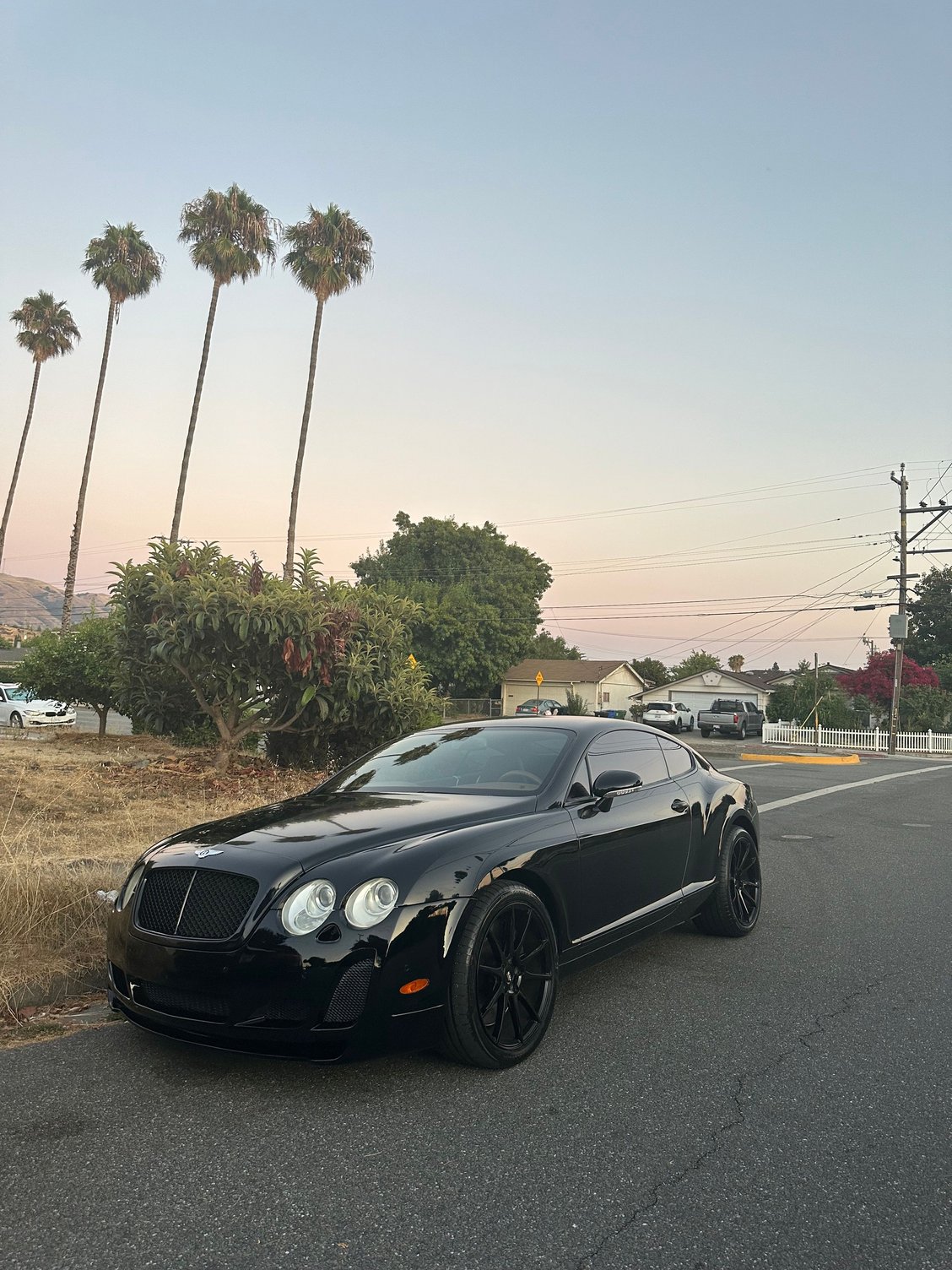

I have some after market 20 inch wheels, I went thru a lot of tires in the front. First I had 255 30 20s and they kept popping from potholes or having 4 people in my car lol. Then I had 255 35 20s never had an issue had them till they wore out. This time around I put 255 40 20s and the car just feels heavier for some reason. The ride is smoother tho. I would say the 255 35s were the best overall fit for me. This is the car with the 255 40 20s right now
