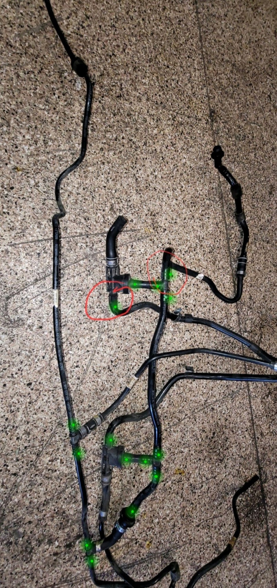

The lines were re-routed in mid 2006. I have a late 2006 and looked into this before buying. There is an easy check by looking at the engine under the cover that runs across the rear of the engine. I think it is the B cover. If there is a small box under the cover then the car has the redesigned vacuum system. I read once what the box is but I have forgotten. I am not sure about the change in material. Most of the cracks happen where the tubing is stretched over barb on a connector. The issue was that the lines ran above the transmission and were subjected to high heat causing the tube to become brittle.

Hello @newporsche ,
As you know, the early GT's had the vacuum lines over the transmission, they were rerouted for the 2006 GT, but, this area was not the only issue with the lines, the lines at the firewall along the steering rack also had issues, as did the lines up to the rear of the intake manifold, these same issues are still present on the second generation, it's the same material used, has the same line over barbed connectors, they still split, maybe just not as often, as some areas are covered with heat wrap foil.
I can double check with Jason as to the exact year of the lines pictured, the 2 areas circled in red had split open, I added to 15 green dots to show the 15 areas for failure.
So, the 2009 still has all the areas along the firewall steering rack area, along with the rear of the engine at the rear of the intake manifold, and in both wheel wells, especially running to the vacuum pump in the driver's (LHD) wheel well.
Photos by Jason Giannetti / @Bentley Tech NC .

Hey all just an update that I'm close to deal on a 2009 Continental, I'll have a smoke test done to see if any issue with the vacuum lines but I guess those could go at any time? At least it's past 2006 so maybe not too too bad for labor costs

Thanks for the detailed info, the car has 40000 miles and no record of vacuum lines replaced, do you think the 2009 models are less prone to the cracking if they perhaps used more protection in problem areas?
Originally Posted by Johnny Hotspur GT
Hello @newporsche ,
Johnny
