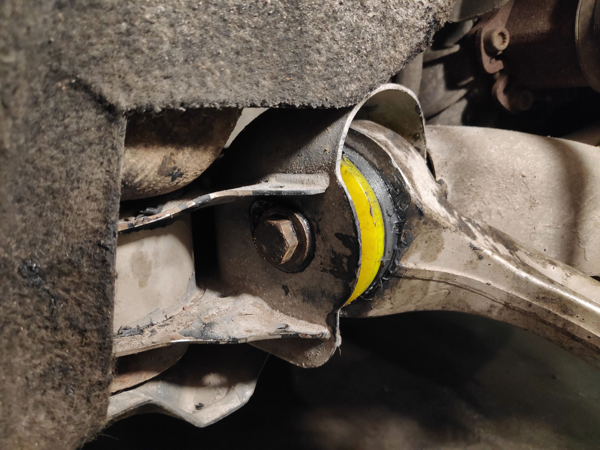

The bushing has now been replaced. While we were at it we replaced both sides. When one is toast the other one will most likely fail soon.
This is what we started with. The remains of the bushing could be pushed out with a thumb.
The new Strongflex 90 shore polyurethane bushing installed, waiting for the collar. It was a breeze with a hydraulic press and lots of PU-compatible MoS2 grease.
And finally the control arm back in place. It took a bit longer than we thought but essentially it was one evening's job.
Test drive went great. No vibration whatsoever, not even under braking so the suspected brake issue weren't warped rotors. All we need to do now is to take it to a four-wheel alignment just to make sure everything is allright.
I didn't really push it during the test drive and these are just one of four each side but I have to say the car already felt sharper than it has ever been. I'll look into replacing all of them later on, this seems like a worthwhile upgrade.

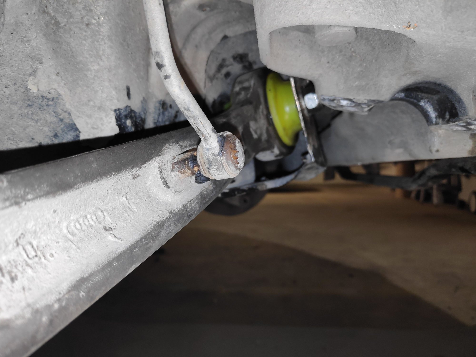

PROBLEM SOLVED. Even though the front rear LCA bushings seemed to be OK they weren't. We popped them out today and replaced with Strongflex 90 shore PU sport bushings. Getting the old ones out wasn't easy, my 15-ton hydraulic press was struggling with the task and only after hosing them with penetrating oil and tapping them gently they yielded.
The car is rock solid, no vibration at any speed (I only got it to 75mph on a short test drive) or during braking. As a plus, the steering feels sharp and planted with no noticeable increase in NVH. Highly recommended, either as a repair or an upgrade. The downside is that the old bushings had flexed so much that the toe was way off at speed and the insides of both front tires wore out in less than 300 miles. One tire blew on the highway last week and now I'm on winter tires as a quick and dirty solution, to keep the car on the road until I get all four summer tires replaced while I'm at it.
