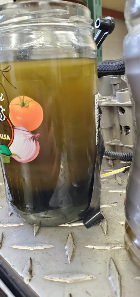

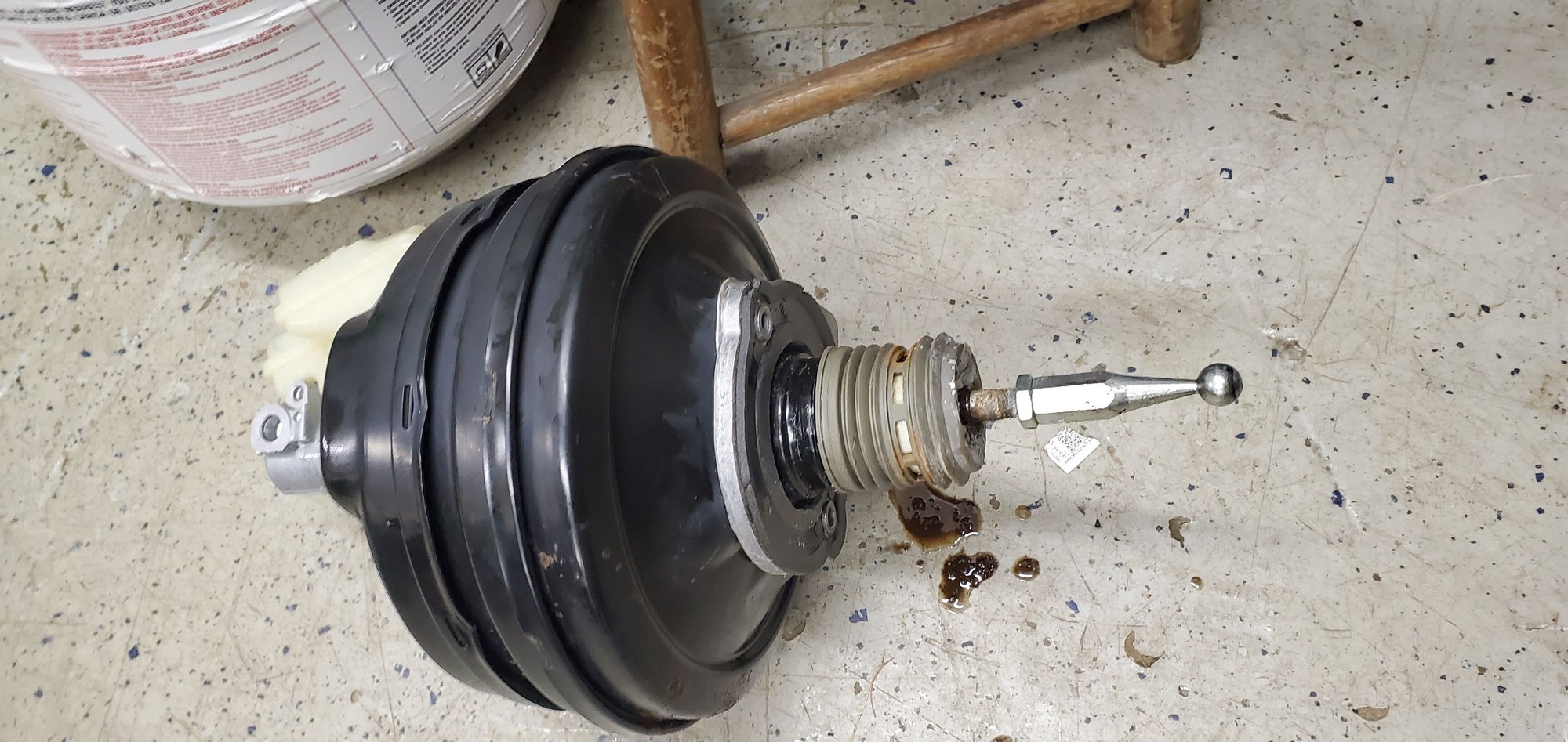

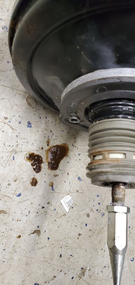

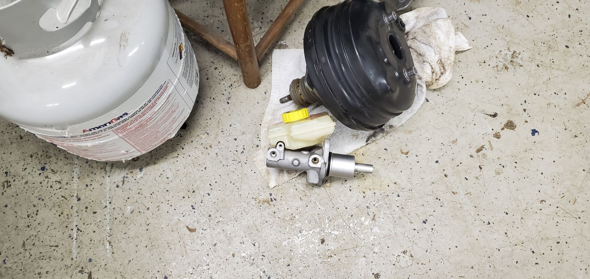

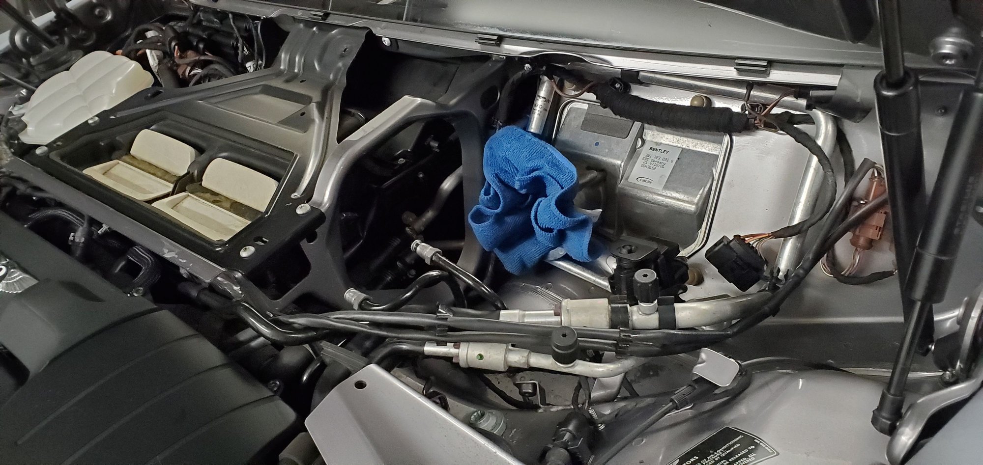

I believe it is either a leak in the vacuum lines from the engine or the vacuum pump that supplies vacuum to the brake booster for proper operation that have a leak, or, it can be the brake booster itself, my brake booster actually started leaking during my rebuild shortly after installing the engine transmission package, I bled the brakes and all seemed somewhat fine, but the pedal was still a little soft to my feel, the pedal also went a little far for my liking, especially with all new pads and rotors, but being it was in the shop with the exhaust not fully installed, I didn't hear the vacuum leak until I installed the full exhaust and pulled it outside, I could hear a slight hiss from under the dash, the next thing I knew, I had brake fluid dripping down onto carpet, I also found a slight amount of brake fluid dripping from the bottom of the brake booster at the cowl area, eventhough the reservoir didn't show any decent amount of loss, as I stopped pressing the pedal the second I saw it drip in the interior, and made a video of it, but I then put towels on the carpet so I could make the video showing the leak outside at the booster, in the booster video, you can hear the fluid inside it, so, the bad seal in the master cylinder allowed brake fluid to eat at the booster diaphragm, therefore causing a vacuum leak, along with itself dripping fluid.

You say that you replaced the brake booster, but did you replace the master cylinder as I showed in my pictures in my previous response ?
As the soft pedal and or any brake fluid leakage through the booster into the interior, that is caused by the master cylinder internal seals failing, which then allows the fluid to leak into the booster, then the interior onto the carpet, did you determine the stain on your carpet to be brake fluid ?
Also, a failed master cylinder causes a soft pedal, as the failed internal seals allow blow-by of the fluid instead of building pressure to the lines, abs module, then onto each caliper.
