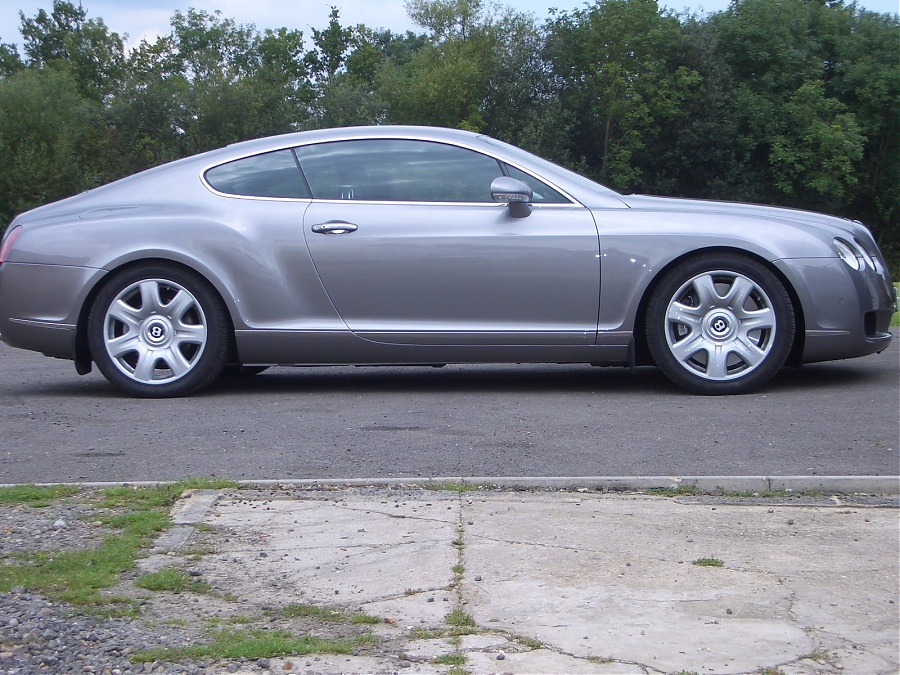

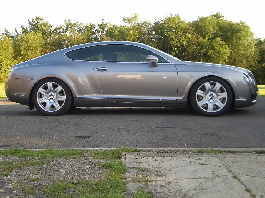

Upon your recommendation I got my links - although the Two Day UPS service actually took 7!! And yes, the concept and application is dead simple and inexpensive. If you only want to lower your car a little, why bugger around with a $2k electronic package that no one seems to know how to install?
The pictures below show 1st attempt (2 1/4" drop - too low) and final height choice (1 1/2" drop).
A couple of things came to mind while I was doing the job. Unless you have a supremely flat and level floor car-sized piece of floor from which to take your dimensions (extremely rare) you have to trust that Bentley got all four corners at the correct height in the first place. My wheel arches at factory-height averaged out at around 28 7/8". I measured the factory links and set the new ones all 12mm shorter (sorry for mixing up units- it's an age thing). This gave the height in the first picture. Just reaching under the car, popping off the lower ball joints and winding them in two turns raised it to the height in the second picture.
I've noticed no difference in handling and comfort although my poor old back creaks a little more getting in and out!!
The result - a transformation.
BTW you may notice the Bentley Mud Flaps installed on the car. The lane where I live is barely wider than my car so mud and crap from the verges is regularly distributed up the wings and doors. The mud flaps help.
