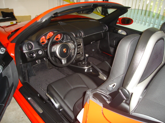

Red guages look great and I got them when I ordered my '08 987S albeit they were not cheap.
