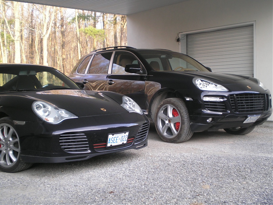

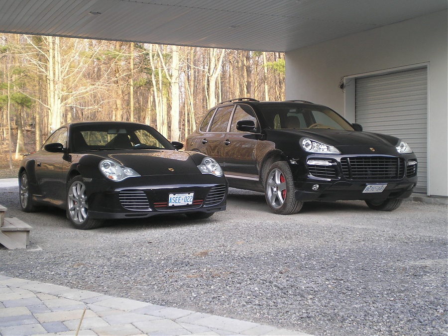

jace - you saw what i did on my GTS - this was exactly what i did with my turbo -
the picture you described sure sounds like some of the ones i posted of my Turbo and my 911.

jace - there was a guy on rennlist who had something like what you are talking about but it was the 1st run turbo.
i was trying to post the wiinter pic but the site is having problems.
in Ontario this imo is legal. the Vehicle Act states only that it must be conspicious and not blocked by a small list of items. i carry a copy of the Act in the glove box! it is much easier to make out in person and i think is clearer than all these ones that cover their plates with plastic. i keep it clean as well so i would in the politest fashion suggest to a cop that they go after the plates they can't be discerned in spite of their position.
i just pumped it into the valance; not too delicate but it really looks good.

take plate bracket from a version one Turbo and turn it upsidedown. i took the upper notches of the bracket and set them along the cut line of the lower valance ie the unpainted part in the normal turbo front. the lower part of the bracket has tabs out the back that are about 3 inches or 7 or so cm long. they just push against the lower valance as a brace. i then just drilled the thing into the lower valance. the Porsche dealer thought it was nuts and i am sure lots of people will call it brutish, but face it imo the option is a giant plate in the middle of my grill.
so to start, i suggest hitting your dealer and scrounge up an 06 or earlier turbo bracket.
