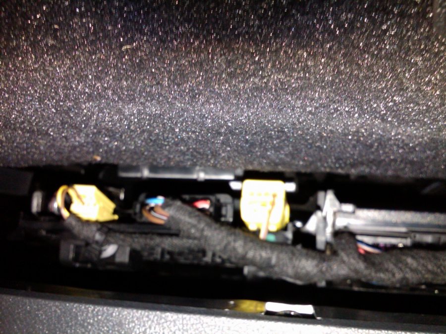

There is 2 yellow pin clips, I guess you dont unplug these its the yellow wire?
I heard if you unplug the yellow clip it will put a fault on your airbag.... any know this?
Thanks for your help!

This is under my GTS 09 seat with out the cd player... I still have not figured out which wire it is..
Maybe this picture will help others?
thanks for all your work alpine...
do you have a donation fund
Too close I can't see anything I AM BLIND!!
You have NAVI right? Passenger seat?
Mine is a black plug with three wires. They are brown/yellow stripe. Just pull it(yellow plug I see in picture). Lower your car to loading and then pull the plug. The ! light should come on a chassis fault might come on but your instrument cluster should be showing you the level settings of your car and it won't let you change to menu or anything.

This is weird, yours must be a 2008?
From left to right this is what is under my 2009 seat:
Black plug with many cables coming out of it, this has to be the power seat... it wont un plug
Yellow plastic plug with brown and yellow cables (unplug it and it turned my airbag light on
Then another yellow plastic plug with a few wires coming out I think they are yellow and brown as well..
has noone else tried this yet??
