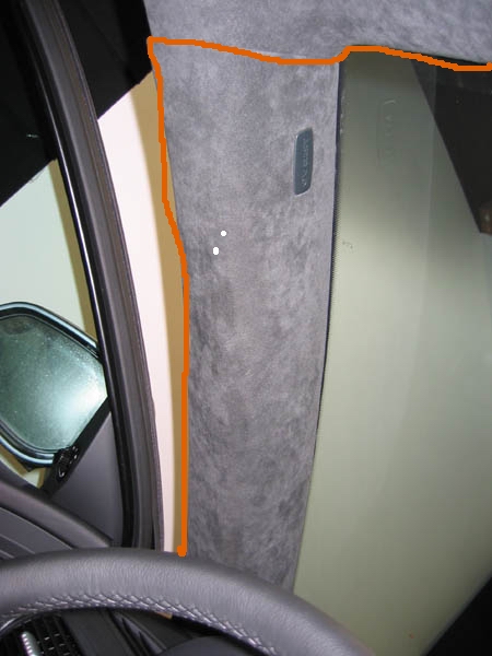

I just hardwired my V1
Mounted under mirror ,then ran wire along top of windshield . At the pillar tuck it into top of "airbag trim" around to rubber doorseal ,Then down under seal and can go right into fuse box on drivers side. The hard wire that comes with V1 has an end with a male connector covered with blue plastic . trim off the plastic and push it into fuse location # 48 (switched)in the bottom ( you can look and see that the bottom spot has metal clips ,The top doesn't. this should make sense when you look ) The ground can be attached to any screw attached to metal. If you have the concealed display you can run that wire from inside the fuse box to the steering column so that it comes out on top of column. I attached with supplied velcro right to column. It works great.
