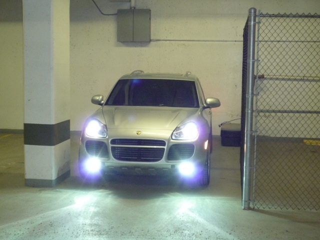

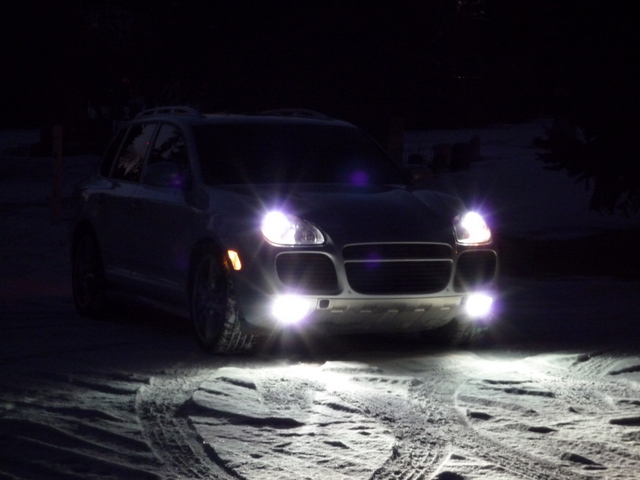

Talking pictures
Old Feb 28, 2009 | 02:53 PM
christx997's Avatar
Joined: May 2007
Posts: 482
From: TX
Rep Power: 39
christx997 is infamous around these parts
Originally Posted by mattjtaylor50
wow those look sweet! might have to get some now.
