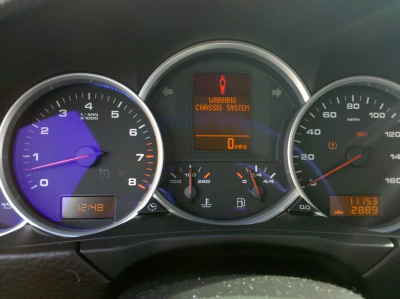

Twice in as many weeks, I received this message while driving - WARNING CHASSIS SYSTEM
The car leans like a ****ing tanker and the sport button is disabled.

Stop the car, shut off, restart, everything is fine. Guess I'll be calling the dealer this afternoon.

Took the car to Rockville Porsche here in MD. Haven't picked it up yet, but they called and told me the error was due to a stone lodged in the pins of one of the connectors. Problem solved.
There were 2 recalls, one related to airbags and the other PDCC. I'll post up the campaigns when I get the car back.

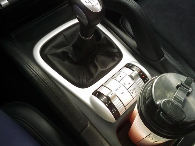

why does your GTS have a leather boot? i thought the full leather came with alcantera shifter and boot?

My GTS doesn't have full leather.

ive never seen one with a stick either, cool.

gotta chime in with the sweet stick also cool!
begs the question, how is the tranny/shifting feel? smooth like buttah? clutch stiff or daily driver friendly?
