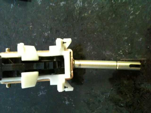

So I took apart the center consol, and found the issue. On the pic you'll notice the brass (maybe not brass) shifter arm is bent. When it bent it broke the plastic plunger inside of it which attaches the safety switch to the release button on the shift ****. Now to find the full plastic piece and brass lever.

Well it looks like your on the right track now, at least you know where the issue is. Did she have her hand on the shifter when she went in?

My shifter failed as well, but couldn't find the individual parts; believe it or not, they're not the pricey. I paid around $250 for the entire shifter unit (not including the circuit board which sits above).
