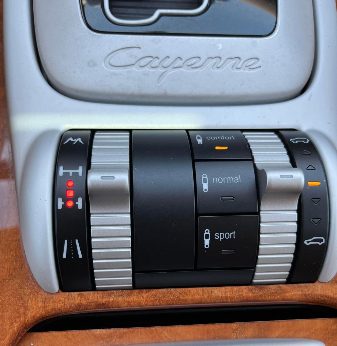

2005 Porsche Cayenne S - Differential locks
I am looking at a 2005 Cayenne S that doesn’t seem to have either sport or off-road mode button, but the rear diff lock light does light up, however, the picture on the dash doesn’t show the third diff colored in. These Cayenne models and options are confusing. Does this mean that I have the rear locking diff but not the automatically disengaging sway bars? What does that mean for my offroading dreams?
