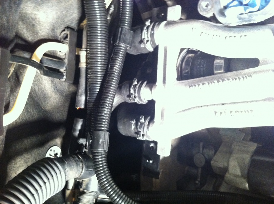

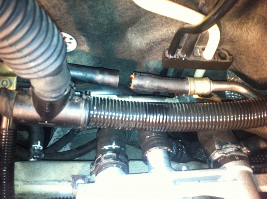

I have been working on my cayenne turbo 04 upgrading the coolant pipes, it seems impossible to change the T pipe behind the head, how important is it? my car has 54,000, but now that I was putting everything back together i saw a what it looks to be 2 hoses connected with a plastic piece on that is broken, its on top of the back part of the upgraded aluminum pipes, here are the pictures, i don't know if its vacuum or coolant, I need some help on this one, thanks

The broken part is a vent line - bleeding - crankcase - part # 948 107 215 52
You can do a part search on "autoatlanta" to see the actual part. It is a long hard black tube connected to a more flexible tube shaped like an old English L, start from the T, braced to left side on top of injectors with the more flexible part across to the right side. When you get the new part a new clear T will come with it. You will find that it is not possible to connect the new part to the old tubes, not enough space (with the broken orange colored T inside). What I did was cut about 1/2 - 3/4 inch on the old tube on both side, make sure you take all the broken orange T out, put some lube and wiggle the new T in. I used small stainless clamp on both ends. I got the part from suncoast, cheaper than dealer and both my local dealers didn’t even have it in stock. You may want to make sure all your vent lines, vacuum lines are good before ordering the part. A few of my vent lines cracks because they were so brittle.
