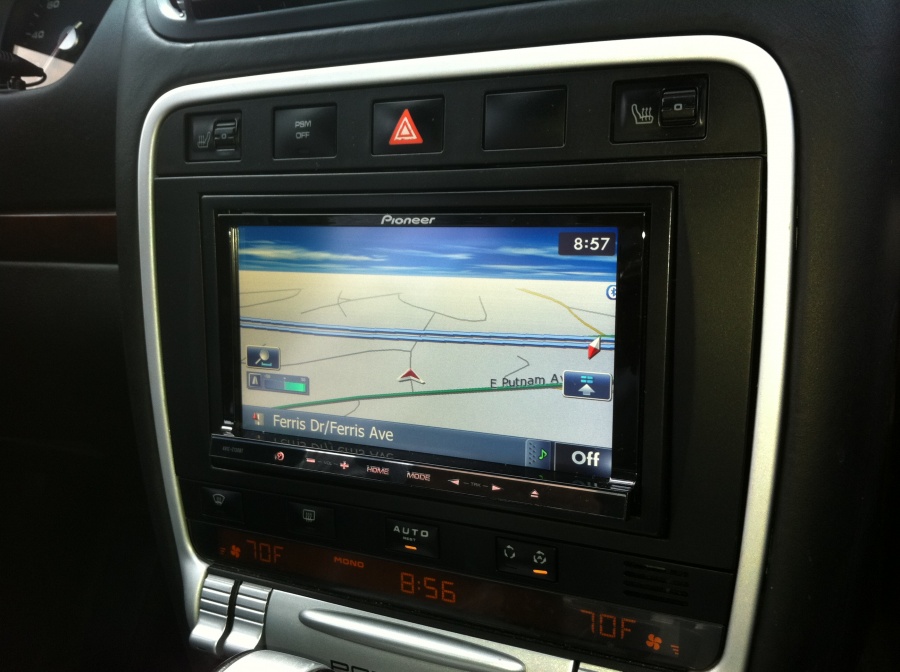

My radio is in and everything works... YES, even the steering wheel controls!
Because everywhere you read you get a different story, I figured I'd break down exactly how to accomplish this.
What you need:
1) Pioneer AVIC-Z130BT ($850-$1000)
2) iPod cable ($40)
3) NAV-TV Bose amp module ($500 if ordered through a retailer)
4) Metra Axxess ASWC Steering Wheel Control Interface (http://cgi.ebay.com/ws/eBayISAPI.dll?ViewItem&item=130556969625&ssPageNam e=STRK:MESE:IT)
5) ACP Dash kit - ($150 on eBay) (http://cgi.ebay.com/ebaymotors/Porsc...d=253575449678)
6) MOST IMPORTANTLY!: An audio shop that KNOWS what they're doing and that will go the extra mile of calling NAV-TV during the install to insure that there are no bugs whatsoever.
I spoke to many shops before picking my installer. If you live around Fairfield County, I'd highly suggest King Car Audio in Norwalk, CT. It's a father and son operation that has been at the same location for almost 15 years. To be honest, the shop looks a little run down, but their solid reputation and the amount of know-how that came out of Mo's mouth made the choice easy.
THAT'S IT! This is all you need to get it done. Anyone that tells you that you absolutely need to change the amp, buy fiber optics, rewire speakers, yada yada is just trying to up-sell you. The system sounds great, there are no glitches and I'm ecstatic to finally get rid of the POS OEM radio.
Here are a few pictures. This dash kit looks miles better than the one advertised for $300+

Do you have fader control? Base control? with this module?

How is the sound quality with the OEM speakers? I've been considering totally replacing the system in our Cayenne, including the speakers. However, I may keep the speakers in place if the aftermarket head unit works well with them.

Thanks for the info. I was looking at this but was scared away by all the MOST bus stories! Good to know that it is possible with the stock amp after all!
Did you lose the ability to display audio track info, phone info, and Navigation prompts in the instrument cluster display?

You are pushing closer and close to facing whether I can live with the existing one a little longer or not. So if your upgrade pushed over $2k, can you recoup any of the cost by selling the old unit? A little pricey for a decent NAV and stereo... but cheaper than an '11 CTT I suppose.
I assume the instrument panel display is lost with this upgrade.

Are you able to maintain all steering wheel controls (volume, track skip, mute, and most importantly, answer and end calls)?

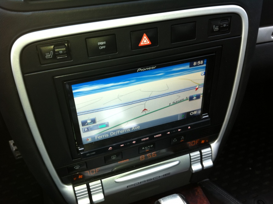

Curious to know who did your face plate?
I have an Alpine X008 and my authorized very experienced Alpine dealer did a crappy custom job.
