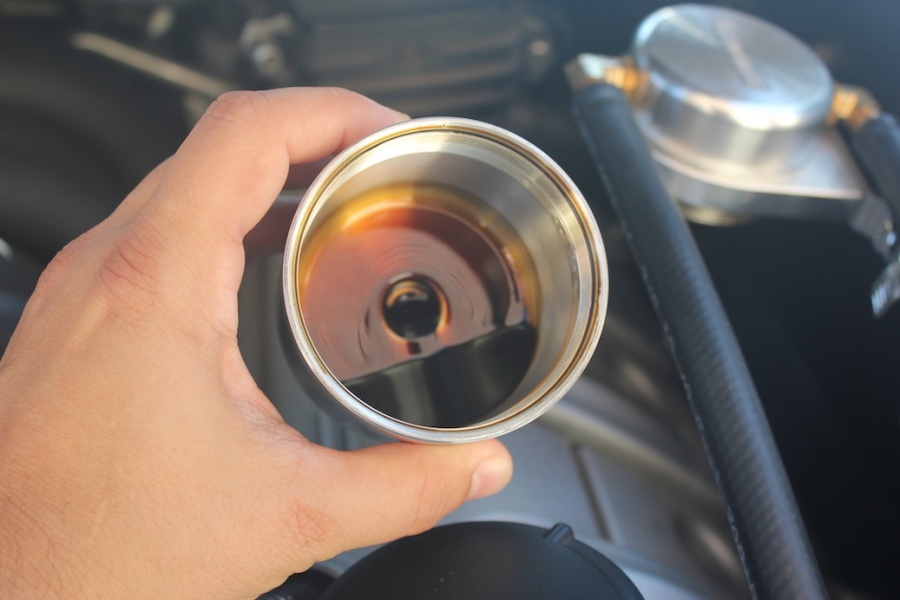

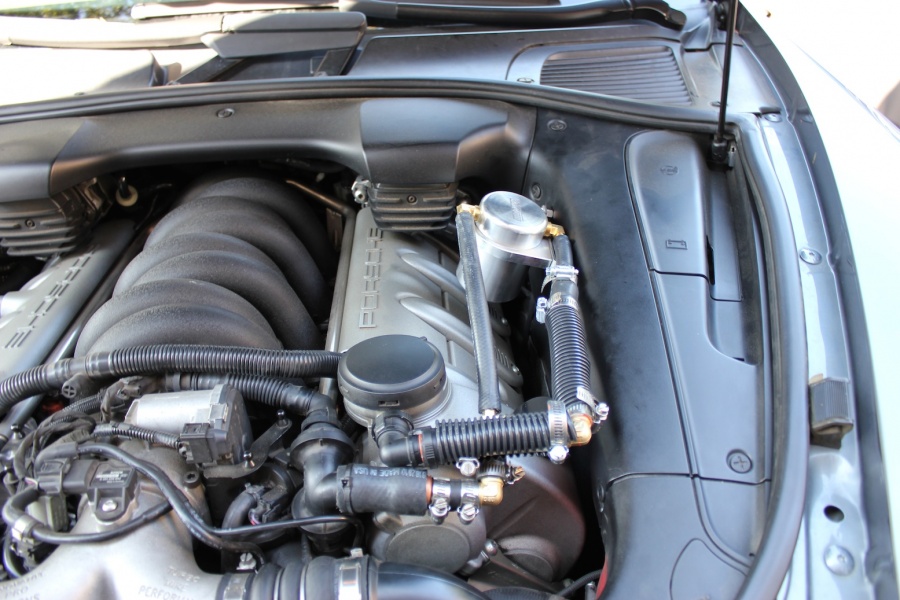

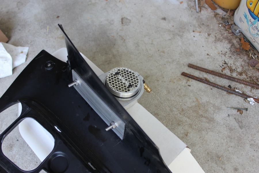

I've had this in for several weeks to see if it would catch anything. If you've ever popped the driver's side inlet hose off the turbo you've probably had oil come spilling out of it. I decided to give this a try and see what happens. Bear with the install pics as it was done as cheaply as possible - I plan on bending some tubing and getting better fittings soon. The oil captured is roughly 900 miles worth of driving. It amounts to about 3 teaspoons along with whatever it took to 'wet' the system, but at least I know it's not getting dumped back into the intake tract.
